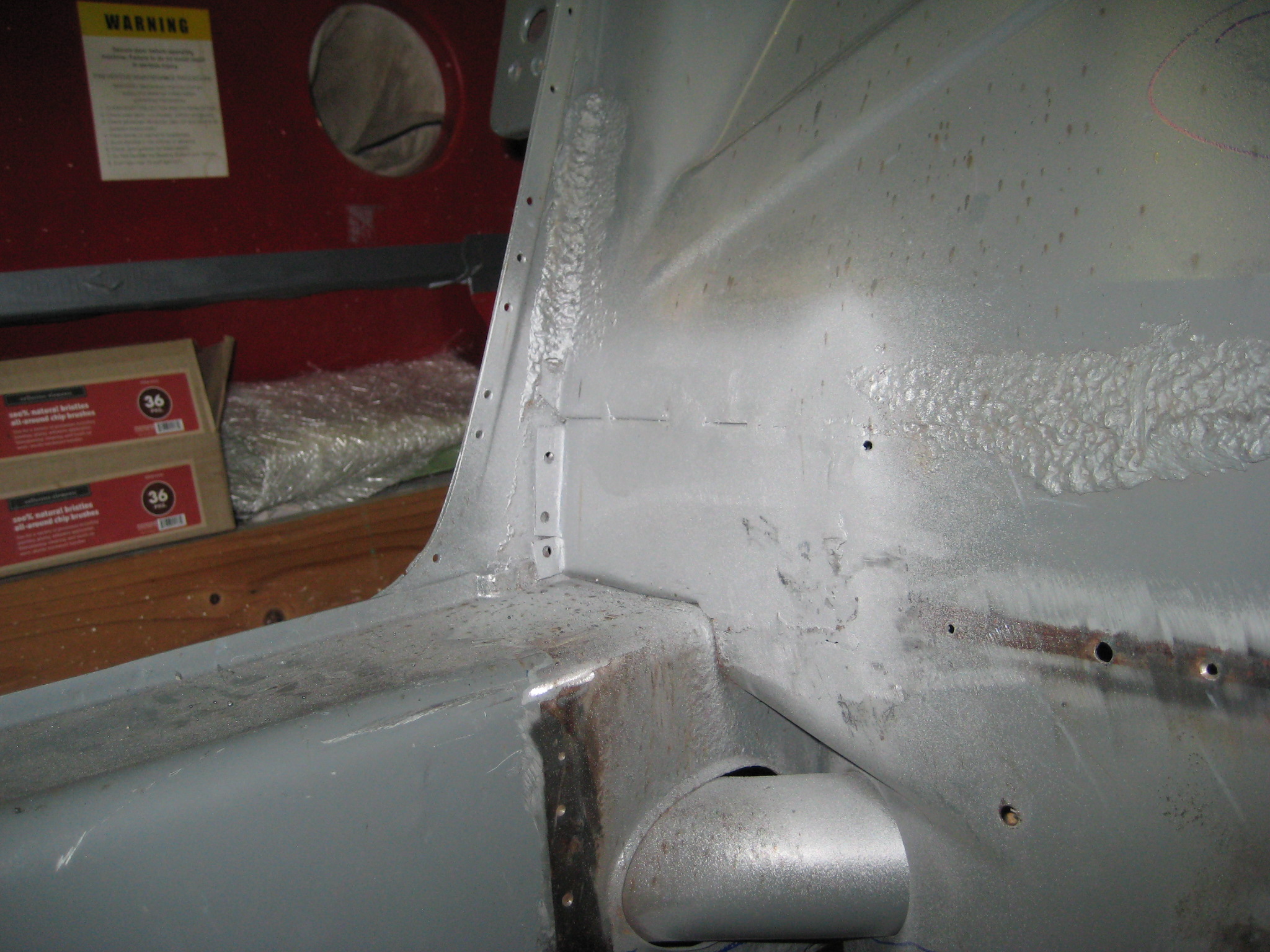

dlee6204
post Dec 12 2011, 03:29 PM
Howdy
Posts: 2,162
Joined: 30-April 06
From: Burnsville, NC
Member No.: 5,956
Update: Here is the corner of the firewall welded in. I lightly coated it with a primer to keep it from rusting.
