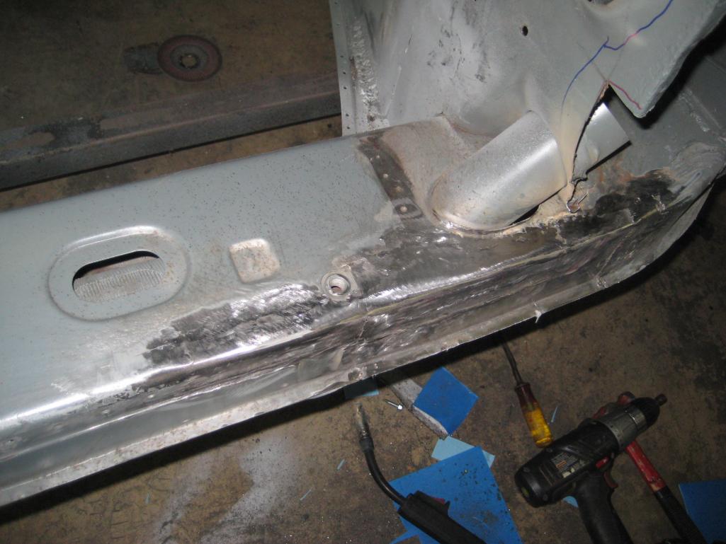

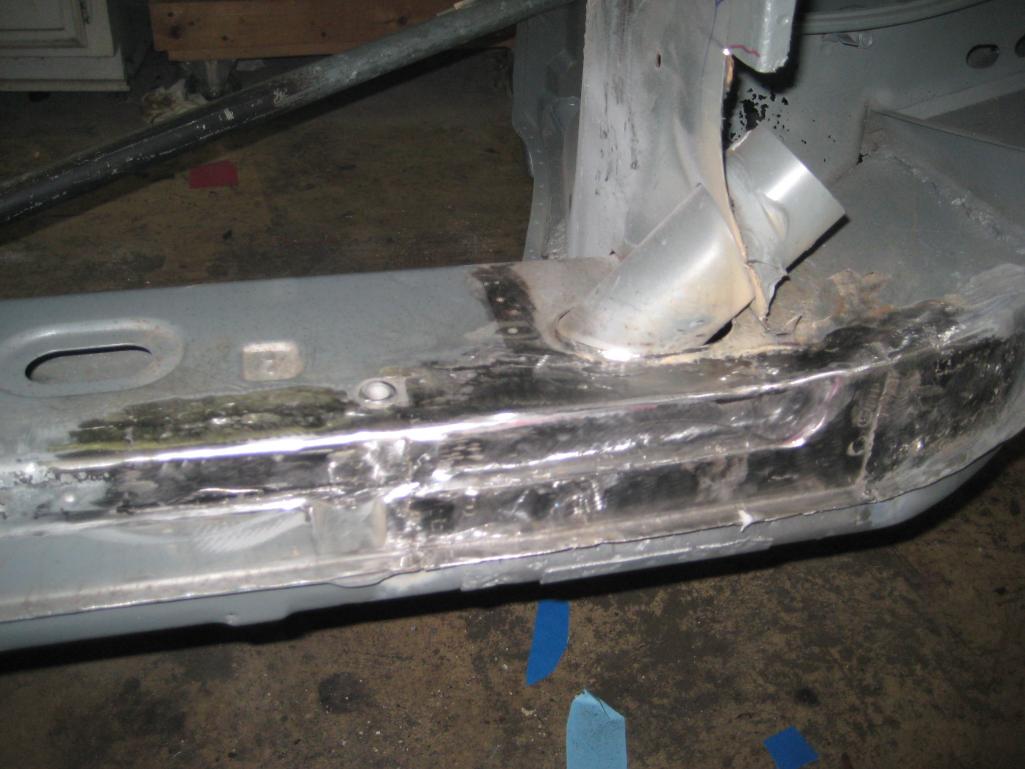

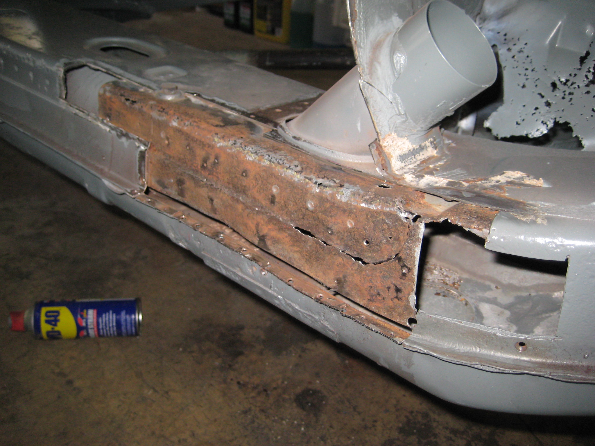

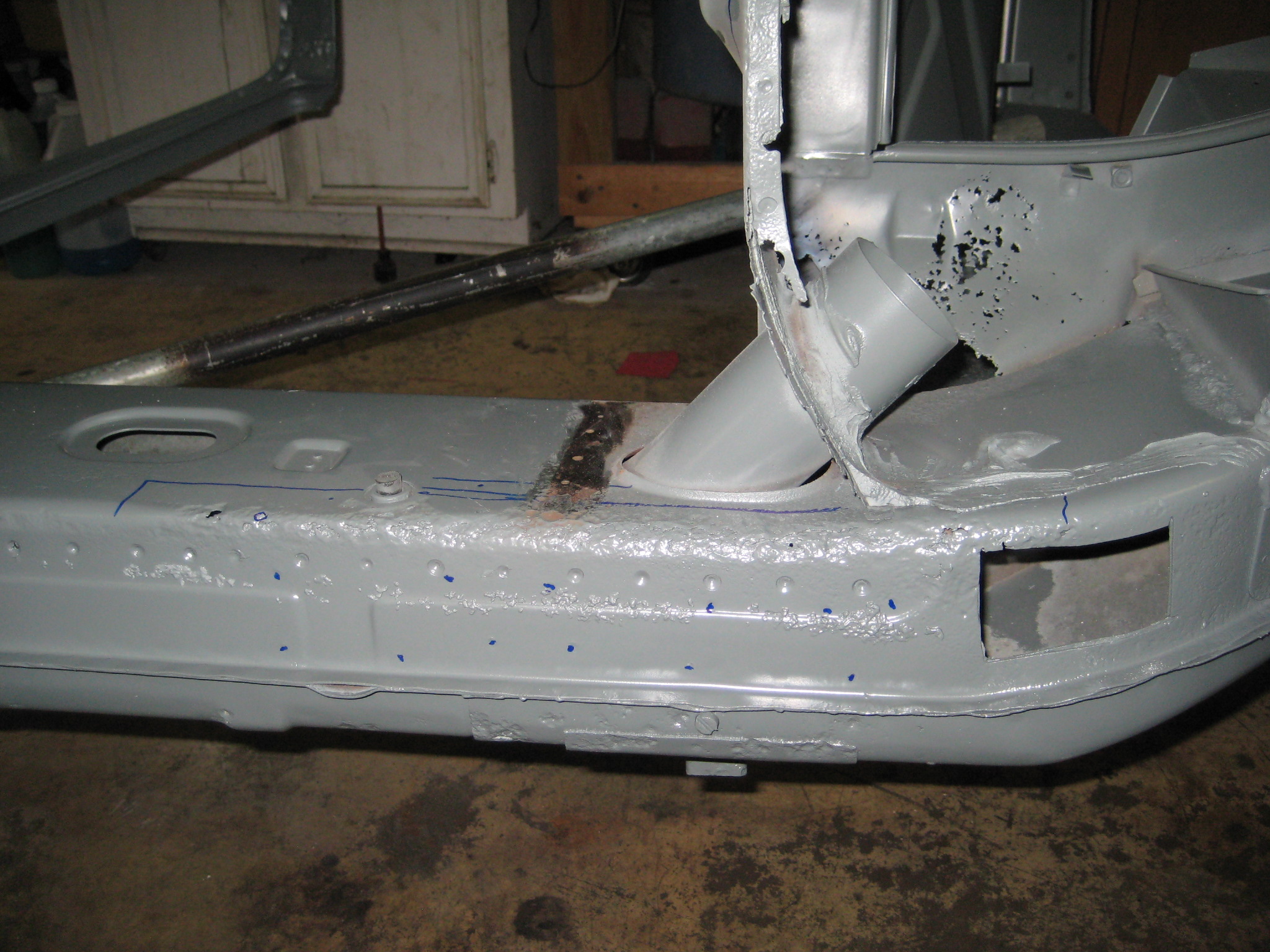

I next moved onto the pass. long.
Top layer of bad stuff cut out...
I didn't get a picture but I also cut out some of the substructure and welded in a new piece before welding in a new formed piece so everything is doubled-up for strength (IMG:style_emoticons/default/smile.gif)

dlee6204   Update: Here is the corner of the firewall welded...   Dec 12 2011, 03:29 PM
dlee6204   I next moved onto the pass. long. Top layer o...   Dec 12 2011, 03:37 PM

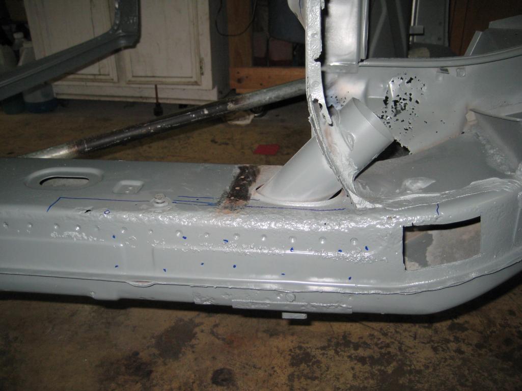

dlee6204   Next came the driver's side long which was not...   Dec 12 2011, 03:43 PM
dlee6204   And for the record, I used 18 gauge steel. I...   Dec 12 2011, 03:51 PM
