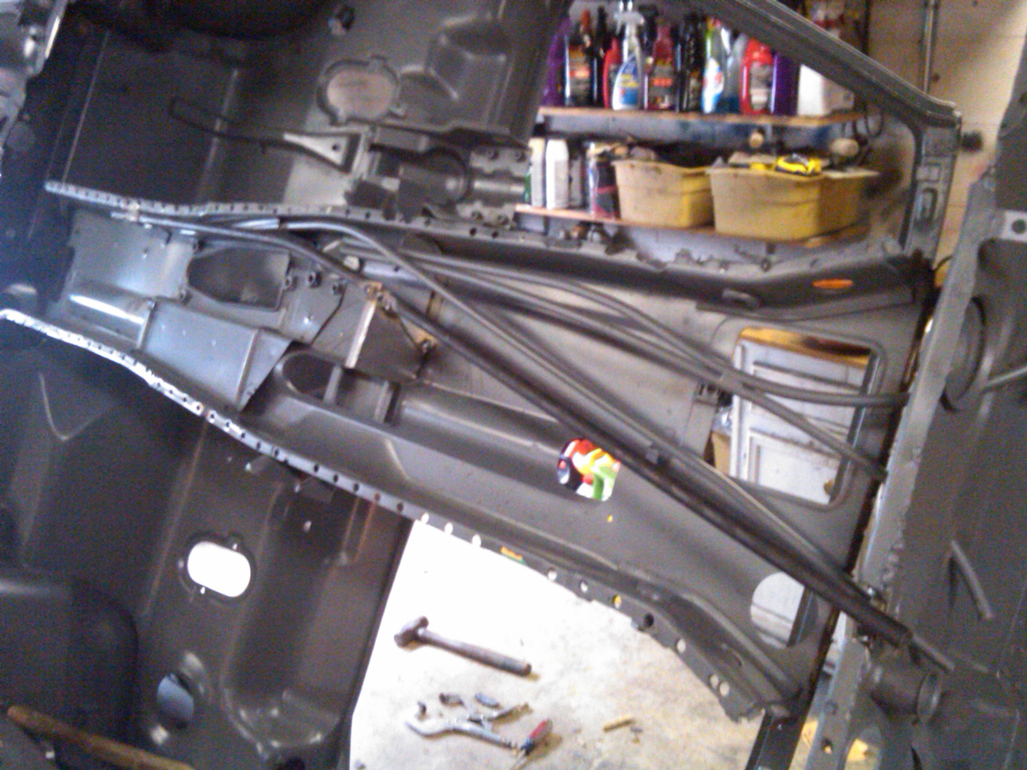

Got a little more work done today. I finished replacing the entire clutch tube and got the new floorpans fitted and tacked into place. (IMG:style_emoticons/default/boldblue.gif) Couldn't find the camera so I snapped two quick shots with the cell phone...

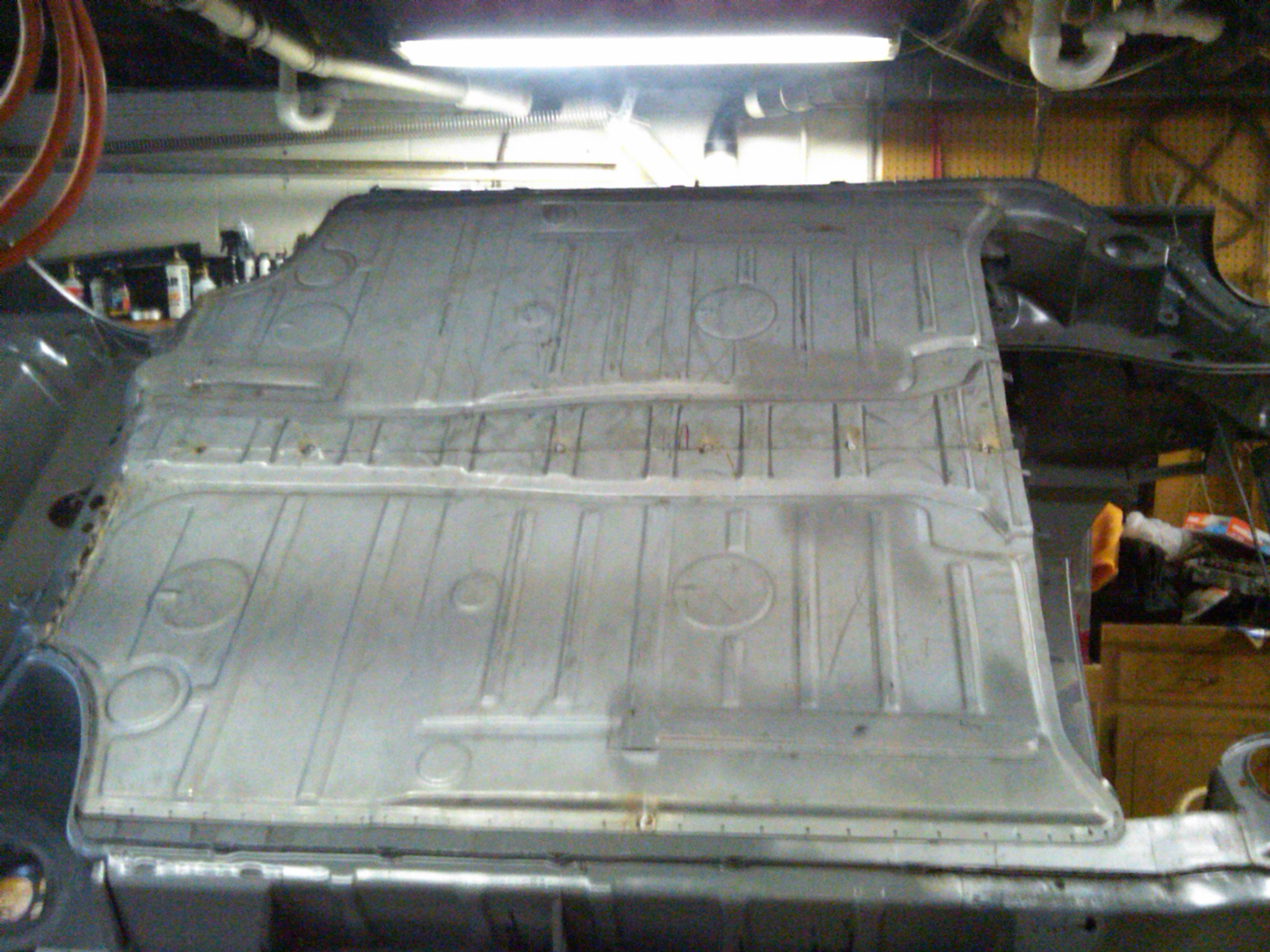

dlee6204   Got a little more work done today. I finished rep...   Dec 16 2011, 10:05 PM

dlee6204   The floor is done, the center tunnel welded in, cr...   Jan 3 2012, 11:16 AM
dlee6204   Before... After... I need to remember to repl...   Jan 3 2012, 11:27 AM
