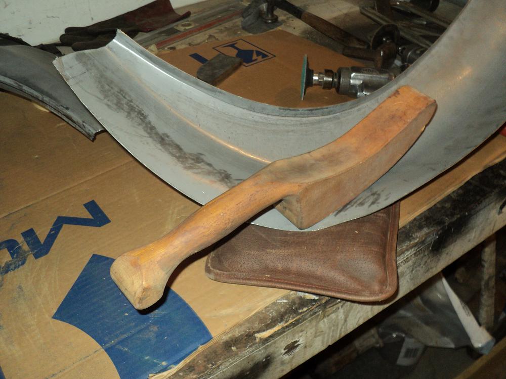

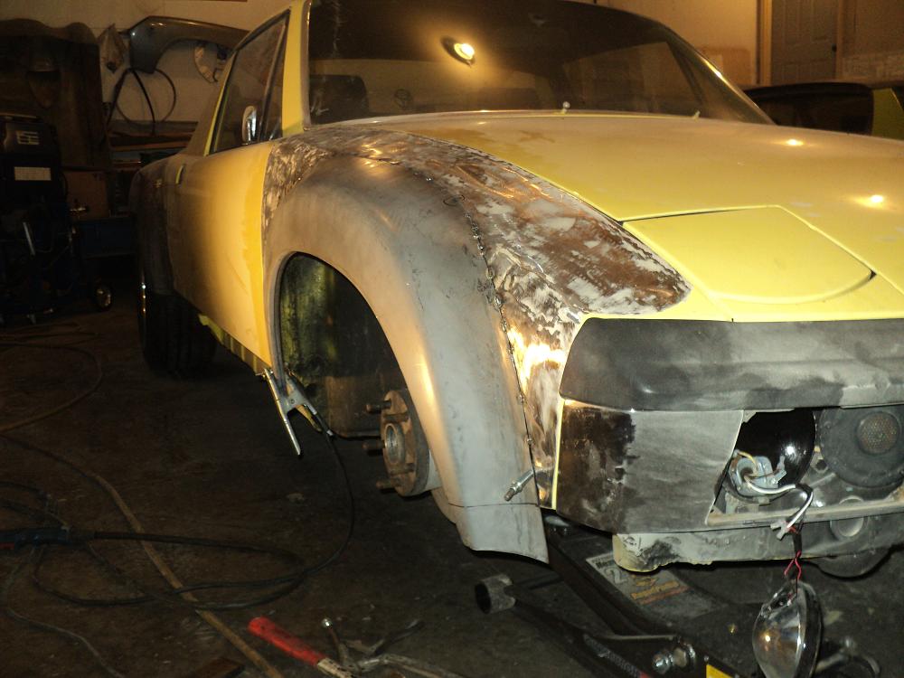

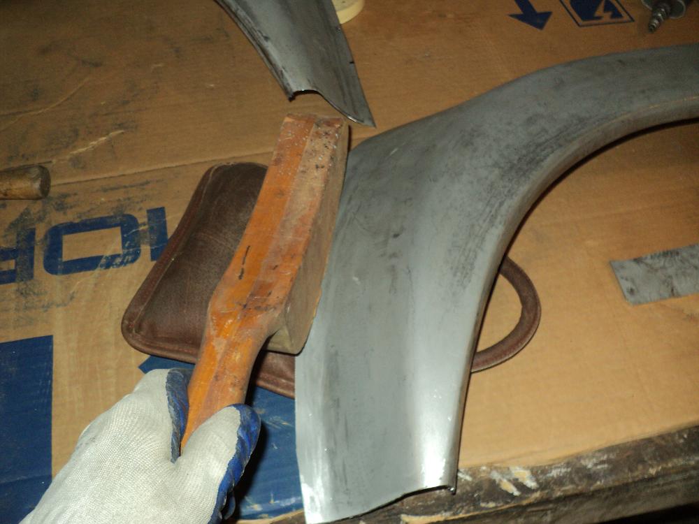

Yep, Very mild here. (IMG:style_emoticons/default/biggrin.gif) Here's a sample of the work for this weekend. I haven't decided if I am going to raise the wheel opening yet. At full lock the tire is very close to the lip.
I had to reshape the front of the flares. Here's my slapper and shot bag in action.
Here's the flare butt tacked to the slope nose. Notice how much I had to lower the flare to line up the top surface.
