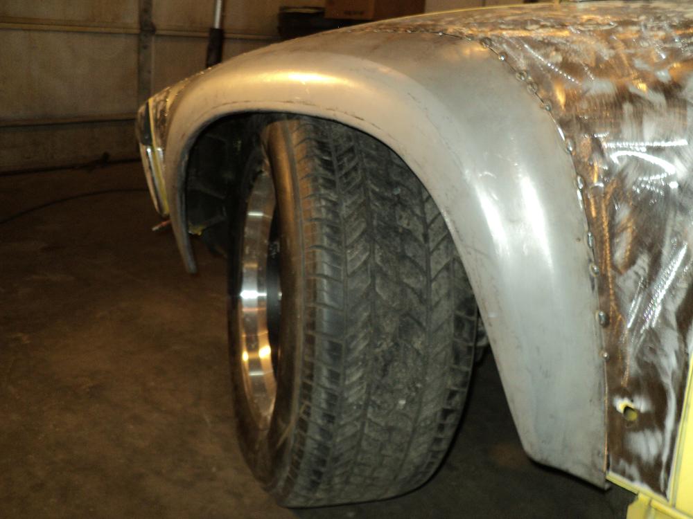

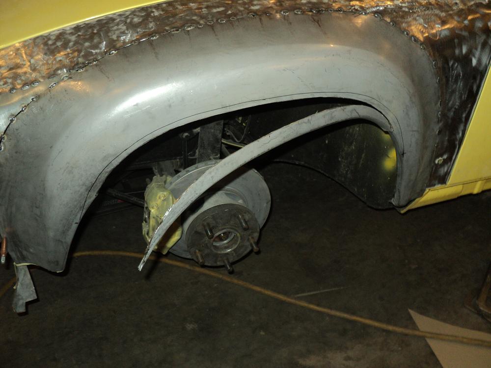

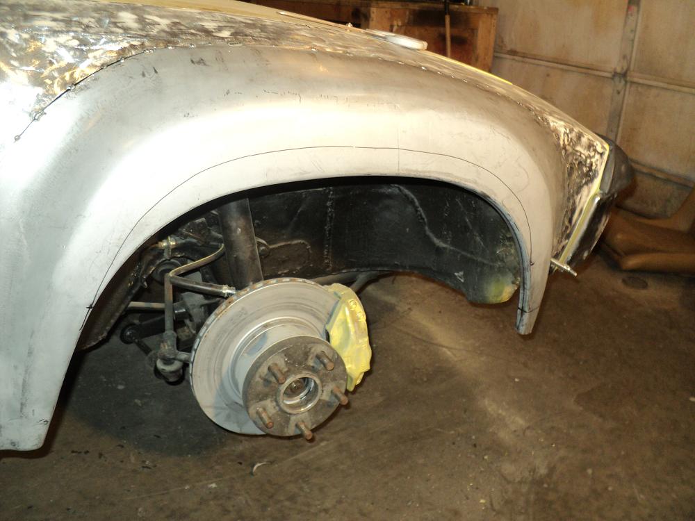

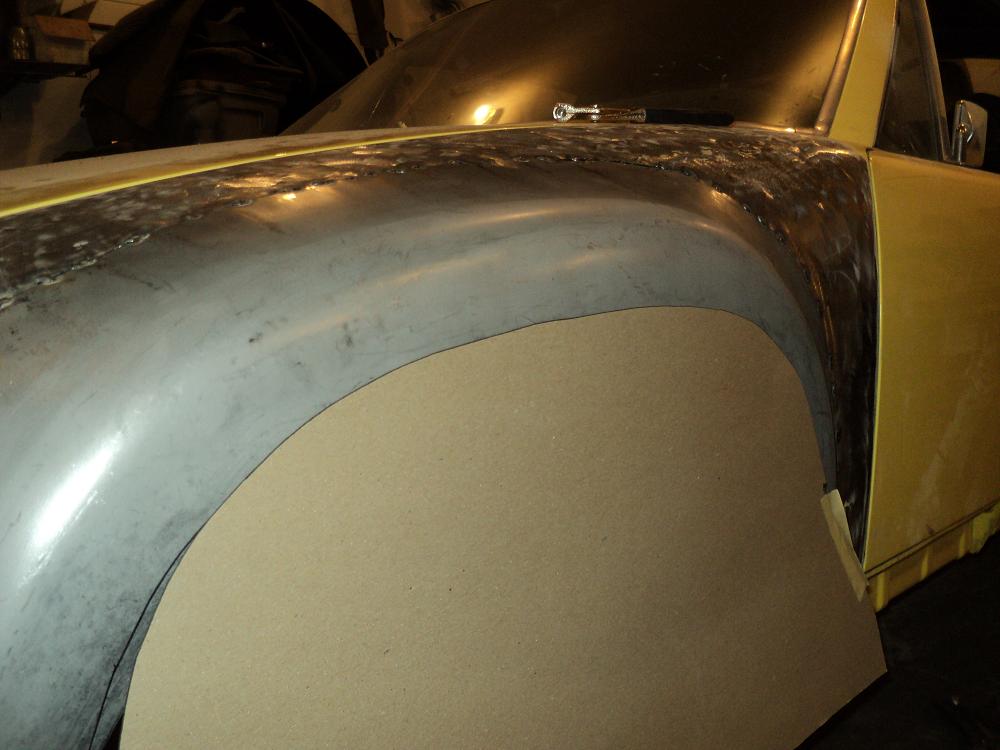

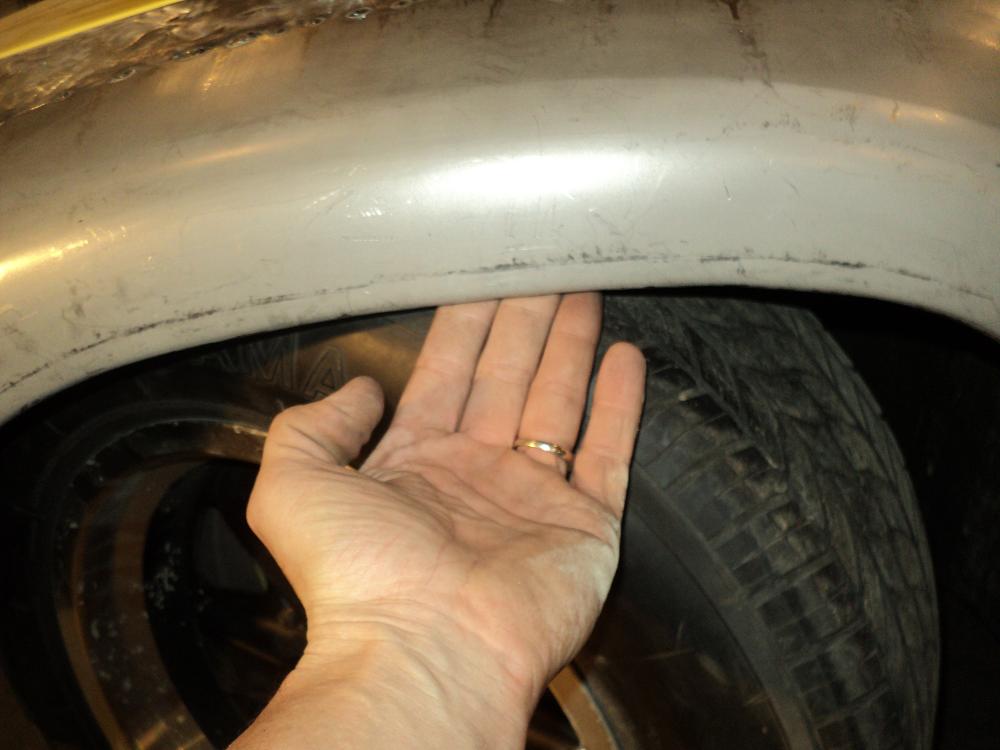

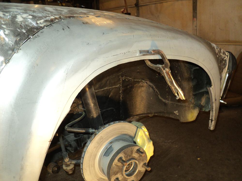

The flares were too close to the tires so I raised the lips.
I made up a clamp with angle iron on both sides to hold the flare while hammering the new lip. This allowed me to give the flare a crisp lip with minimal distortion.

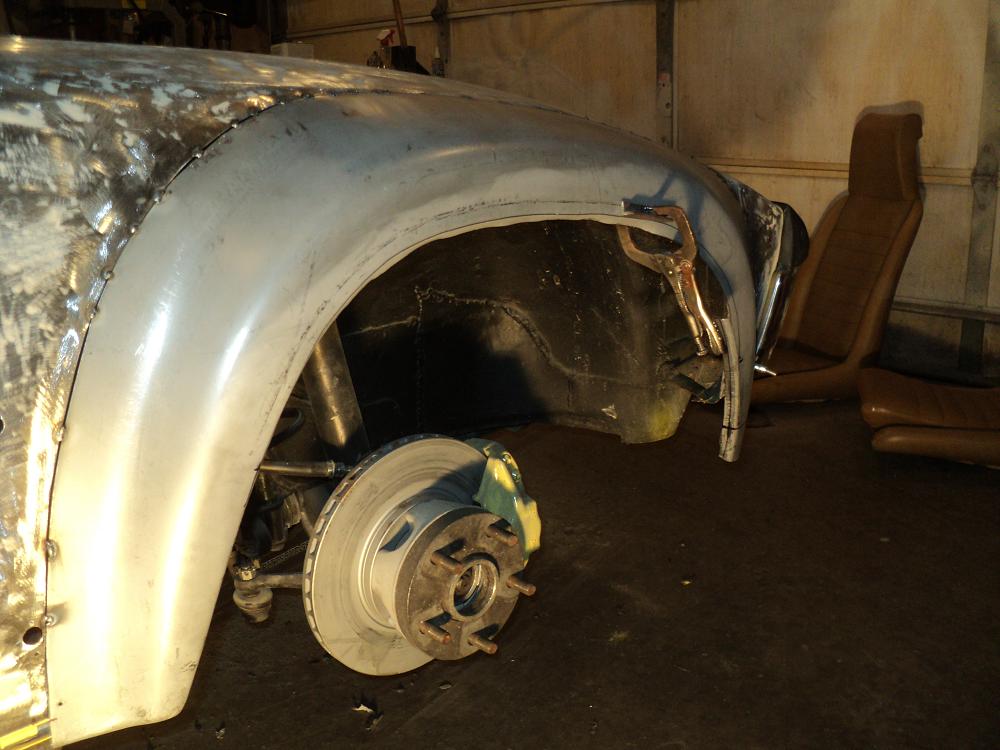

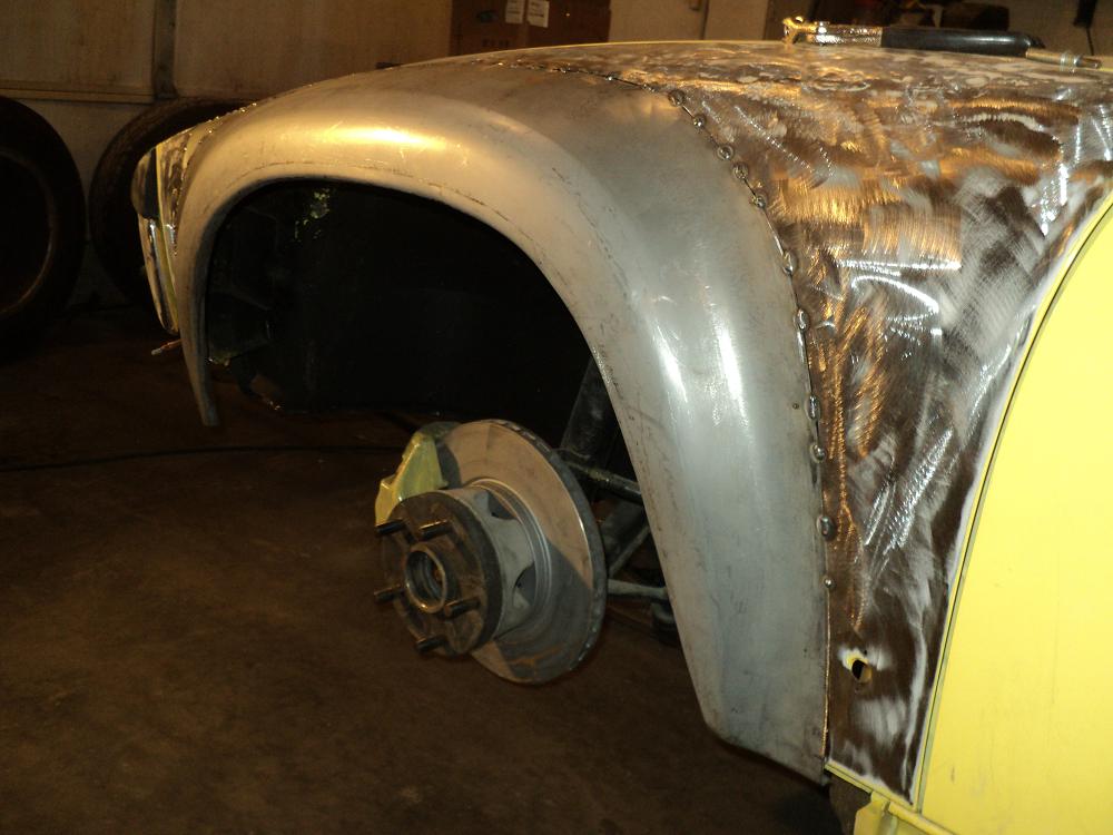

rick 918-S   The flares were too close to the tires so I raised...   Dec 24 2011, 12:28 AM
