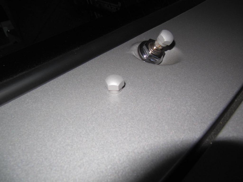

Here is a close up of the paint, er glass beaded aluminum finish! Well the wiper nuts are glass beaded aluminum!

Krieger   Here is a close up of the paint, er glass beaded a...   Dec 24 2011, 03:26 PM
Randal   Here is a close up of the paint, er glass beaded ...   Dec 24 2011, 05:13 PM
Krieger   I had someone spray it in my garage. I'm good...   Dec 24 2011, 06:03 PM
