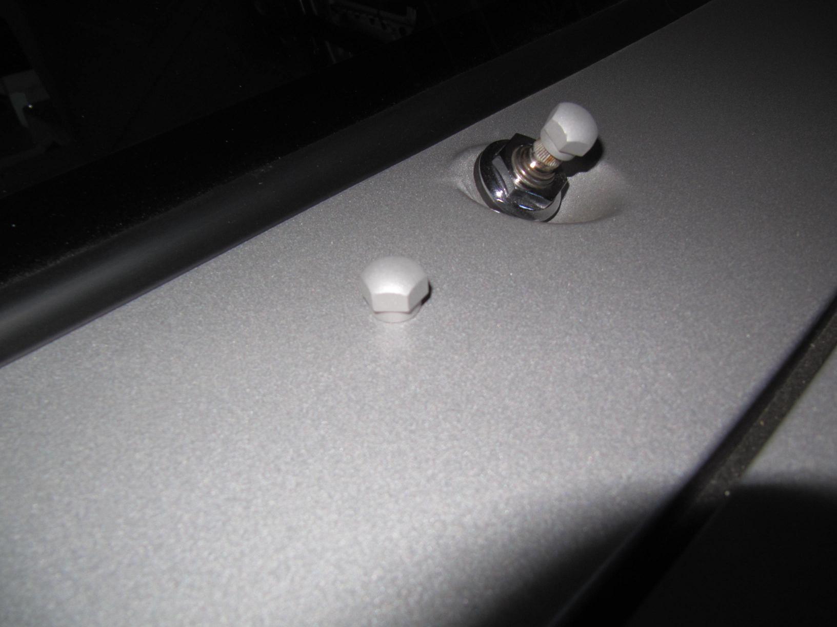

Here is a close up of the paint, er glass beaded aluminum finish! Well the wiper nuts are glass beaded aluminum!
I really like the paint. Super cool.
