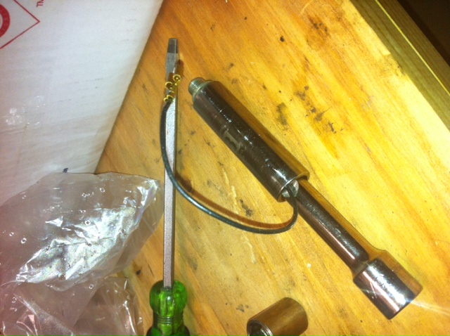

can the CHT be removed with out taking out the intake runners. it seems like they would be in the way.
thanks.

Yes
You need to make the "special tool"!
