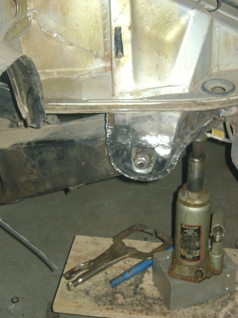

Ok, thanks for all the replies and offers for a used console.
Since mine is relatively rust free I decided to try to fix it before replacing.
We cut out the crack, jacked it back into place, inserted a backup plate and rewelded.
Next I will get the reinforcement plates from CFR and then add the stiffening brackets like the previous posters showed on page 1.
Is this better? :
(IMG:http://www.914world.com/bbs2/uploads_offsite/i366.photobucket.com-10819-1290884315.1.jpg)
I will seam weld everything I can find while I am under there.

Racer Chris   They do not interfere with the valve covers.   Nov 27 2010, 03:23 PM
