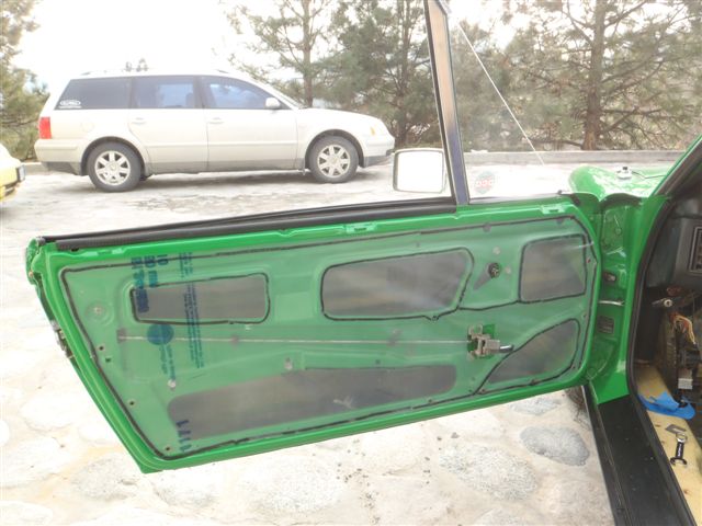

The big Red guy brought me some goodies for my girl! I scored all the rubber bits needed to complete the doors.
I spent the last couple of days installing them and making new vapor barriers.
I installed them using butyl tape cut into thin strips. TBT20 (Thomas and Betts) it's a pipe tape that sticks to everything BUT pipe! works great on vapor barriers.
