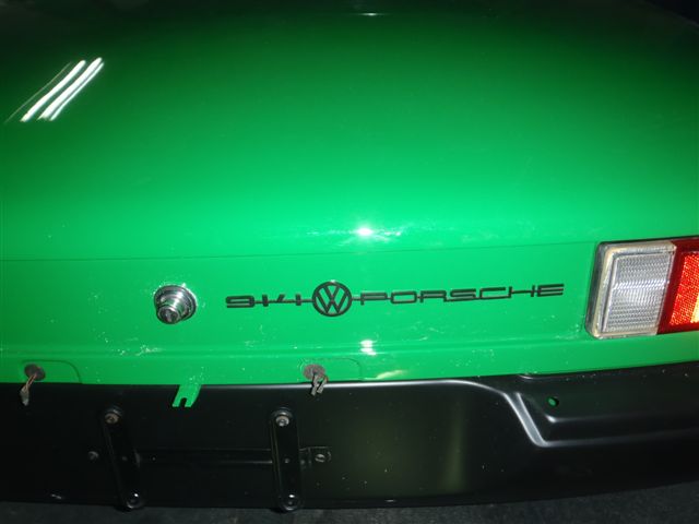

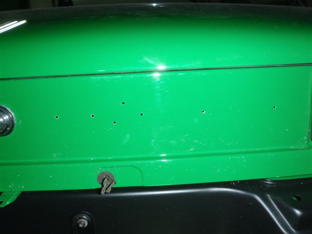

Today was a little tense! There are some things on these cars you only get one shot at and Drilling holes in the new body work is one of them.
I started with a mylar template ,transfered that to a test piece of sheet metal and then once I confirmed the mylar template was good, I taped it to the body and centered punched. The first hole is always the worst......
With alot of prep and a little luck...you get this
and maybe this (IMG:style_emoticons/default/beer3.gif)
