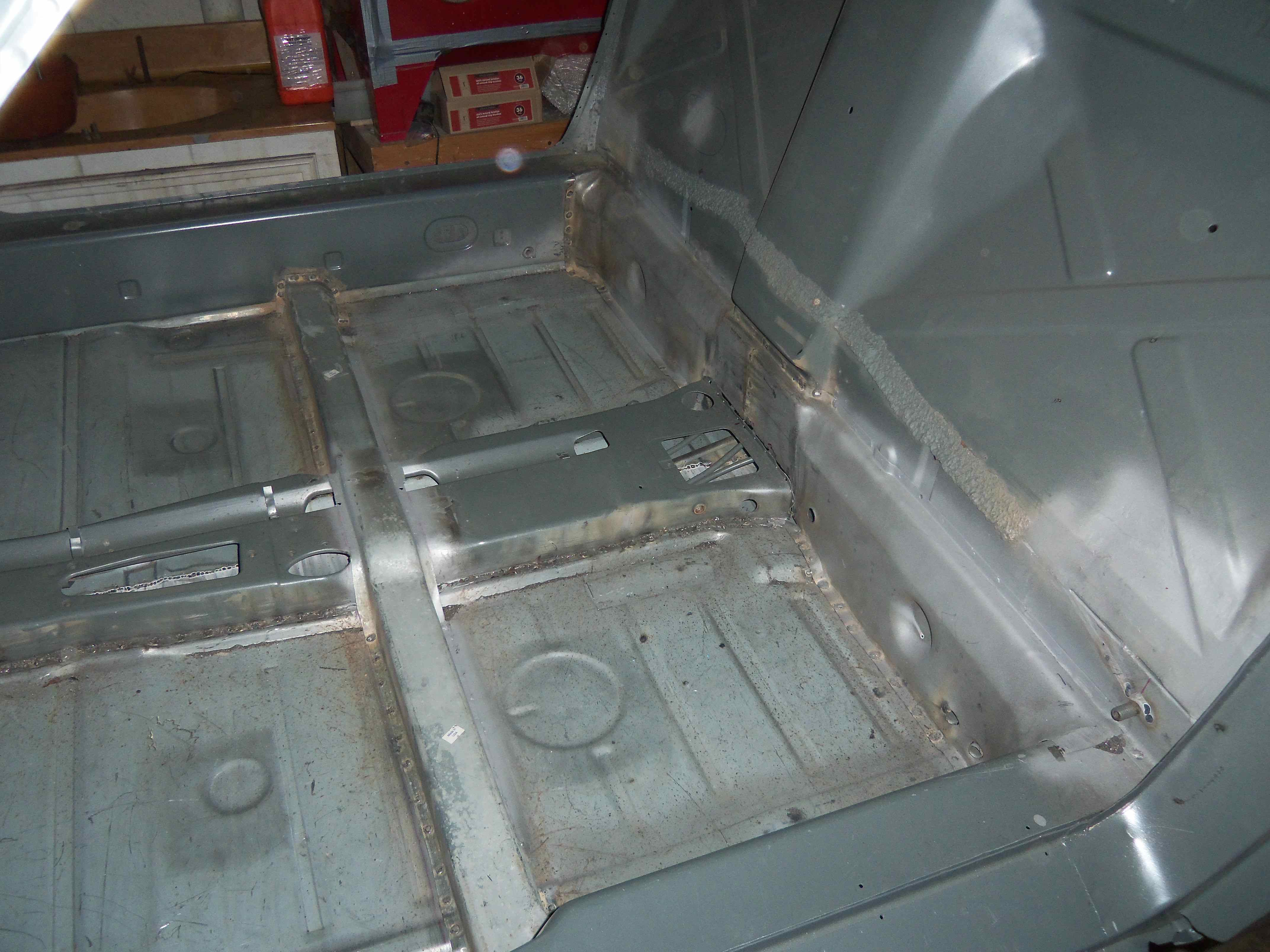

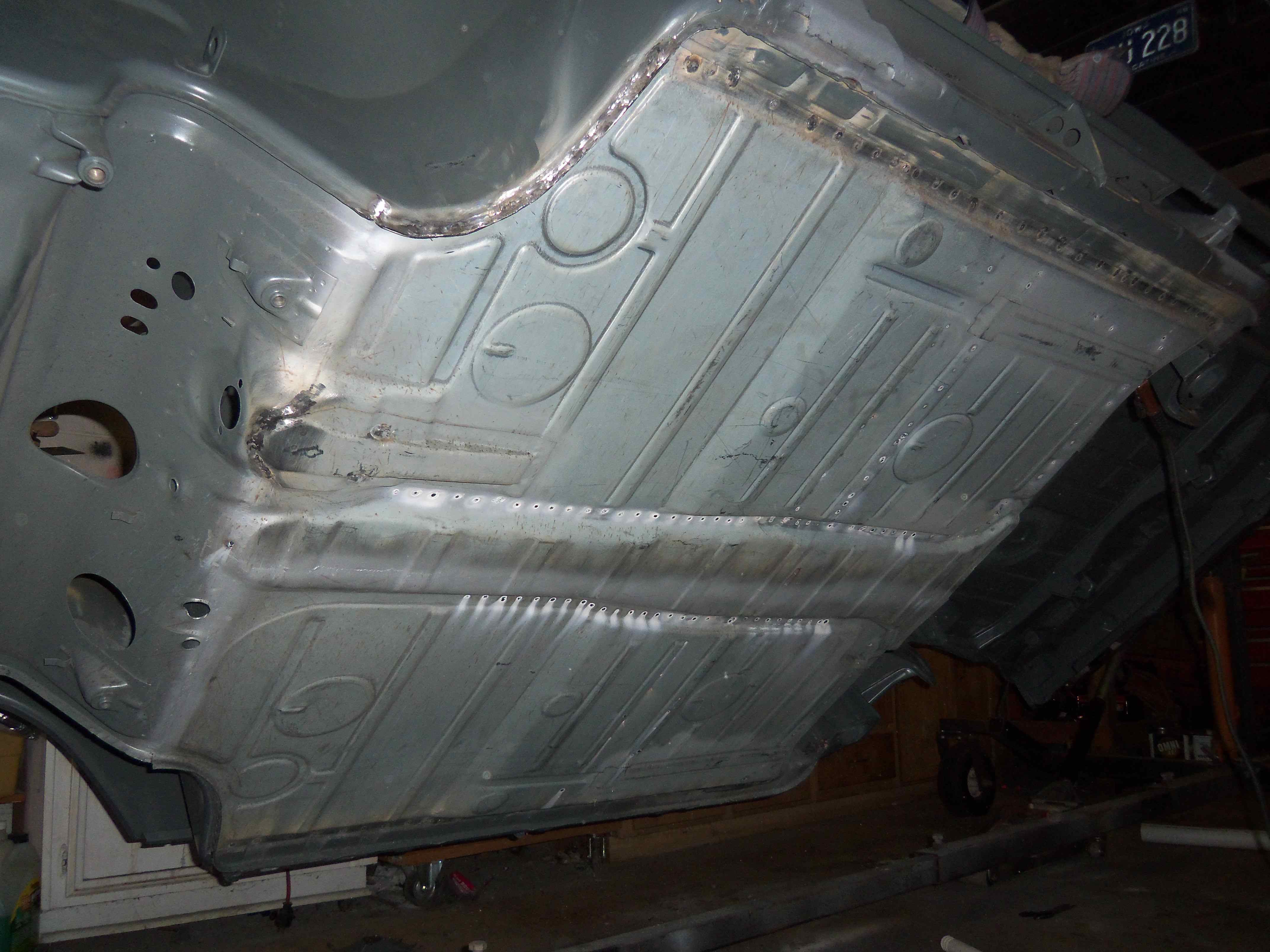

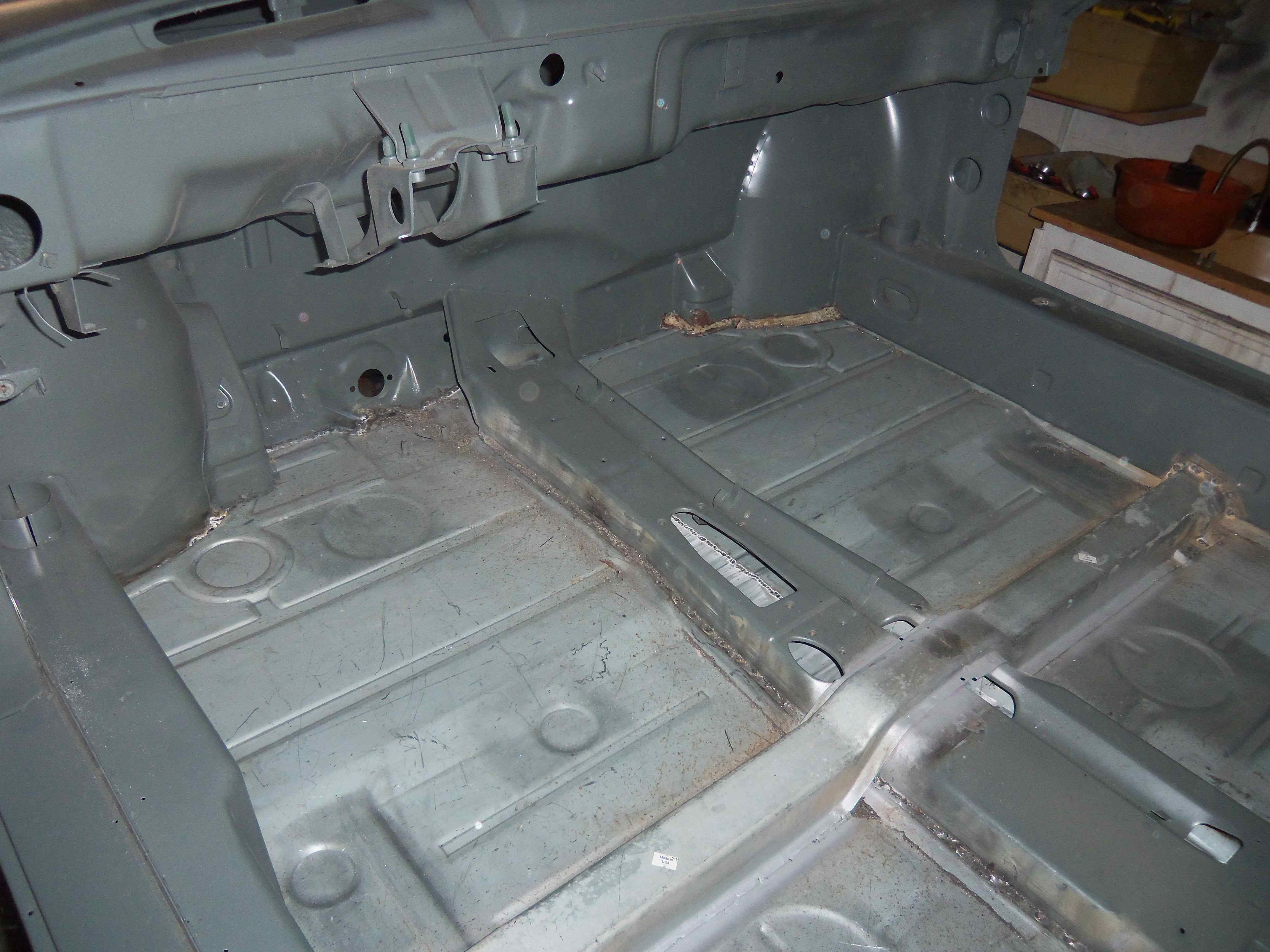

The floor is done, the center tunnel welded in, cross-members in, inner lower firewall in, driver's side engine shelf and firewall are repaired, and a new engine lid latch tube is in. (IMG:style_emoticons/default/smile.gif)

dlee6204   The floor is done, the center tunnel welded in, cr...   Jan 3 2012, 11:16 AM
