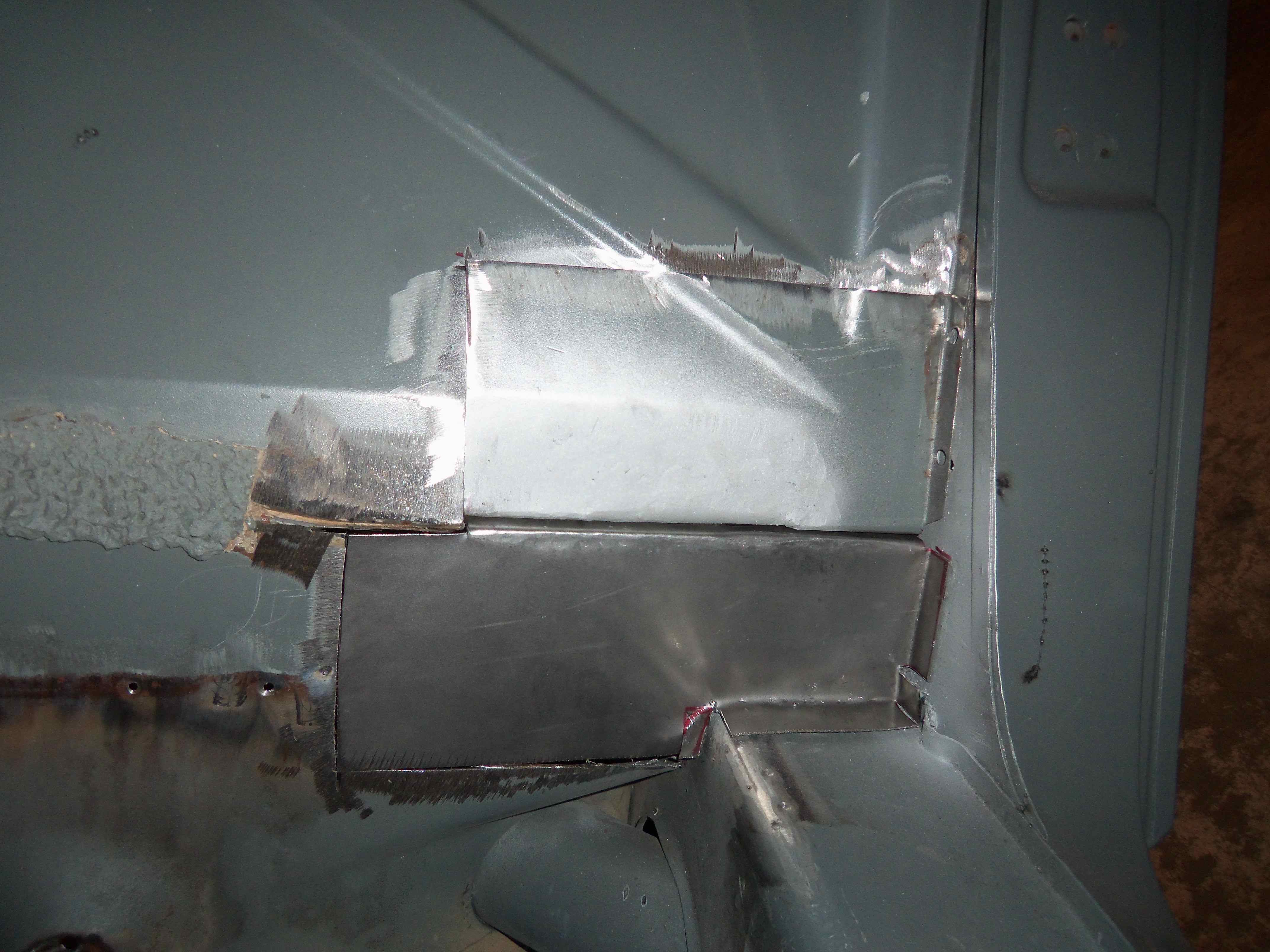

dlee6204   And I made up a panel to replace the area. That...   Nov 26 2011, 10:06 PM
rick 918-S   And I made up a panel to replace the area. That...   Nov 26 2011, 10:21 PM
saigon71   And I made up a panel to replace the area. That...   Nov 27 2011, 08:02 AM

dlee6204   The metal I am using is 20 ga. Not the thin stu...   Nov 27 2011, 06:58 AM

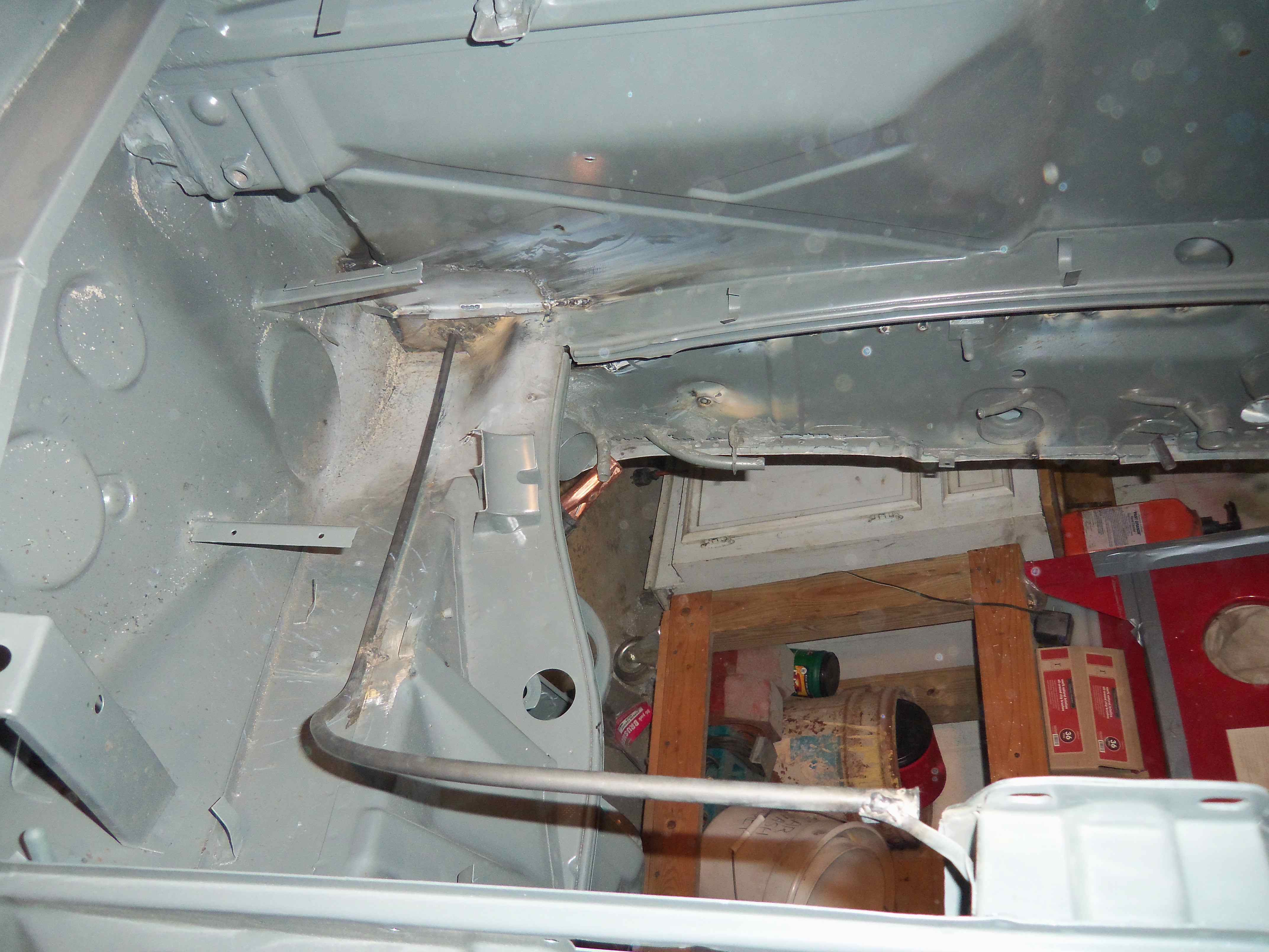

dlee6204   Update: Here is the corner of the firewall welded...   Dec 12 2011, 03:29 PM

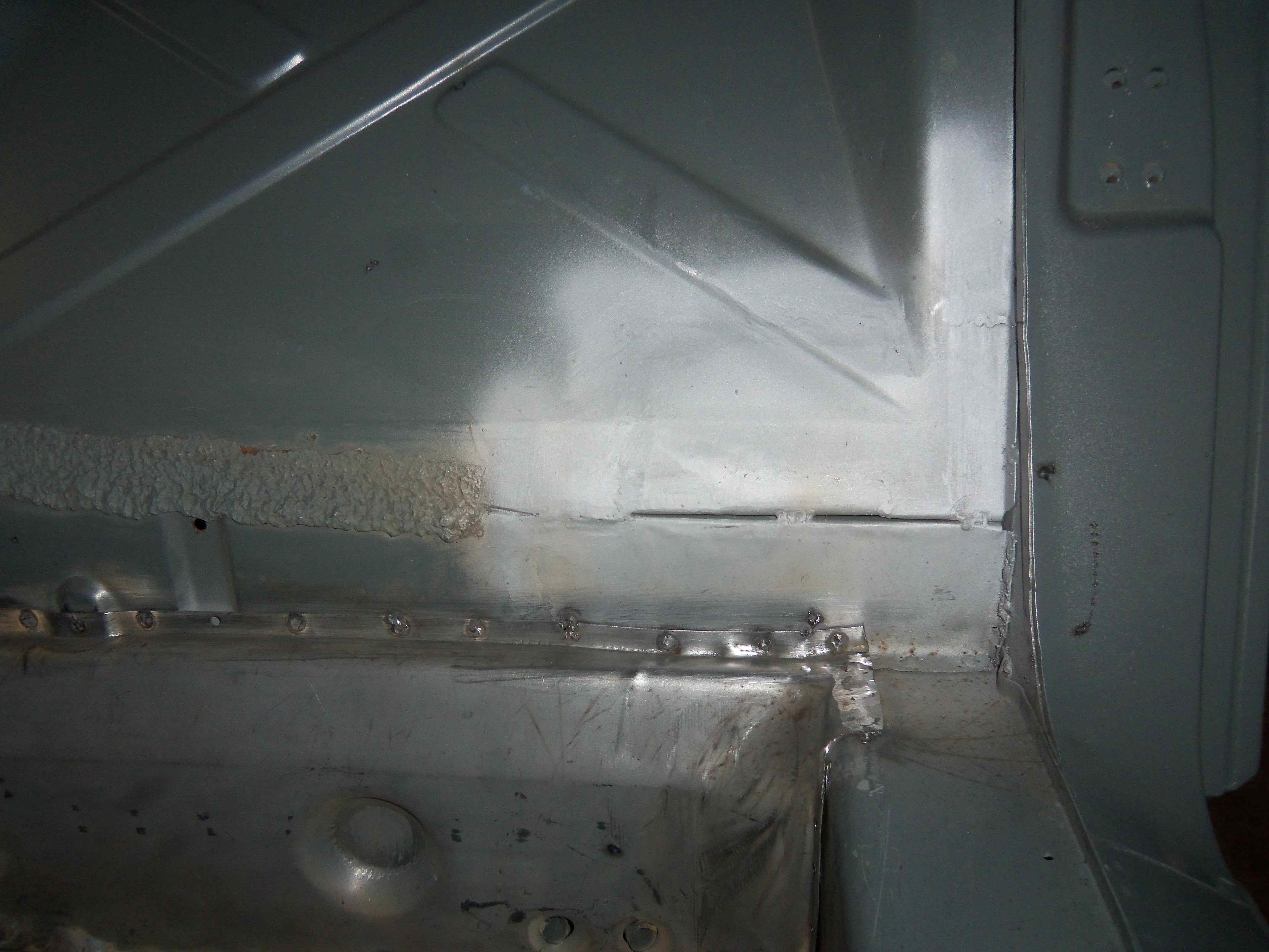

dlee6204   Yup. The gaps and body measurements checked out...   Jan 3 2012, 11:08 AM

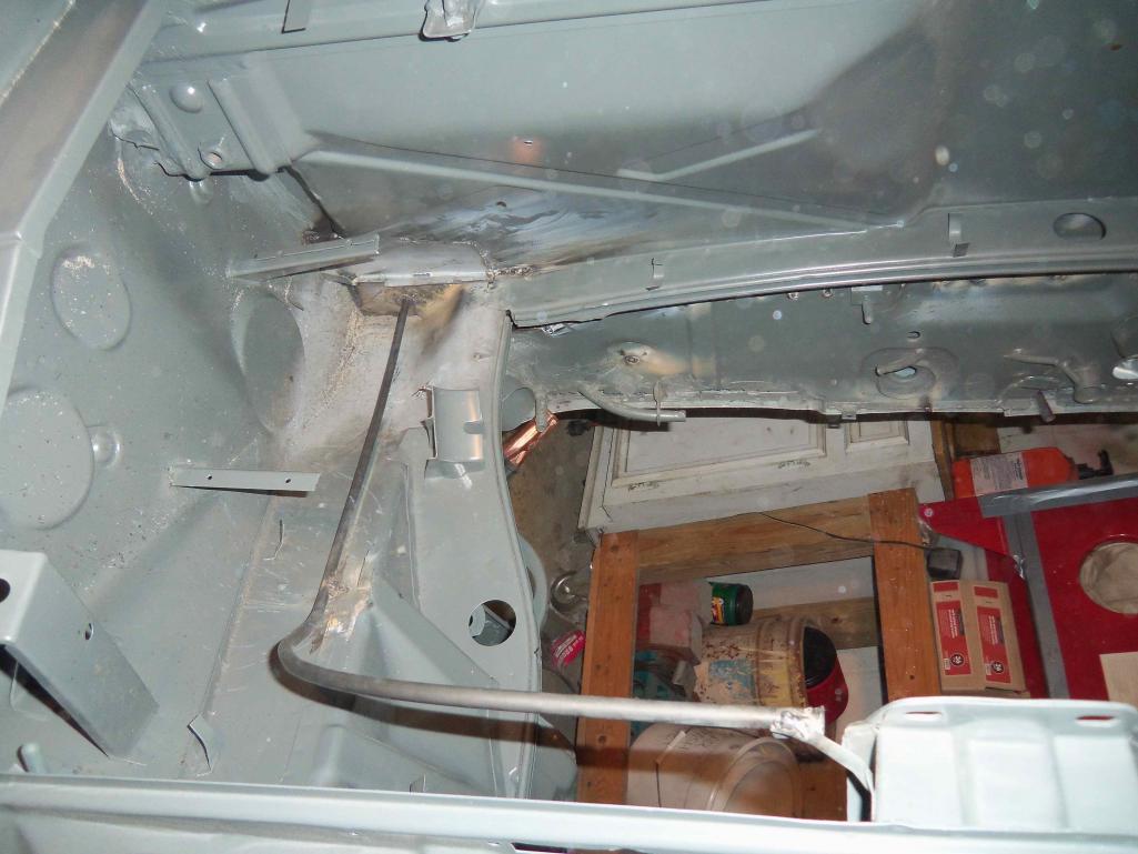

dlee6204   The floor is done, the center tunnel welded in, cr...   Jan 3 2012, 11:16 AM

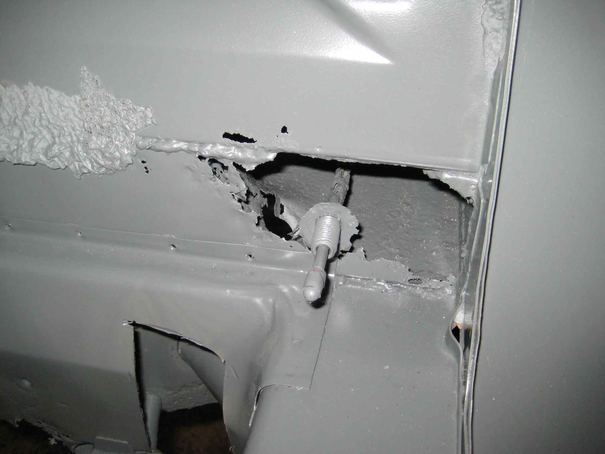

dlee6204   Before... After... I need to remember to repl...   Jan 3 2012, 11:27 AM
dlee6204   Patched a small area on the front of the long... ...   Jan 3 2012, 11:36 AM
dlee6204   I also went ahead and removed the jack points. Th...   Jan 3 2012, 11:41 AM

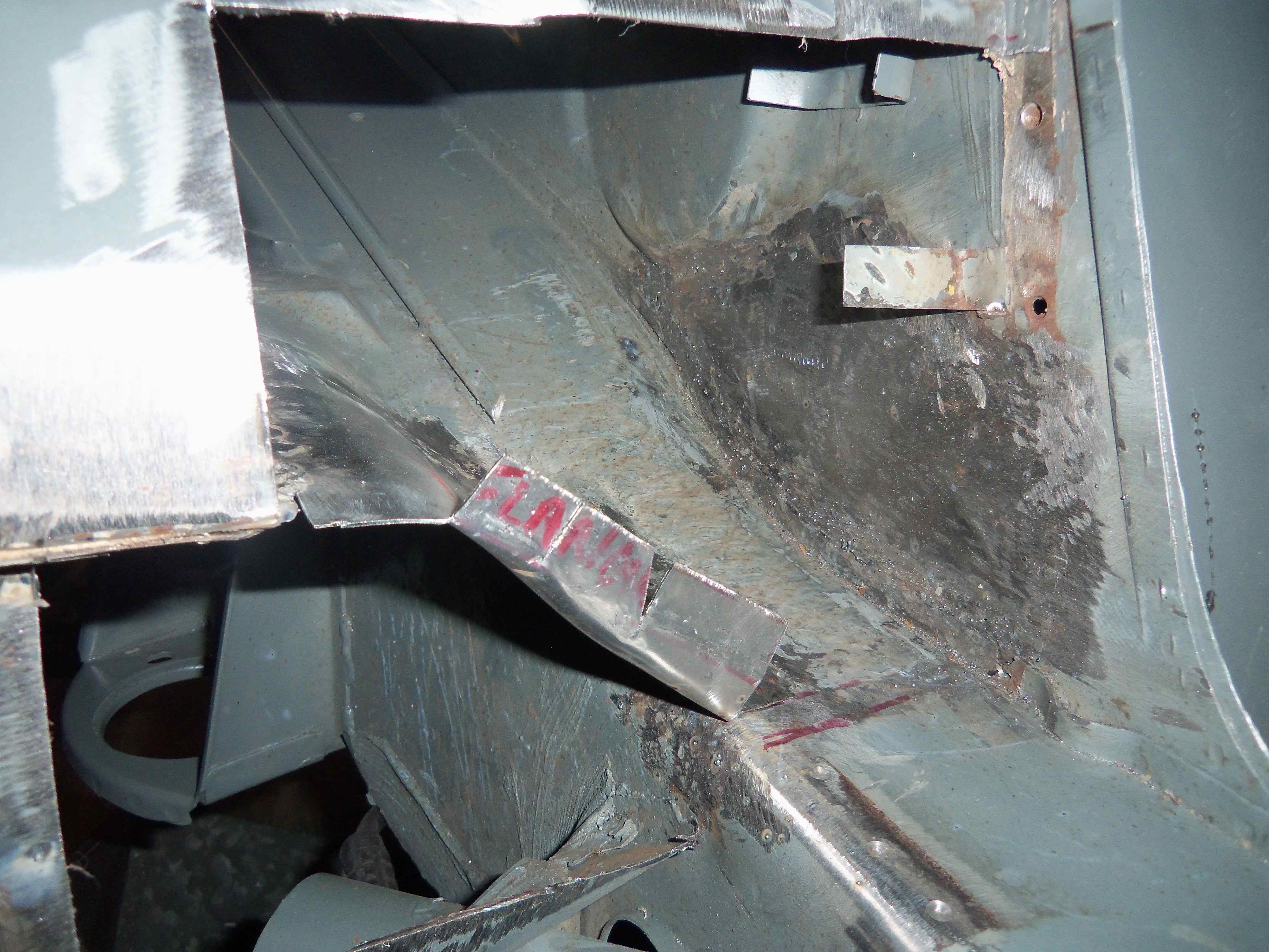

dlee6204   And I started prepping to work on the hell hole......   Jan 3 2012, 11:44 AM

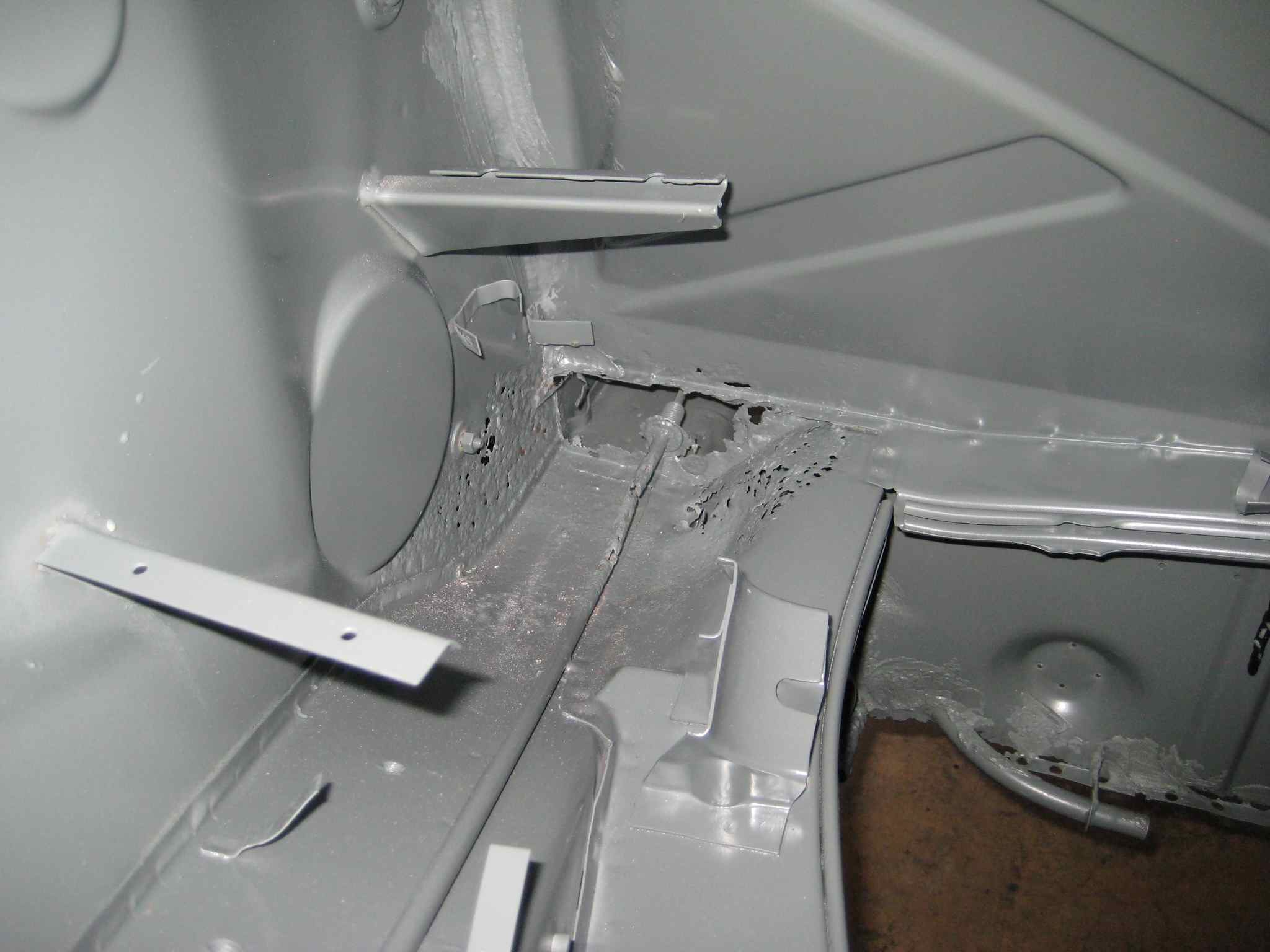

dlee6204   Update: I've been working on a lot of littl...   Feb 23 2012, 08:52 PM
dlee6204   The front trunk floor also has some thin metal wit...   Feb 23 2012, 08:58 PM
dlee6204   I did some work on the lower firewall too. ...   Feb 23 2012, 09:12 PM
