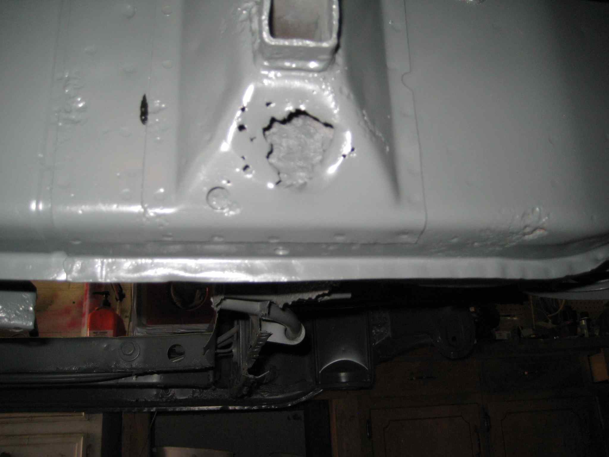

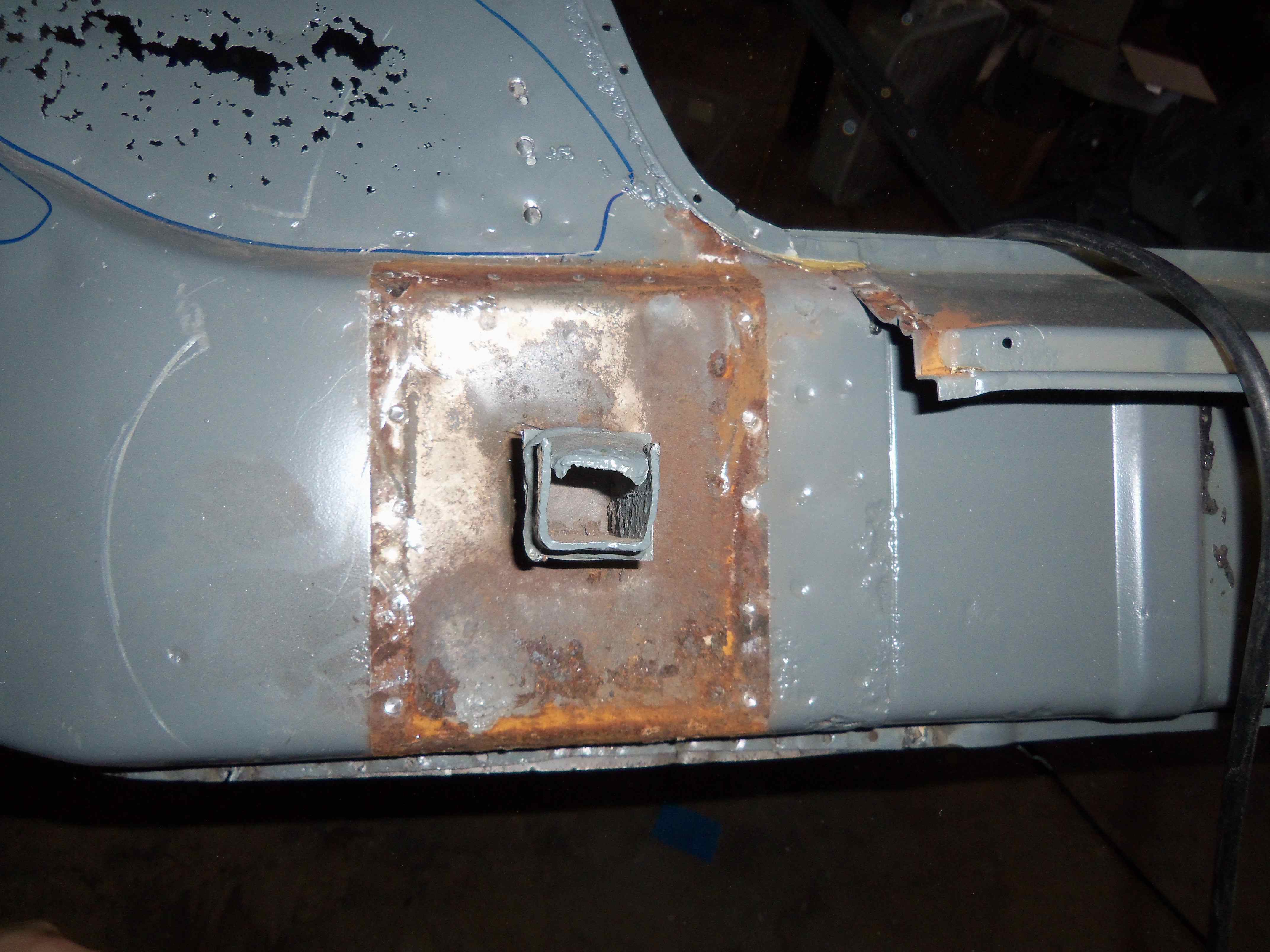

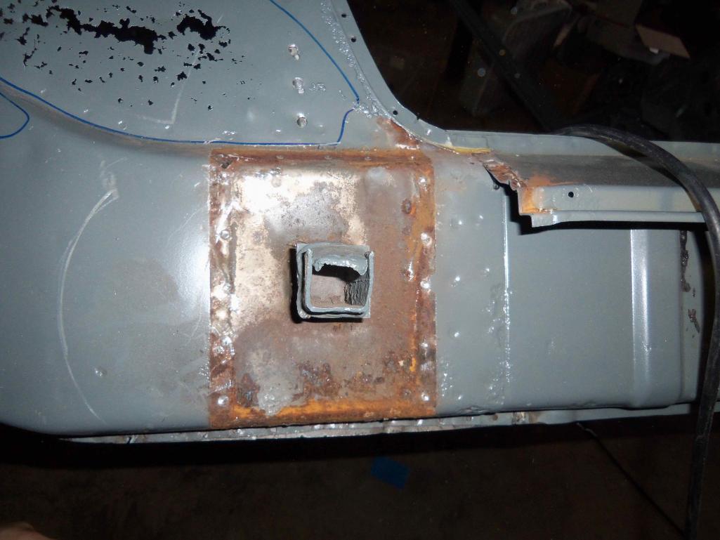

dlee6204   Got some more work done today. I got the jack poi...   Feb 4 2012, 03:49 PM

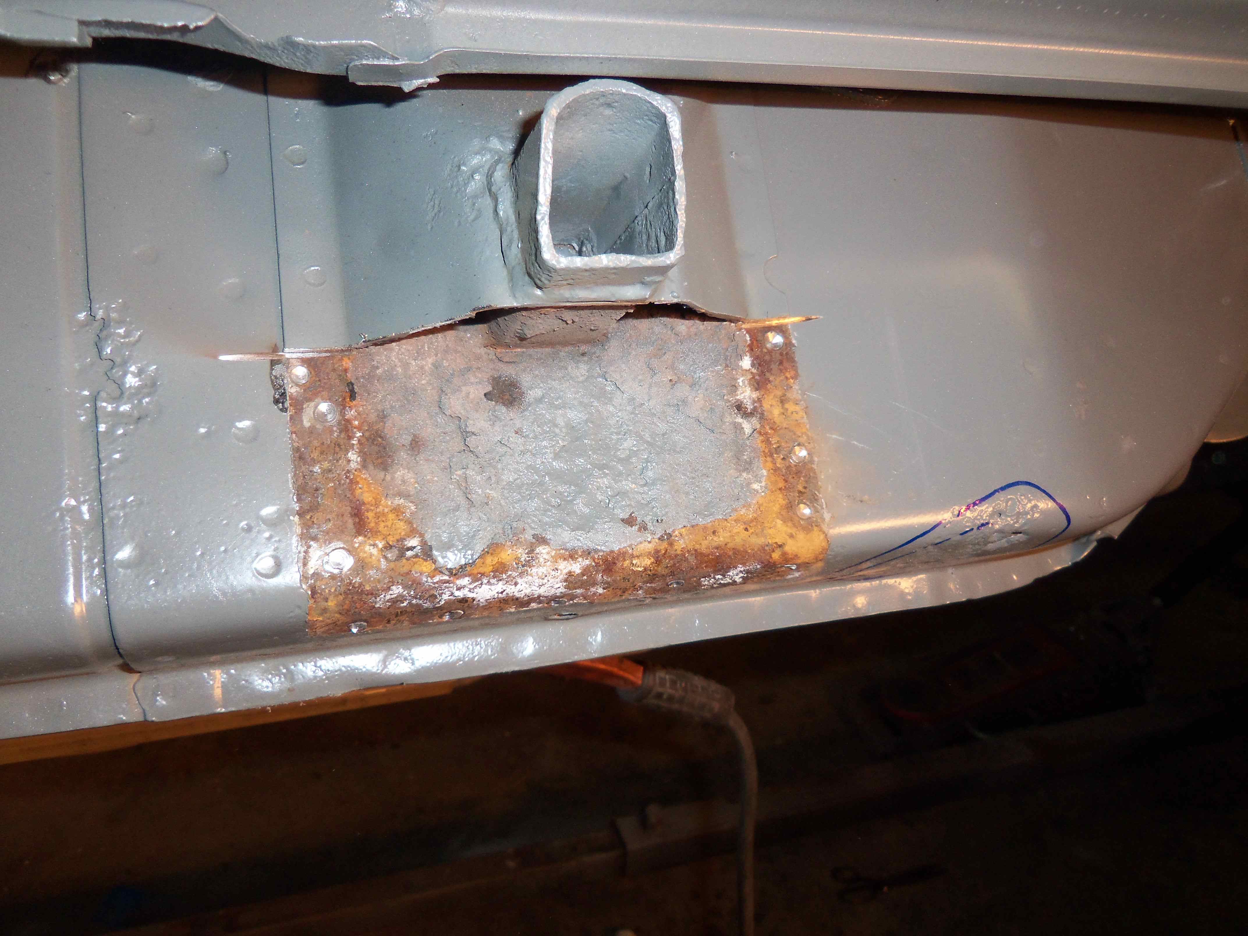

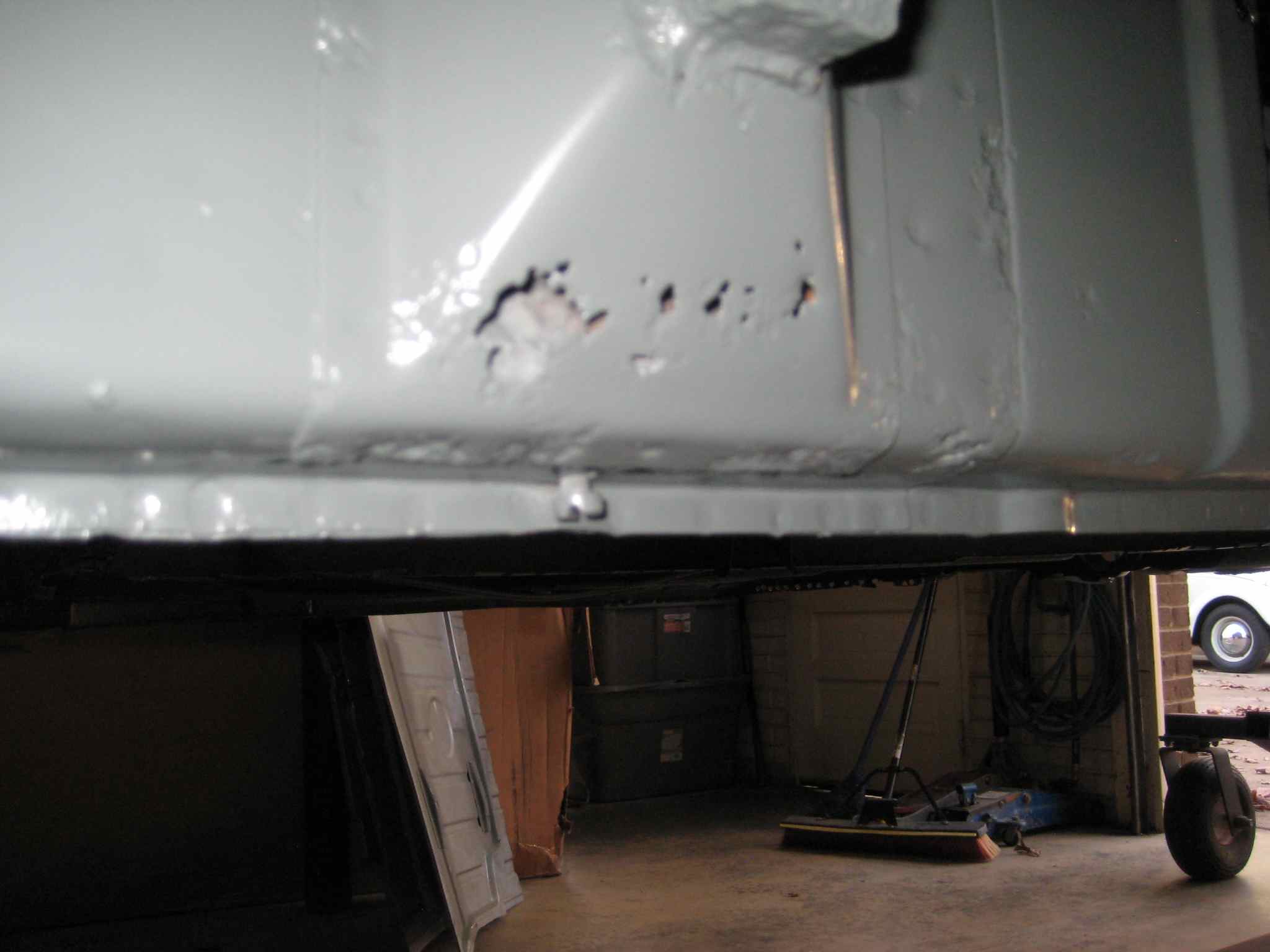

dlee6204   The story was the same for the other side...   Feb 4 2012, 03:51 PM
