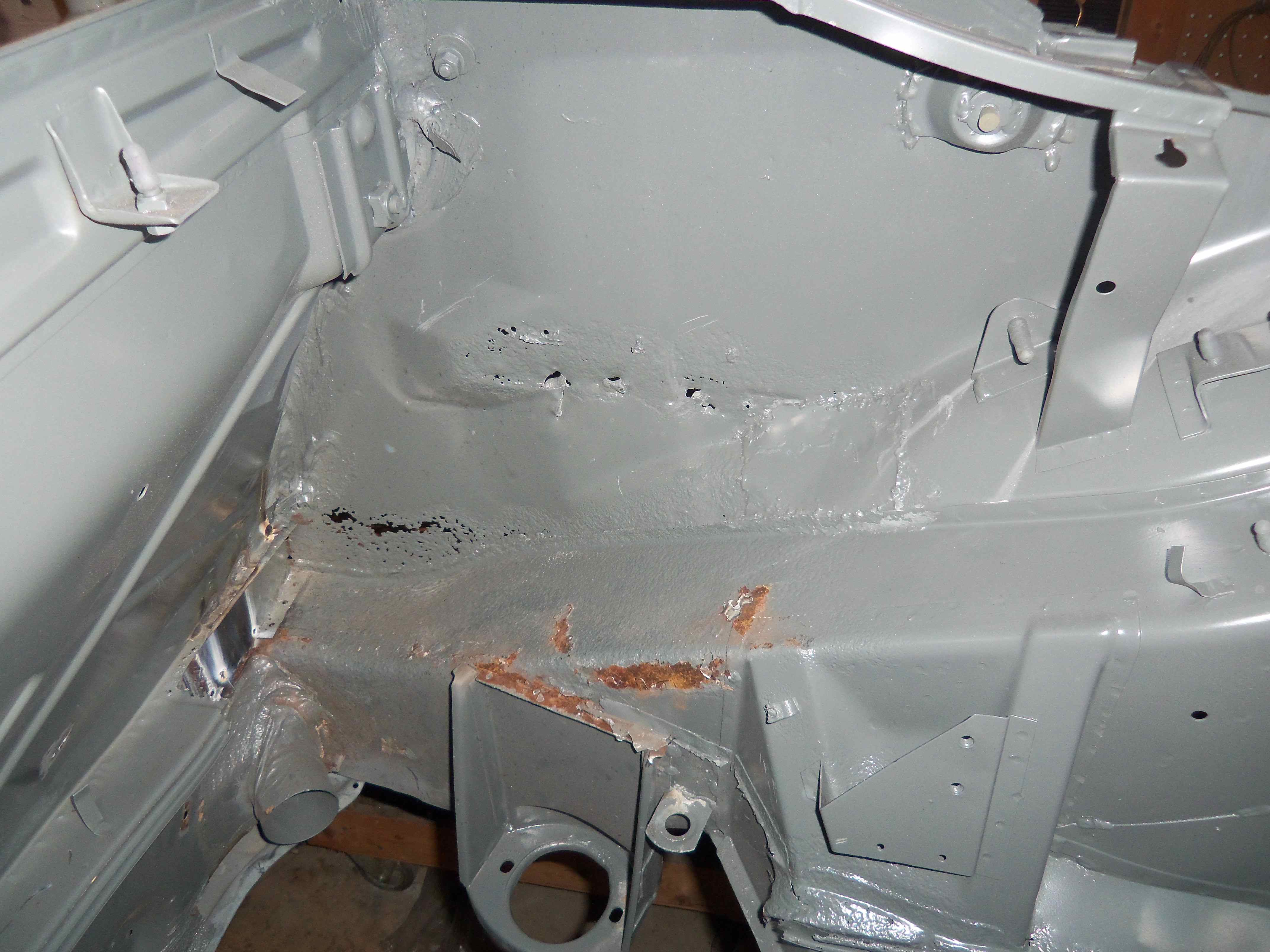

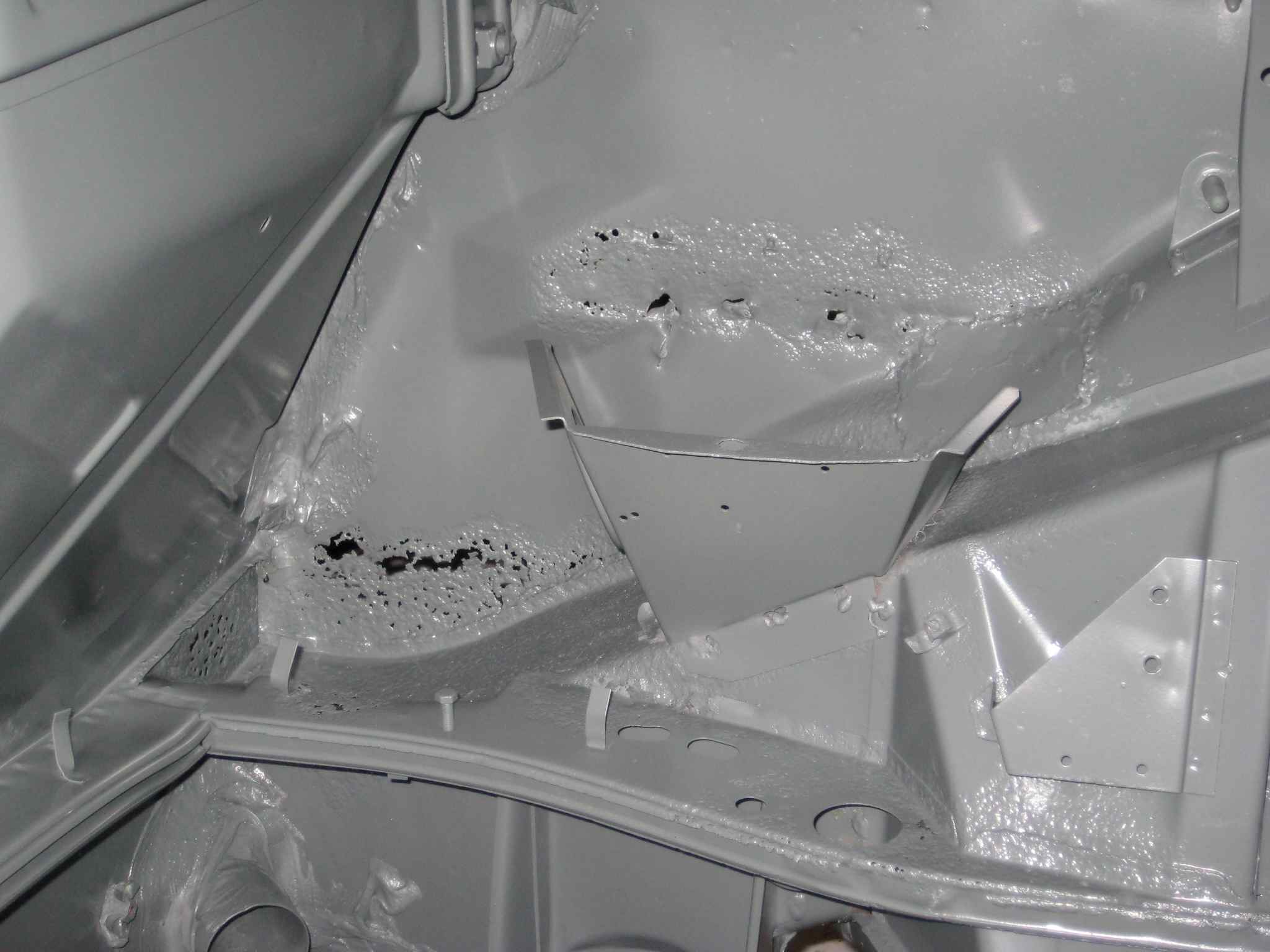

993inNC   looks great Doug! Is the rust on the pass lowe...   Feb 24 2012, 04:54 PM
dlee6204   looks great Doug! Is the rust on the pass low...   Feb 24 2012, 09:08 PM
993inNC   Cool, what's the other side look like? Hey BTW...   Feb 24 2012, 10:03 PM
dlee6204   No I keep remembering I need to do that and then...   Feb 24 2012, 10:08 PM
