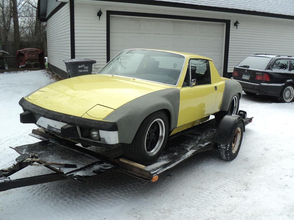

rick 918-S   The flares were too close to the tires so I raised...   Dec 24 2011, 12:28 AM
Dr Evil   Wow!   Dec 24 2011, 09:39 AM
914coop   Wow! :agree: WOW!!!!   Dec 24 2011, 10:21 AM
sixnotfour   This angle is :first:   Dec 24 2011, 11:27 AM
rick 918-S   Nader's Nightmare is going home! Nice day ...   Jan 14 2012, 10:54 AM
kevin311   Thats the first time I've seen a slant nose co...   Jan 14 2012, 11:02 AM
dlee6204   Nice job Rick!   Jan 14 2012, 11:05 AM
914coop   Nice job Rick! :agree: :worship: Can...   Jan 14 2012, 11:29 AM
carr914   Nader's Nightmare is going home! Nice day...   Jan 14 2012, 11:07 AM
rick 918-S   Nader's Nightmare is going home! Nice da...   Jan 15 2012, 05:06 PM
KELTY360   Never ceases to amaze me what I'll see @914Wor...   Jan 14 2012, 11:10 AM
914coop   Rick dropped the car off this afternoon, he went w...   Jan 14 2012, 05:20 PM
sixnotfour   Slope Nose Revival I wonder how some up side dow...   Jan 14 2012, 05:44 PM
