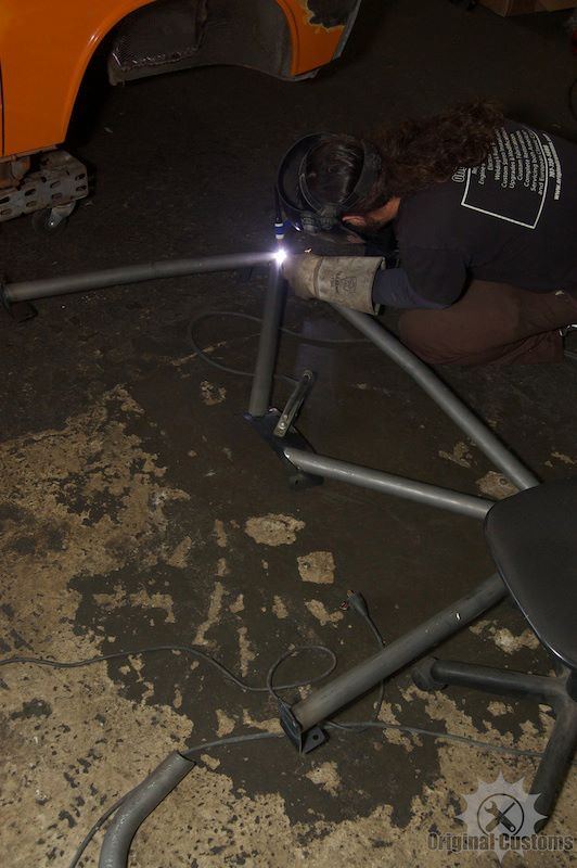

Did it look like this?
(stolen from the Original Customs Facebook page)

QUOTE(ConeDodger @ Jan 18 2012, 07:21 PM) *
Maybe ... (IMG:style_emoticons/default/happy11.gif)
