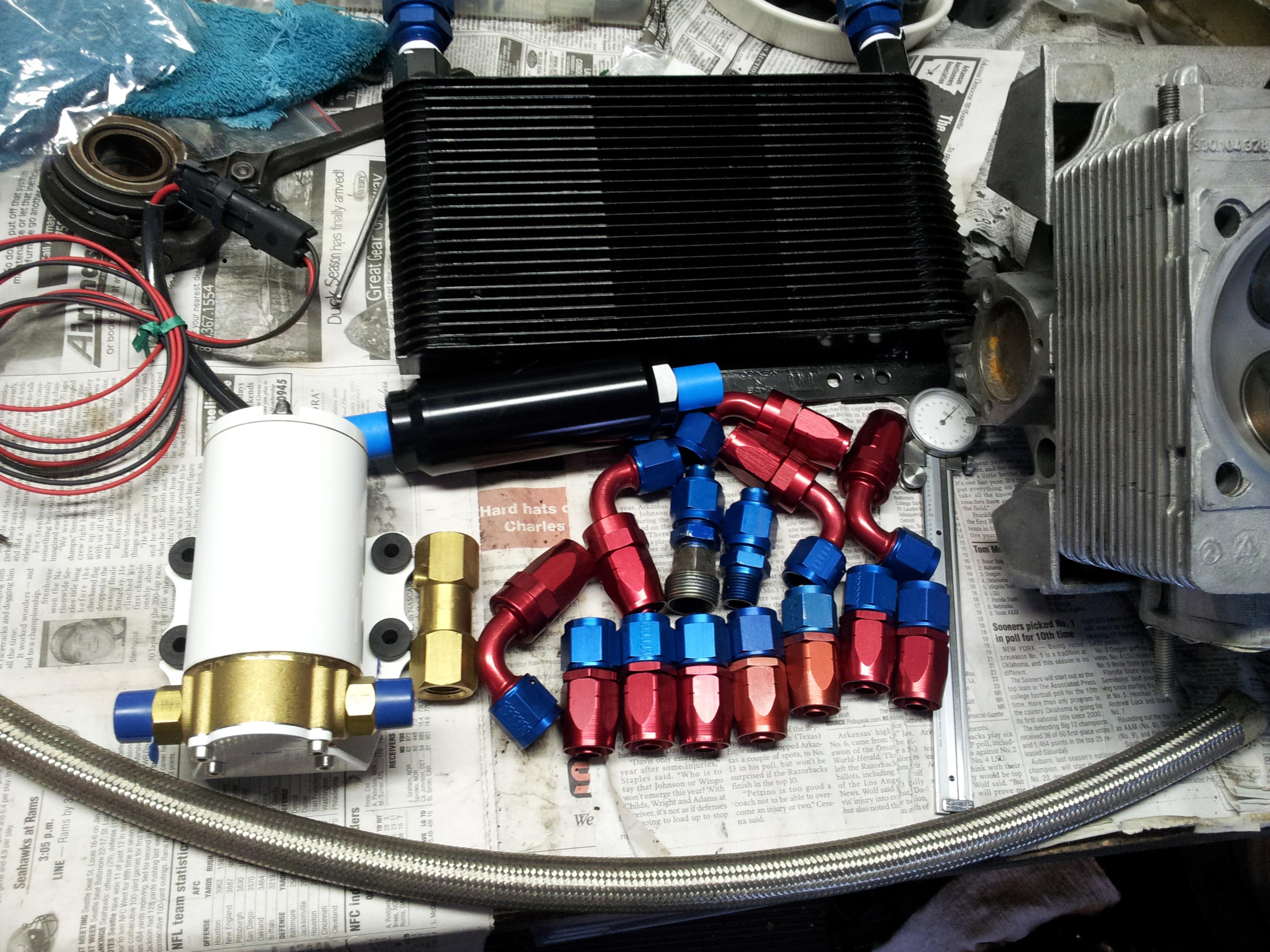

QUOTE(Randal @ Jan 20 2012, 08:36 PM) *
What is the breakdown of the $308 and do you have any PICTURES of something similar?
Here's a pic below, but some of the fittings, the Spal fan, and a catch-can and it's breather aren't shown. The breakdown is roughly this.
Hose fittings, hose, and adapters:
- 6 -8 mandrel-bent 90's
- 8 or 10 straight's
- 8 -8 adapters to 3/8 NPT
- 1 8 ft section of -8 hose
- 2 -6 straights
- 2 -6 mandrel-bent 90's
- 2 -6 adapters to 1/4 NPT
I'll probably add a couple of -8AN couplers since I found some other fittings I already have out there and the filter housing is already -8AN.
Notice that there is a -8 to 3/8NPT adapter fitted into the drain plug, which means there isn't a magnet in this system unless I want to attach one or two to the filter housing. I'm relying on the oil to carry the crud into the filter element. But I might also epoxy some strong neodymium magnets onto the case as well.
Everyone's gonna route their systems differently and the equipment will be different, so I wouldn't put to much stock in this list since it'll be specifically my install, but you're right. It's expensive, but it saves gearboxes.
