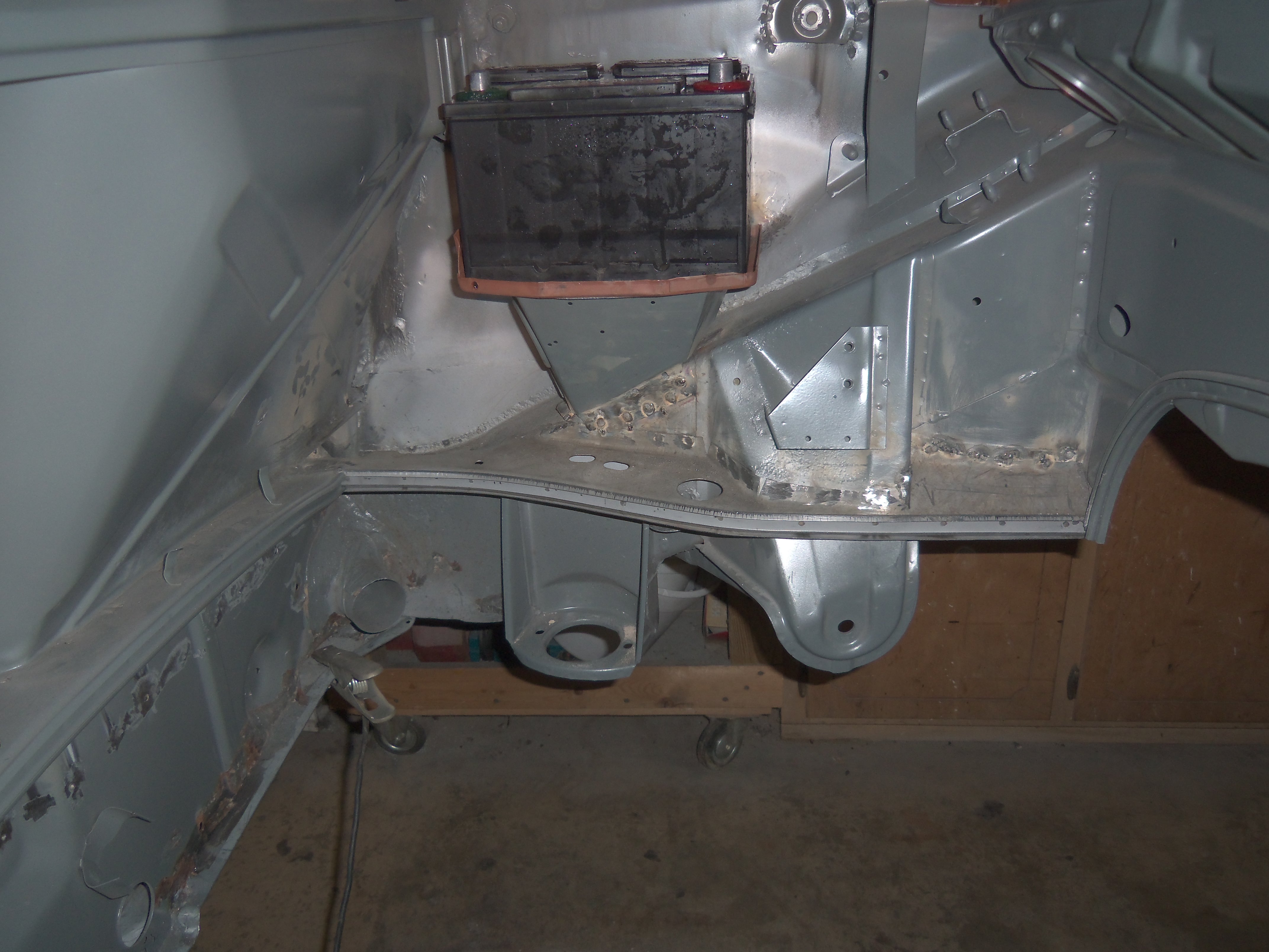

dlee6204   Update: Here is the corner of the firewall welded...   Dec 12 2011, 03:29 PM
dlee6204   I next moved onto the pass. long. Top layer o...   Dec 12 2011, 03:37 PM
dlee6204   Next came the driver's side long which was not...   Dec 12 2011, 03:43 PM
dlee6204   And for the record, I used 18 gauge steel. I...   Dec 12 2011, 03:51 PM

dlee6204   Update: I've been working on a lot of littl...   Feb 23 2012, 08:52 PM
dlee6204   The front trunk floor also has some thin metal wit...   Feb 23 2012, 08:58 PM
dlee6204   I did some work on the lower firewall too. ...   Feb 23 2012, 09:12 PM
dlee6204   Oh and who says there aren't enough spot welds...   Feb 23 2012, 09:14 PM
