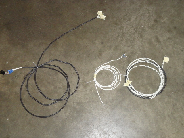

Saturday I made some progress on the BA4 heater install and the dash gauges.
I spent some time making 3 wiring harnesses; L - BA4 dash switch harness, C - Speedo trans pick-up harness, and R - engine gauges harness (tach, oil temp/pressure and volt). I ran out of shrink-tube, so I'll have to finish these later in the week or next weekend.
(IMG:http://www.914world.com/bbs2/uploads_offsite/images.thesamba.com-9730-1327295395.1.jpg)

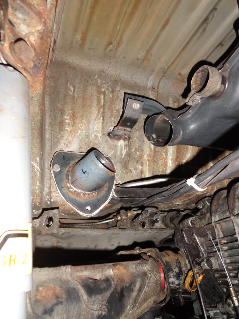

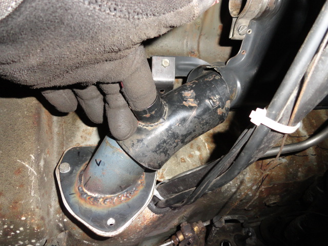

Next I made a pair of these body adapters for the inlet air from the heater. I also modified a factory mount for the BA4 outlet air temp sensor to fit. This will be held with flex tube or possibly silicone stubs. It fits better than it appears to in the photo. (IMG:style_emoticons/default/laugh.gif)
(IMG:http://www.914world.com/bbs2/uploads_offsite/images.thesamba.com-9730-1327295396.2.jpg)
(IMG:http://www.914world.com/bbs2/uploads_offsite/images.thesamba.com-9730-1327295397.3.jpg)
