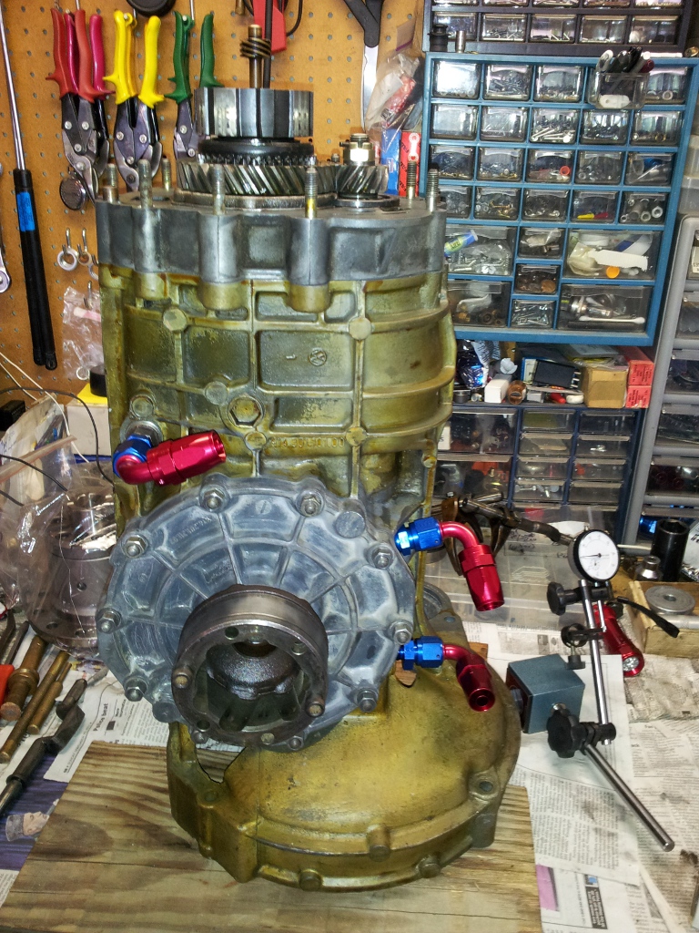

pcar916   Finally time for an update. I forced myself off of...   Jul 10 2012, 11:19 AM
pcar916   The engine compartment plumbed and the temperature...   Jul 10 2012, 11:23 AM
