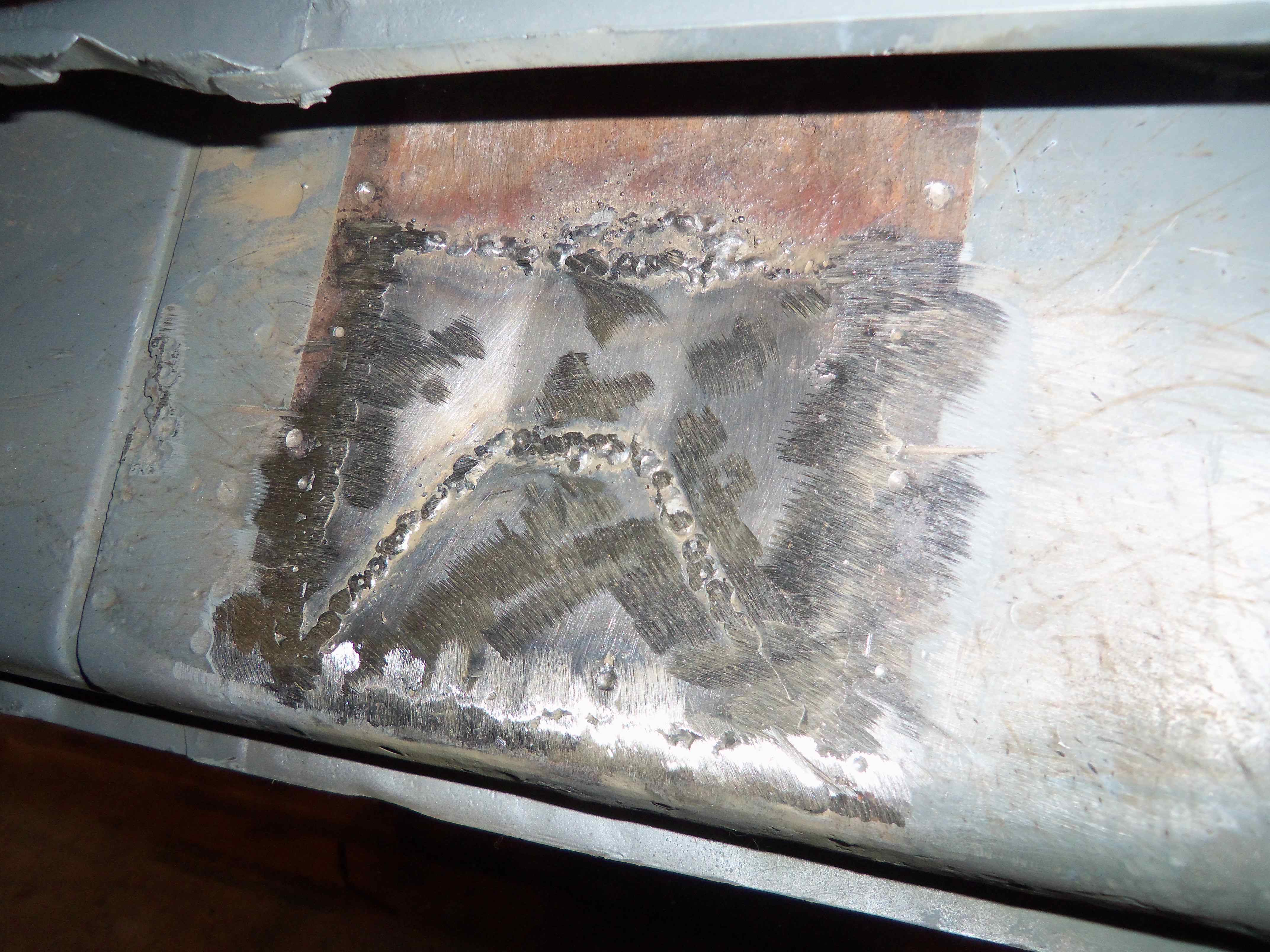

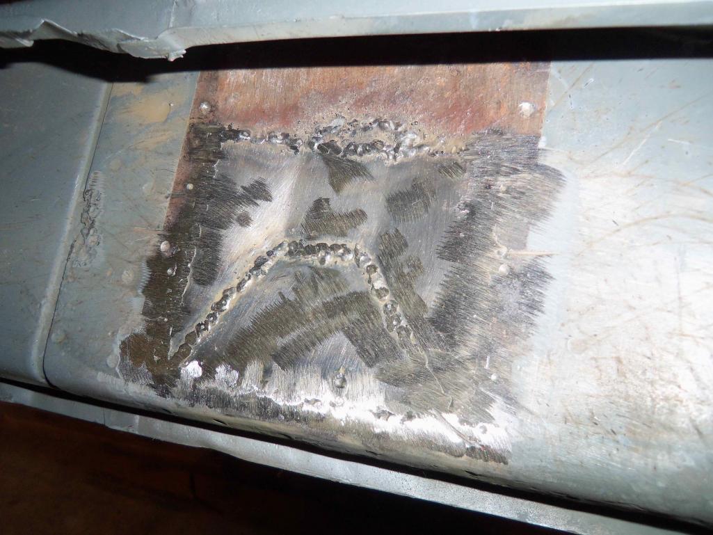

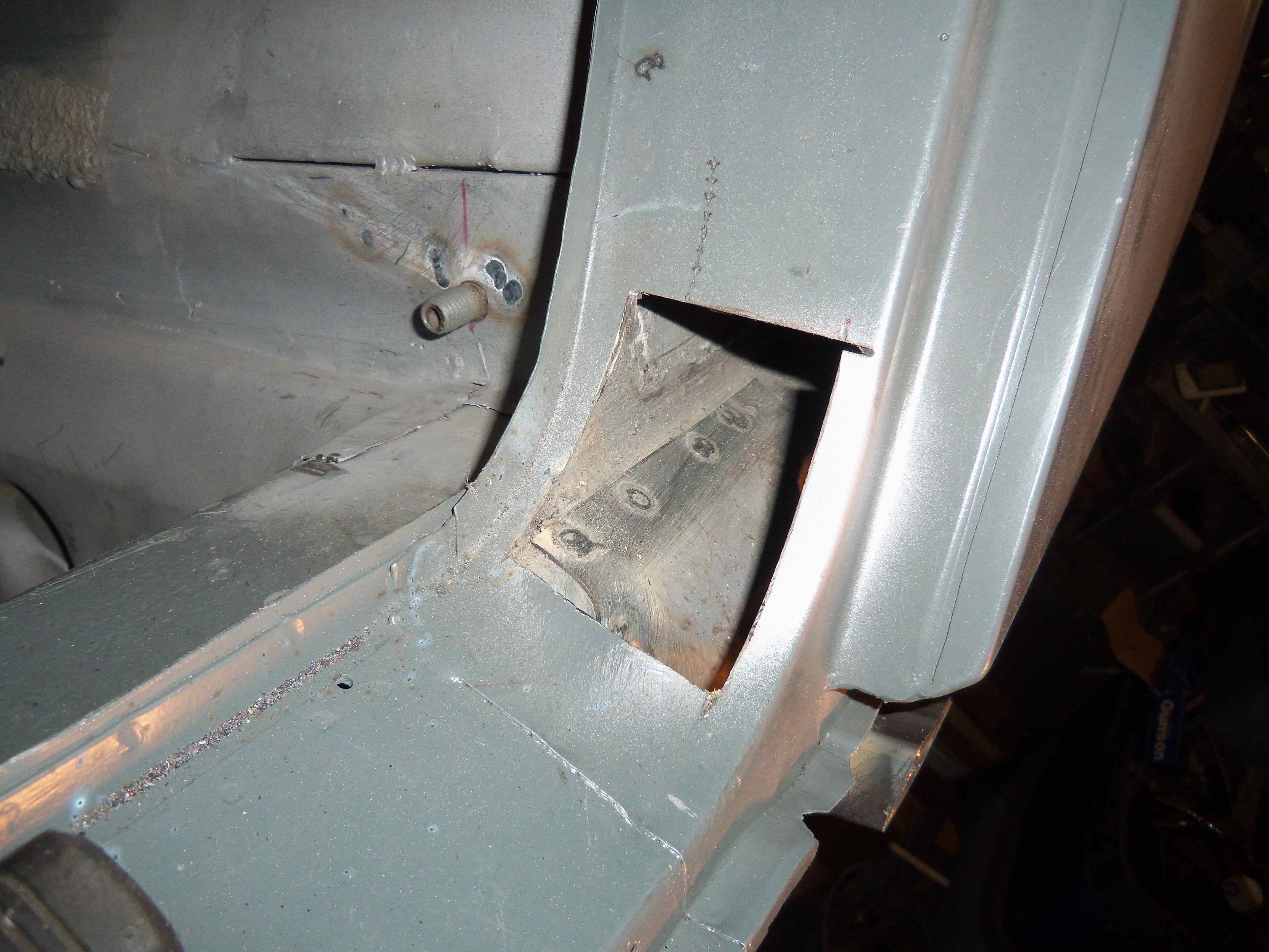

Got some more work done today. I got the jack points installed on both sides. The sub-metal needed to be replaced before I could weld in the new pieces so it took some time.
I cut out a small piece from the door jamb to gain better access to the top.

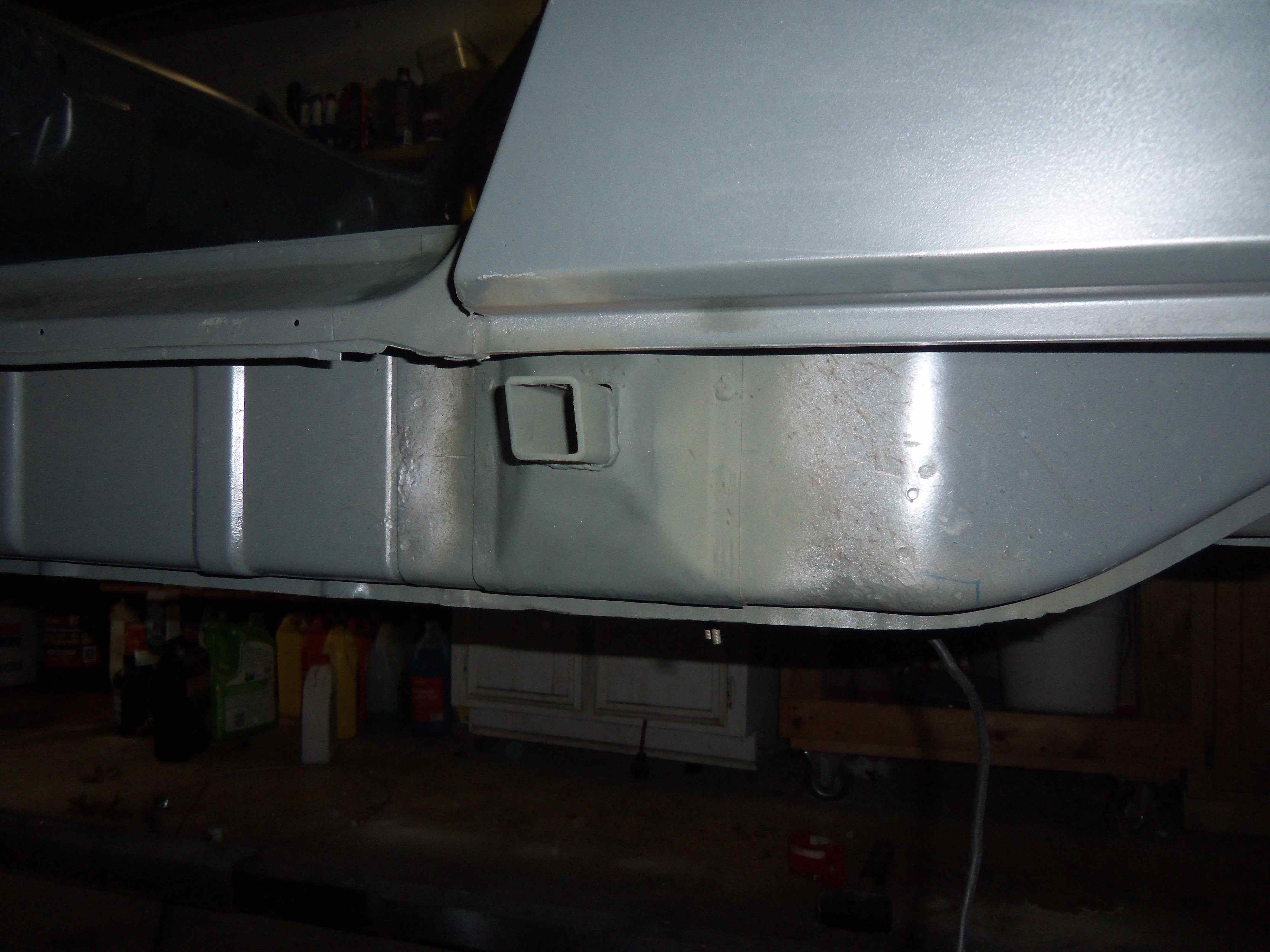

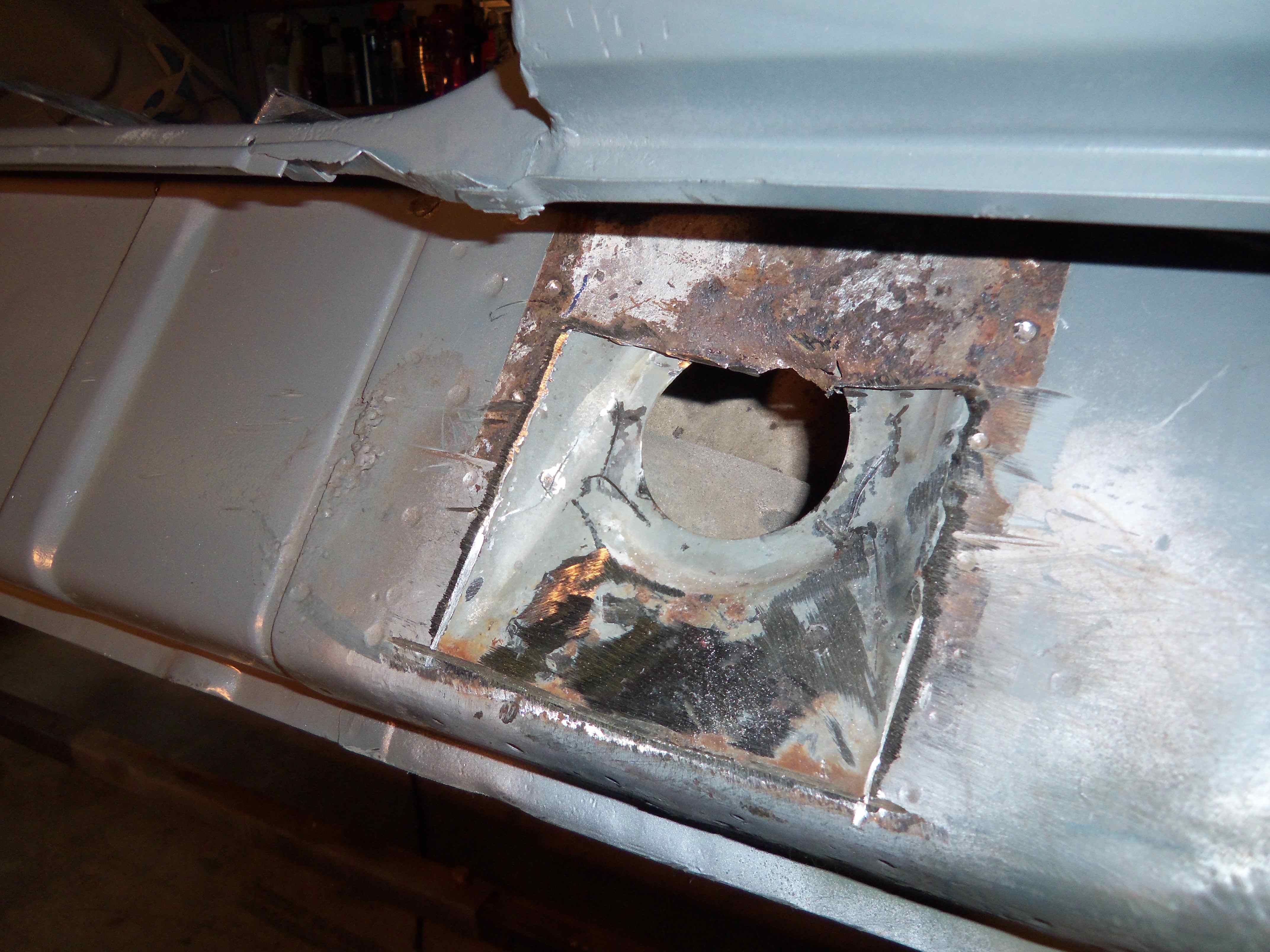

dlee6204   Got some more work done today. I got the jack poi...   Feb 4 2012, 03:49 PM
dlee6204   The story was the same for the other side...   Feb 4 2012, 03:51 PM
