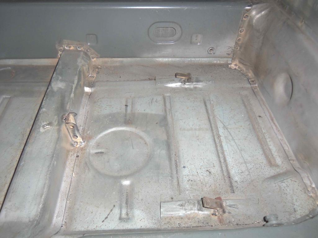

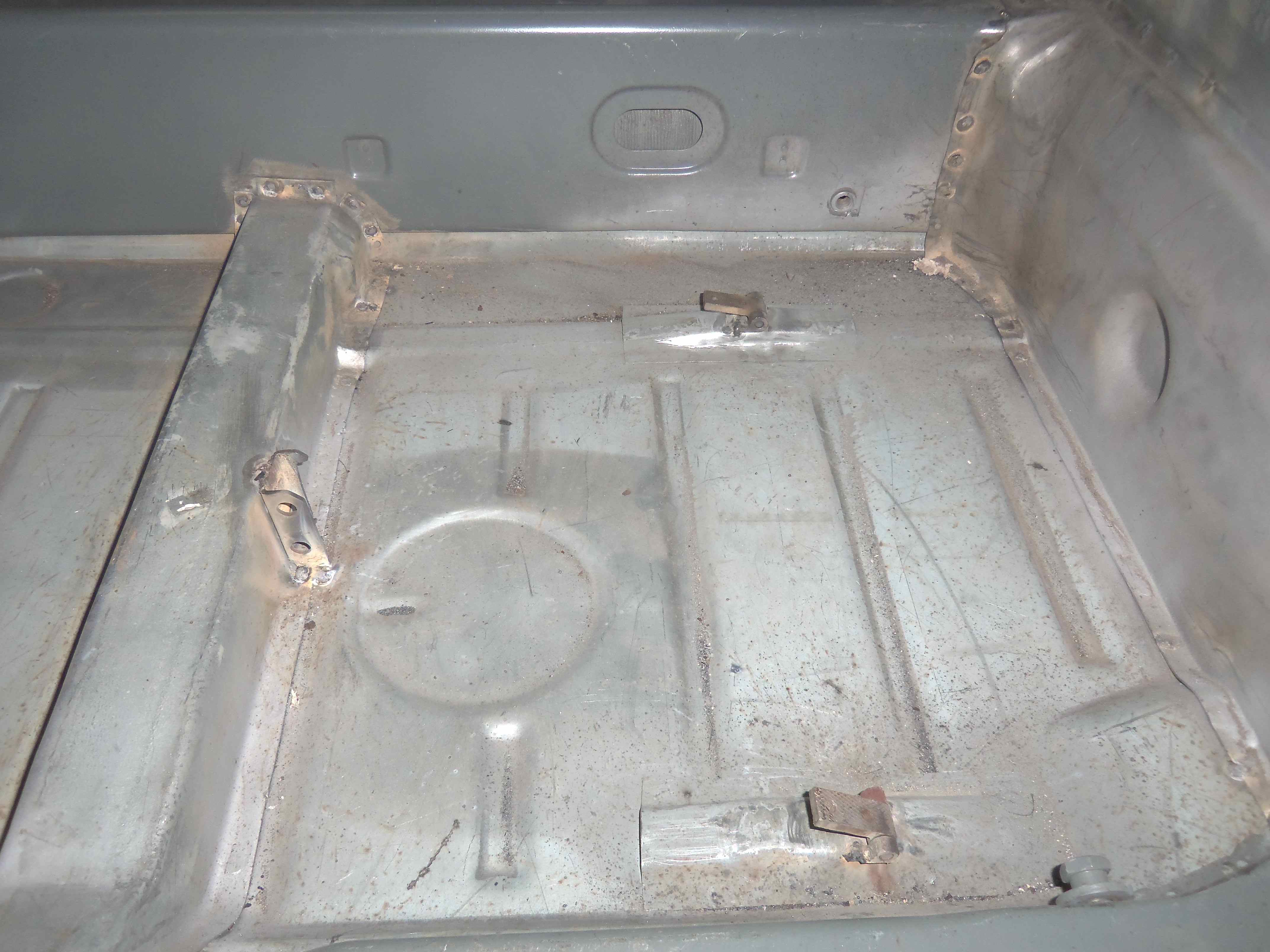

dlee6204   Got some more work done today. I got the jack poi...   Feb 4 2012, 03:49 PM
dlee6204   The story was the same for the other side...   Feb 4 2012, 03:51 PM
Germancar-Junkie   Ohhhhh, so that's what a long is supposed to l...   Feb 4 2012, 06:57 PM

saigon71   Lookin good man! Like the idea of cutting a f...   Feb 5 2012, 10:34 PM
