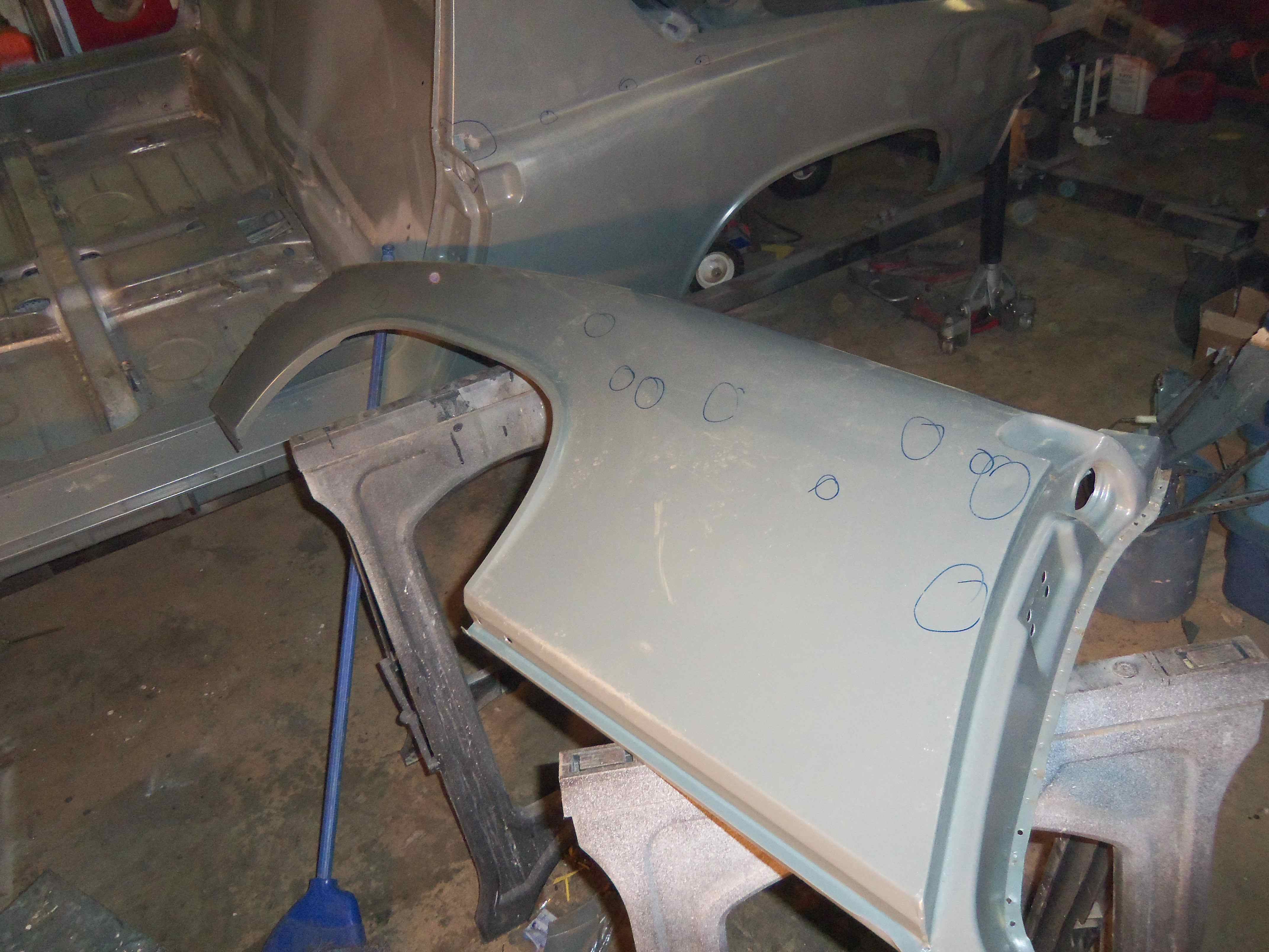

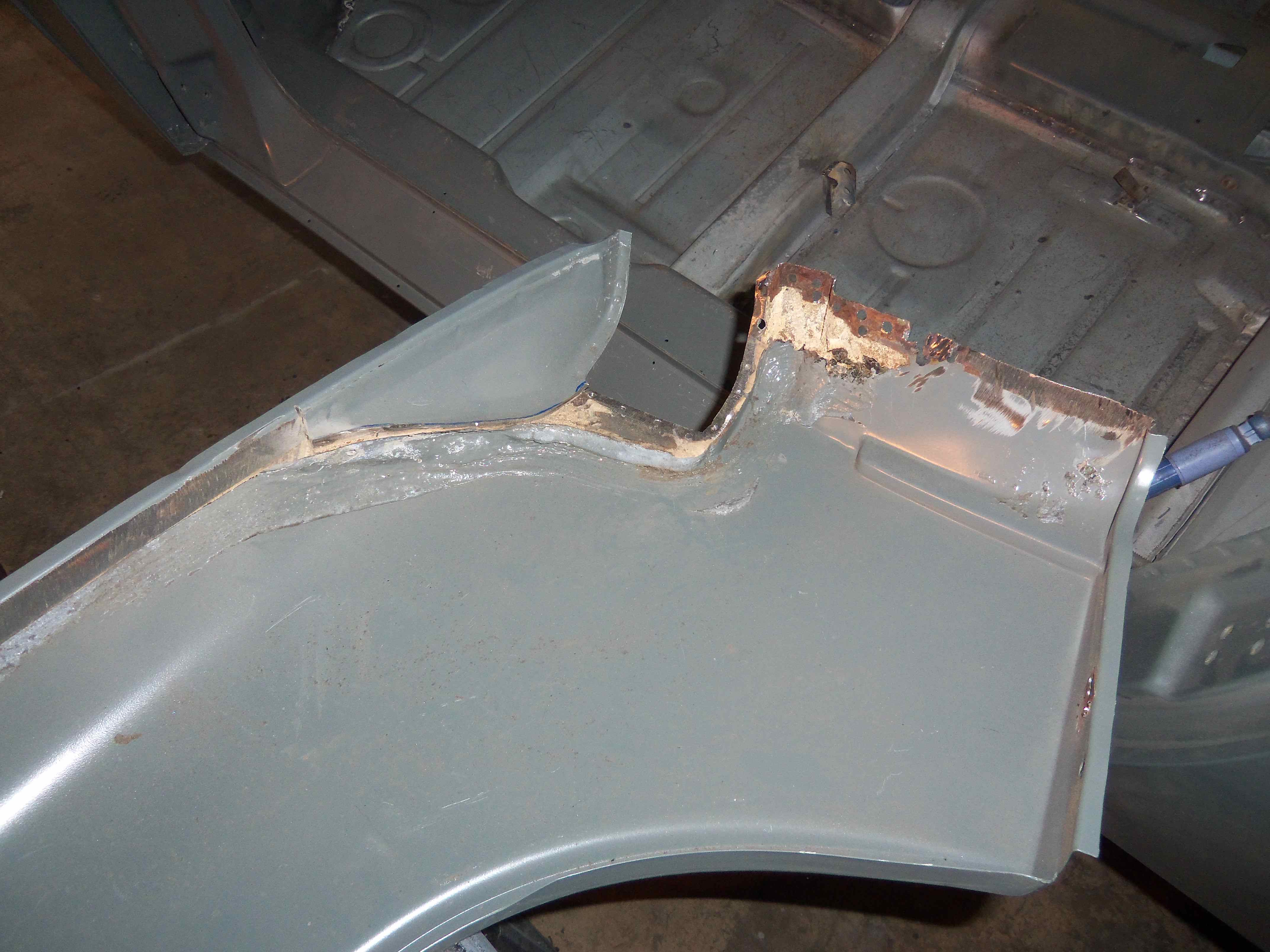

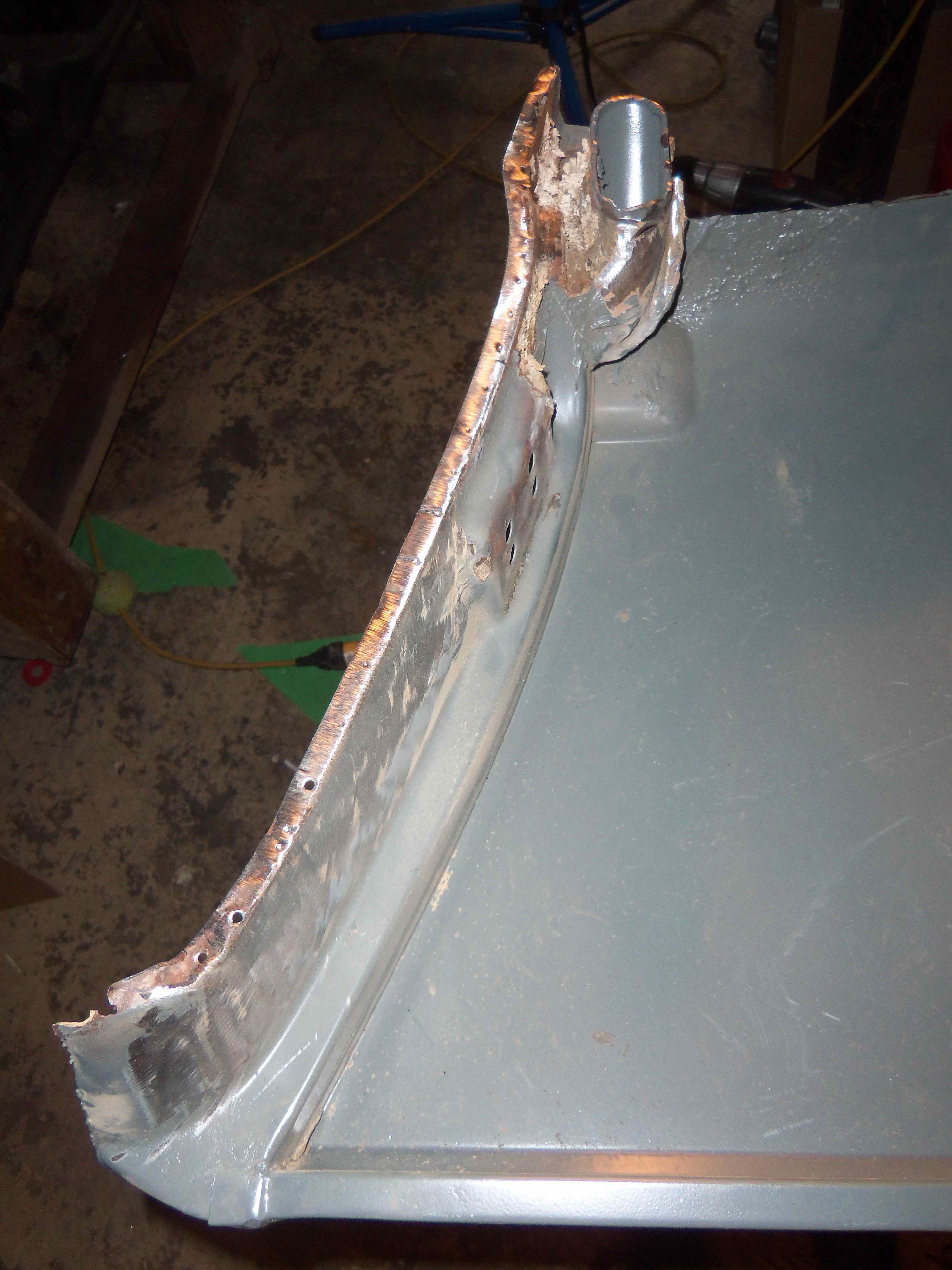

I also spent quite a bit of time prepping the replacement rear fender. There was plenty of extra meat around the edges from where it was cut off the donor car that I had to remove. Just a little more trimming and it will be ready to go back on.

dlee6204   I also spent quite a bit of time prepping the repl...   Feb 5 2012, 09:37 PM
