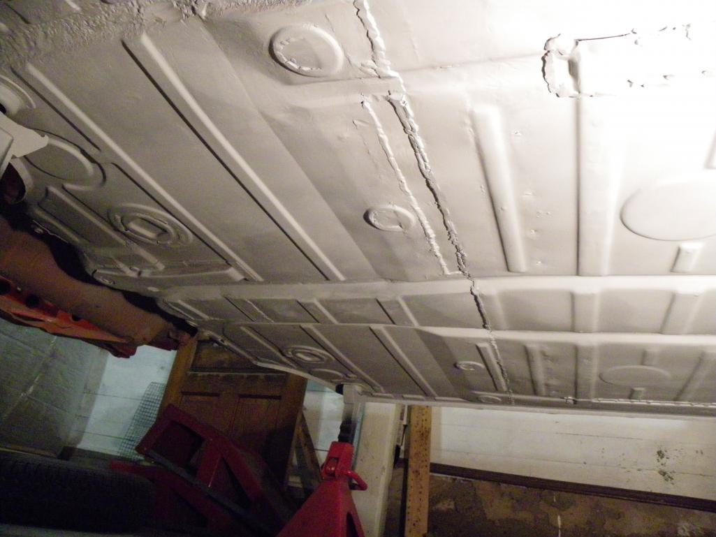

Well.. Its been a little bit but I've gotten some more work done.. cleaned off the undercoating from the front floor pan and found some more perforation. Not too bad so I just bent up a couple patches and welded them in. Ground down the welds a bit. Not all the way but at least enough so that they aren't too big. I'm still new at welding and I have to perfect my skills so I don't have to grind so much down after ...
I'm on holidays this week and have been told that I can spend the whole week working on the car, as long as I get my eldest daughter off to the school bus stop in the morning... My 8 month pregnant wife is amazingly supportive of me restoring my 914 ( I'm contractually obligated to state this (IMG:style_emoticons/default/smile.gif) )
I painted the underside the floor with some epoxy primer today. Got the garage/barn up to temp, turned the kerosene heaters off and sprayed. Waited a bit until the paint flashed off and opened the bay door a bit , turned on the fan to blast the fumes out. Closed it back up and turned on the heaters back to temp.
I don't have the room for a rotisserie so I'm now painting on my back. Its easier than drilling out spot welds and welding in floor pans on my back, thats for sure. I couldn't get far enough away as I'd like so I have a few drips but I'm not too concerned since its just getting undercoating once its ready.
