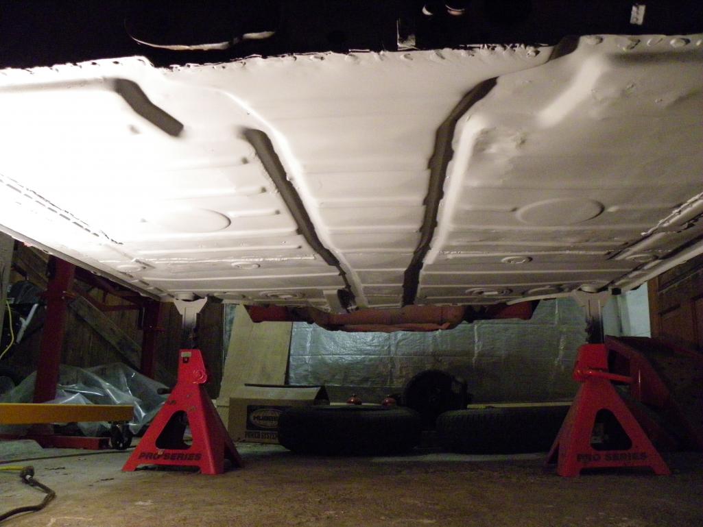

MrHyde   Undercoating down... shutz gun gets EVERYWHERE.. u...   Feb 9 2012, 05:56 PM

MrHyde   Forgot to take pictures of the patches and fixes i...   Feb 11 2012, 10:12 PM
