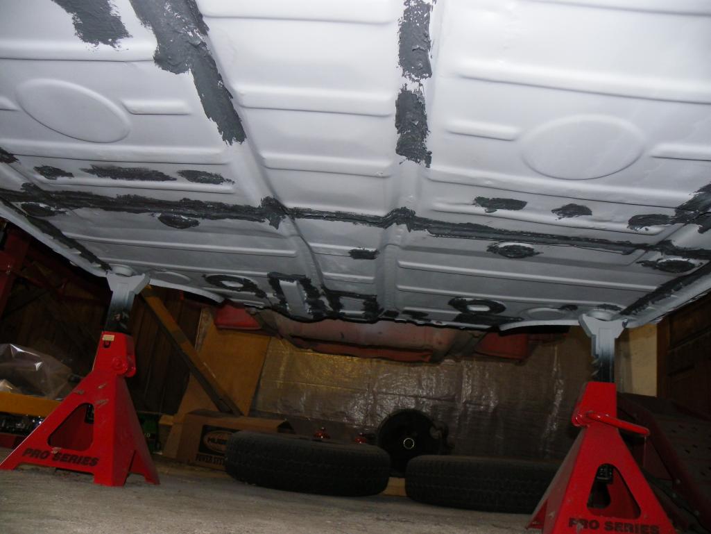

Got the seam sealer on the floor pan and another coat of primer overtop
