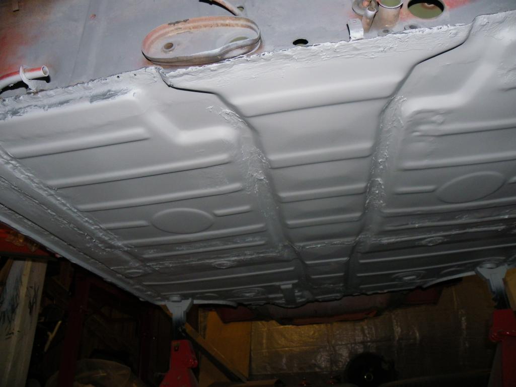

MrHyde   Got the seam sealer on the floor pan and another c...   Feb 9 2012, 06:52 AM
