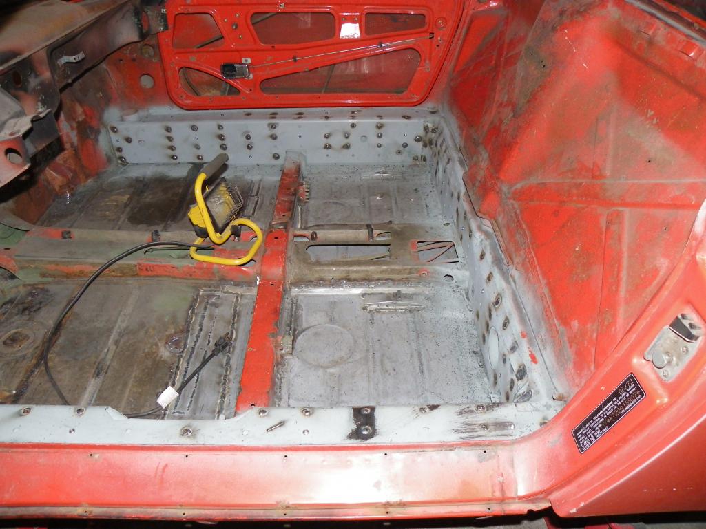

MrHyde   Got the seam sealer on the floor pan and another c...   Feb 9 2012, 06:52 AM

MrHyde   Undercoating down... shutz gun gets EVERYWHERE.. u...   Feb 9 2012, 05:56 PM
MrHyde   Started taking off the paint on the interior. Hope...   Feb 9 2012, 05:57 PM
