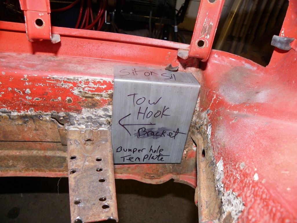

Made a template to put the left bumper mount holes back in once I replace the sheep metal there and make a new bumper mount bracket.
