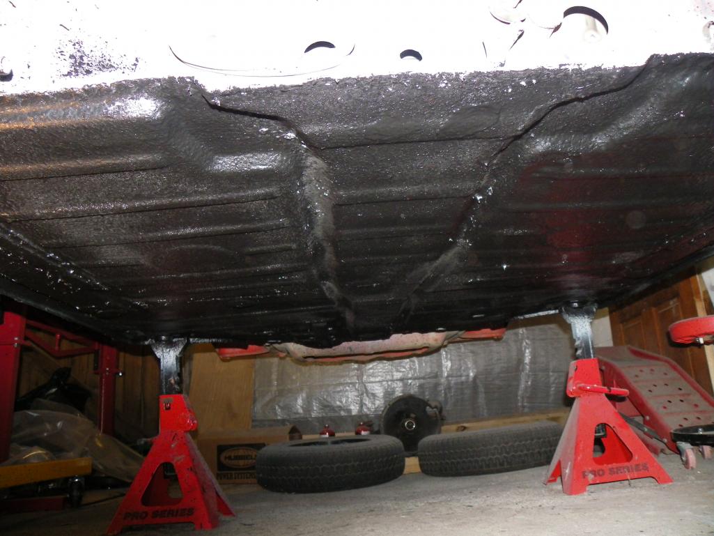

Undercoating down... shutz gun gets EVERYWHERE.. ugh..
I think I might have to do a bit of touch-up on it tomorrow though.
