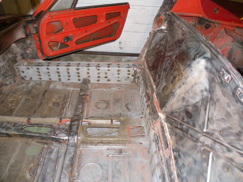

MrHyde   Started taking off the paint on the interior. Hope...   Feb 9 2012, 05:57 PM
MrHyde   Forgot to take pictures of the patches and fixes i...   Feb 11 2012, 10:12 PM
