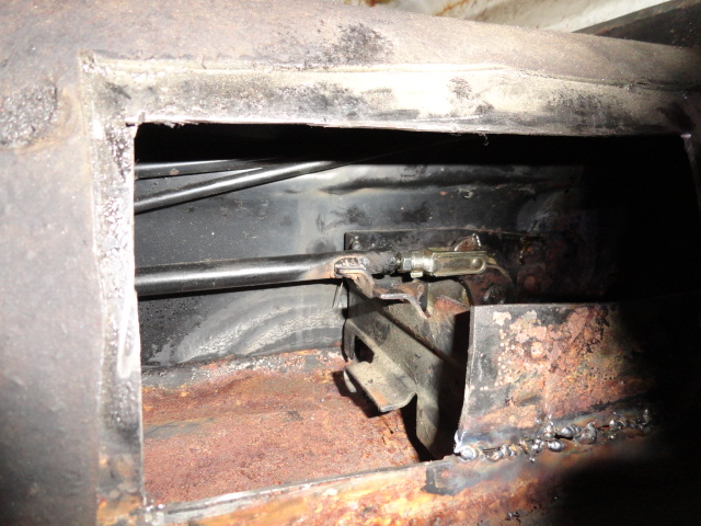

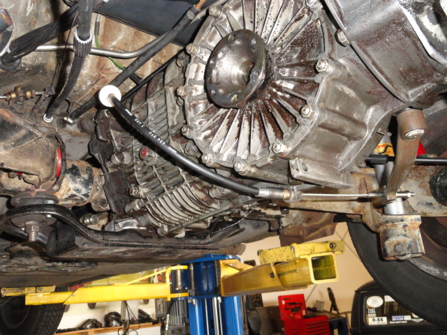

A few days ago I got my custom clutch cable from the cable maker. . . I had them add 17.5" to a stock 912E cable assembly (well actually they made an entirely new cable and just reused the stock bowden tube). It looks just like stock but ended up being just a bit too long (D'oh)!! (IMG:style_emoticons/default/headbang.gif) Well, for now, I made a simple spacer to go between the end of the bowden tube and the trans and I'm able to get full motion form the clutch and it feels like a stock clutch!! When everything else is done, I'm going to have another cable made a total of 16" longer than stock and that should be PERFECT. The custom cable was surprisingly cheap!!
This is the pedal end of the cable using the Porsche clevis and pin in the stock VW pedal hook.
(IMG:http://www.914world.com/bbs2/uploads_offsite/images.thesamba.com-9730-1329455874.1.jpg)
Here the Porsche 912E clutch cable bowden tube fits like stock in a type-3. (note my 1" extension for the bowden tube just before the trans case)
(IMG:http://www.914world.com/bbs2/uploads_offsite/images.thesamba.com-9730-1329455875.2.jpg)
