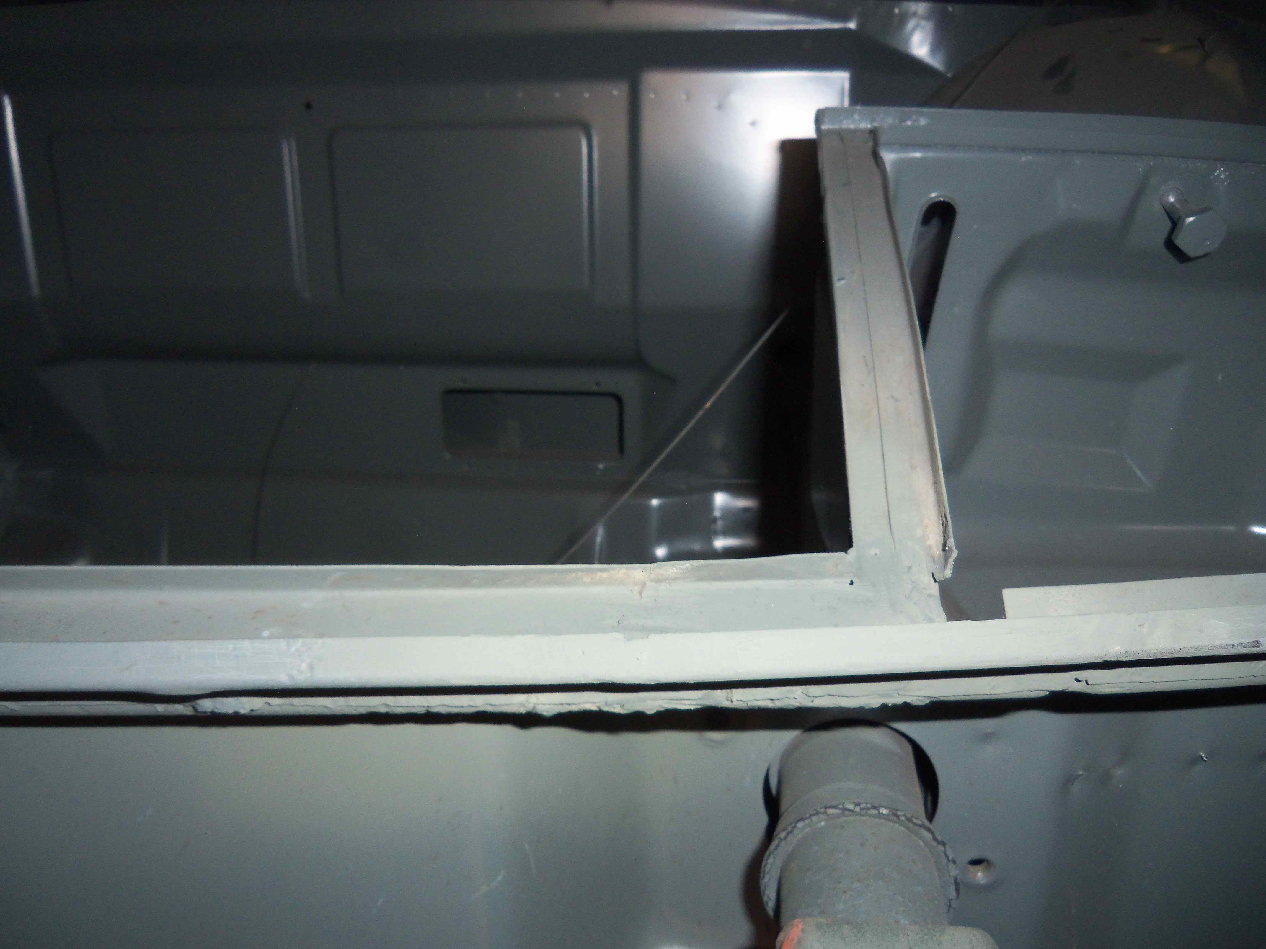

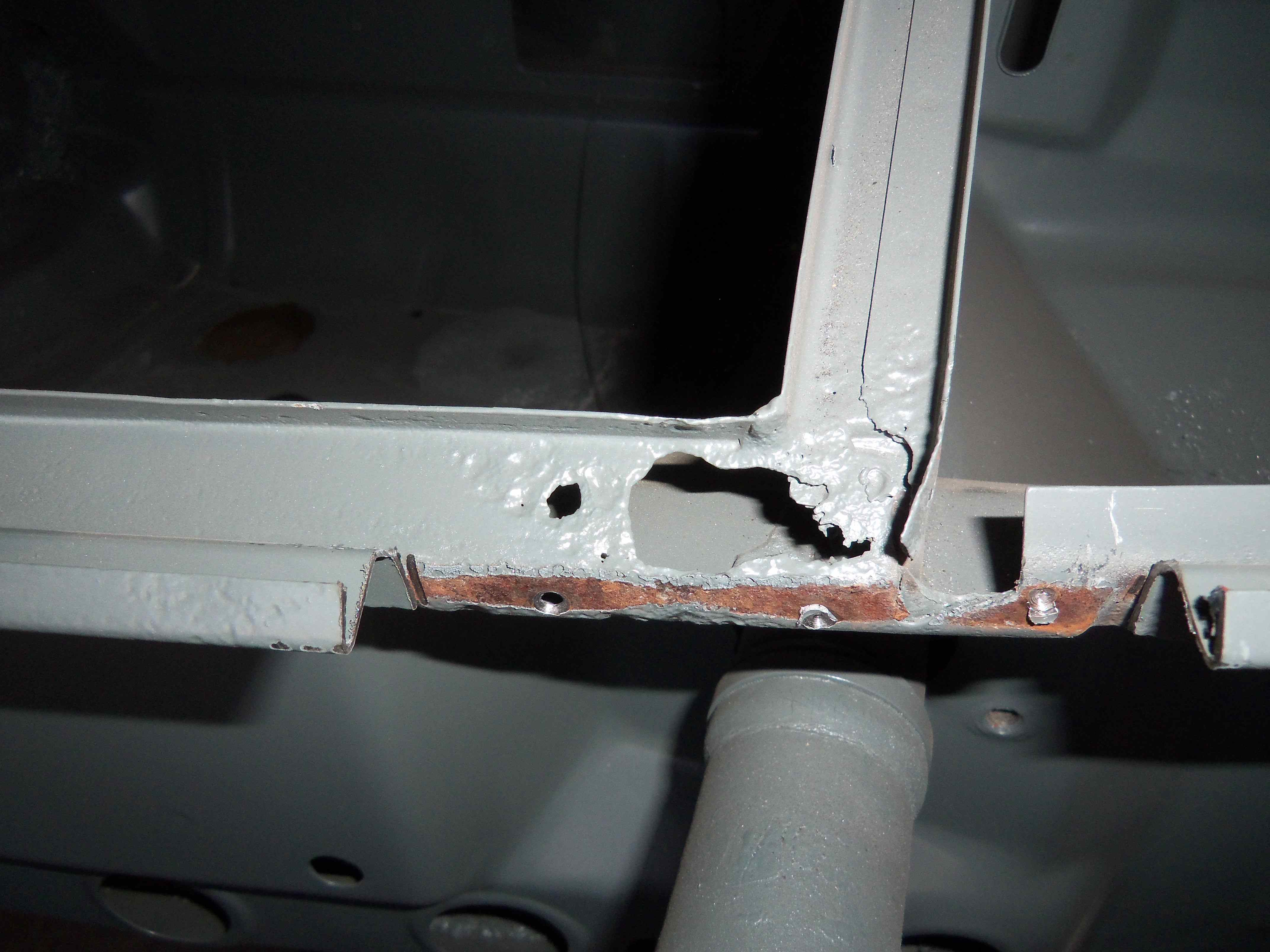

Update:
I've been working on a lot of little things lately. The front weatherstrip channel needed a little work so I took care of that.
