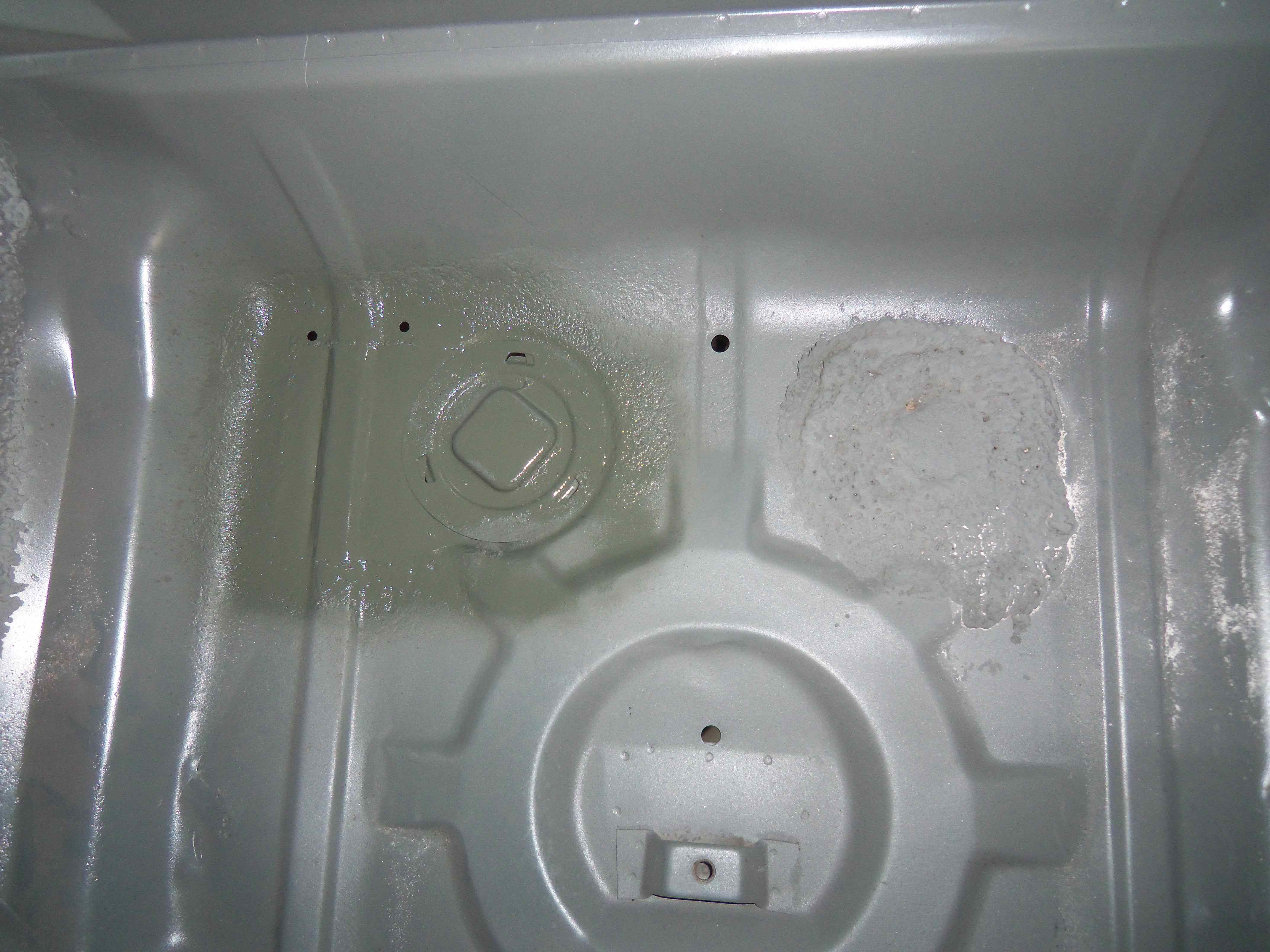

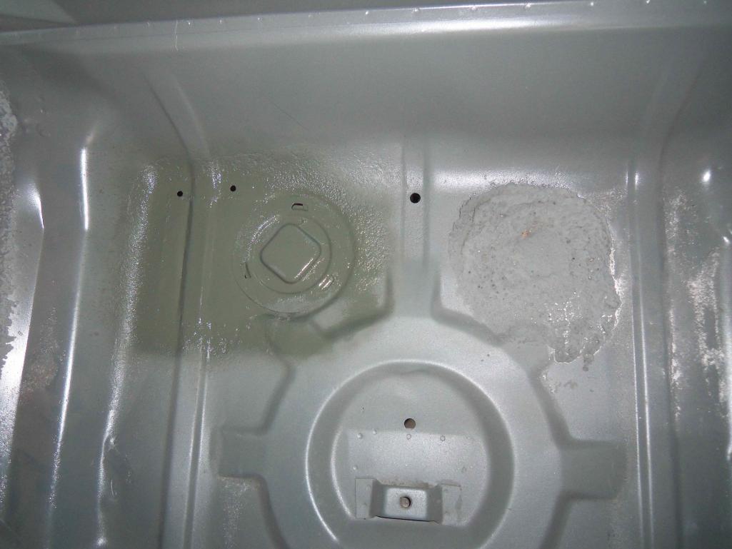

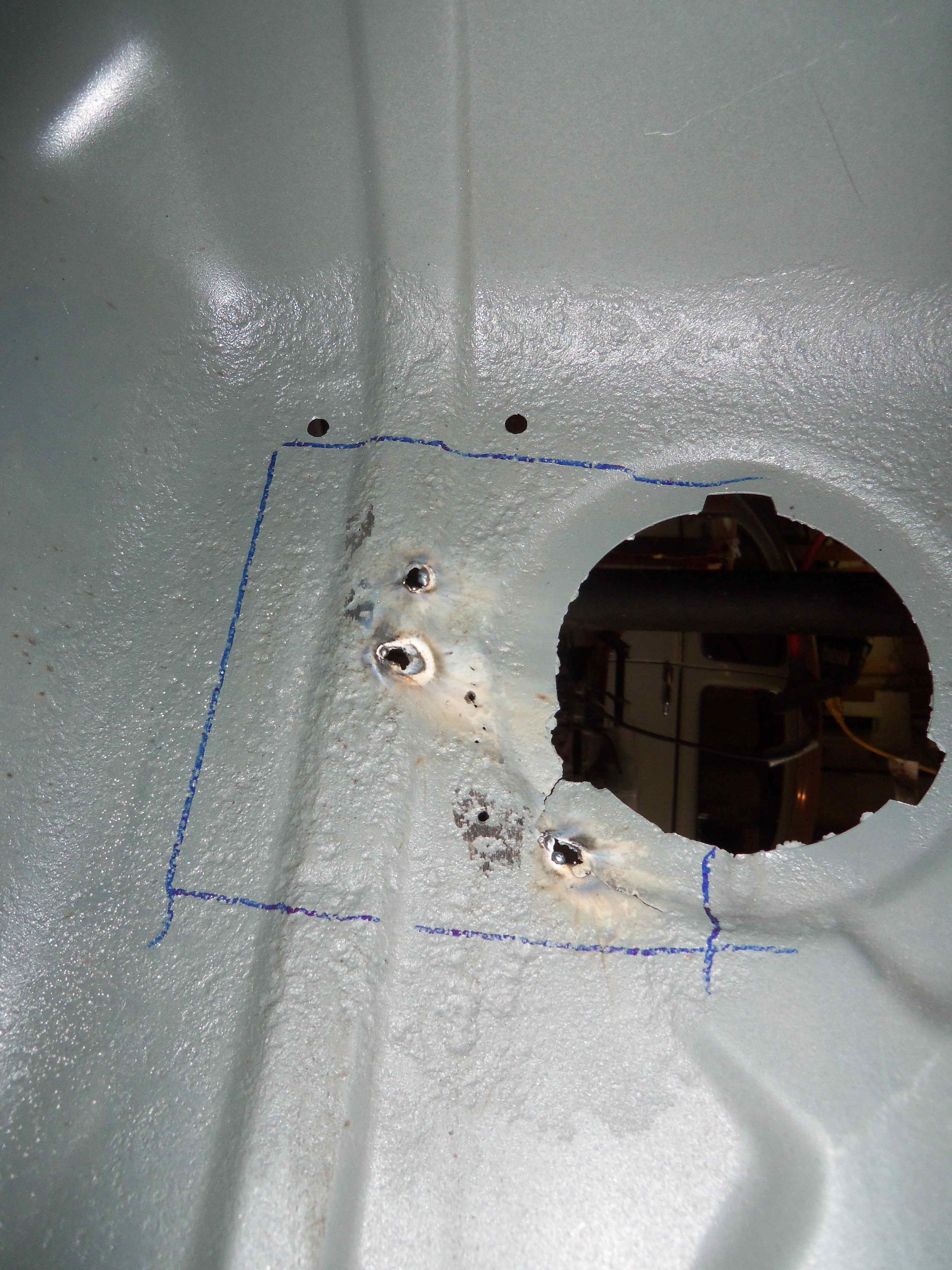

dlee6204   Update: I've been working on a lot of littl...   Feb 23 2012, 08:52 PM
dlee6204   The front trunk floor also has some thin metal wit...   Feb 23 2012, 08:58 PM

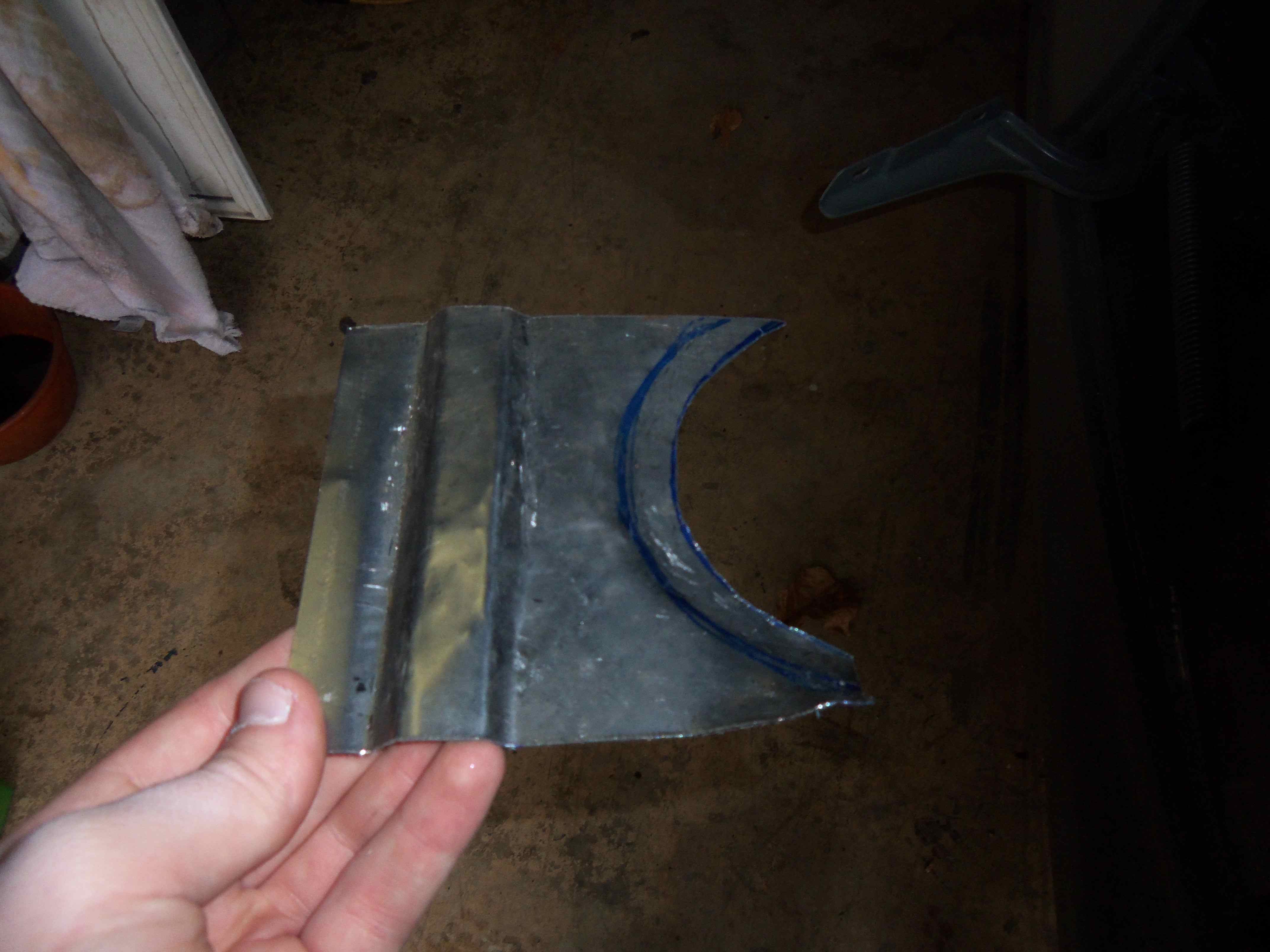

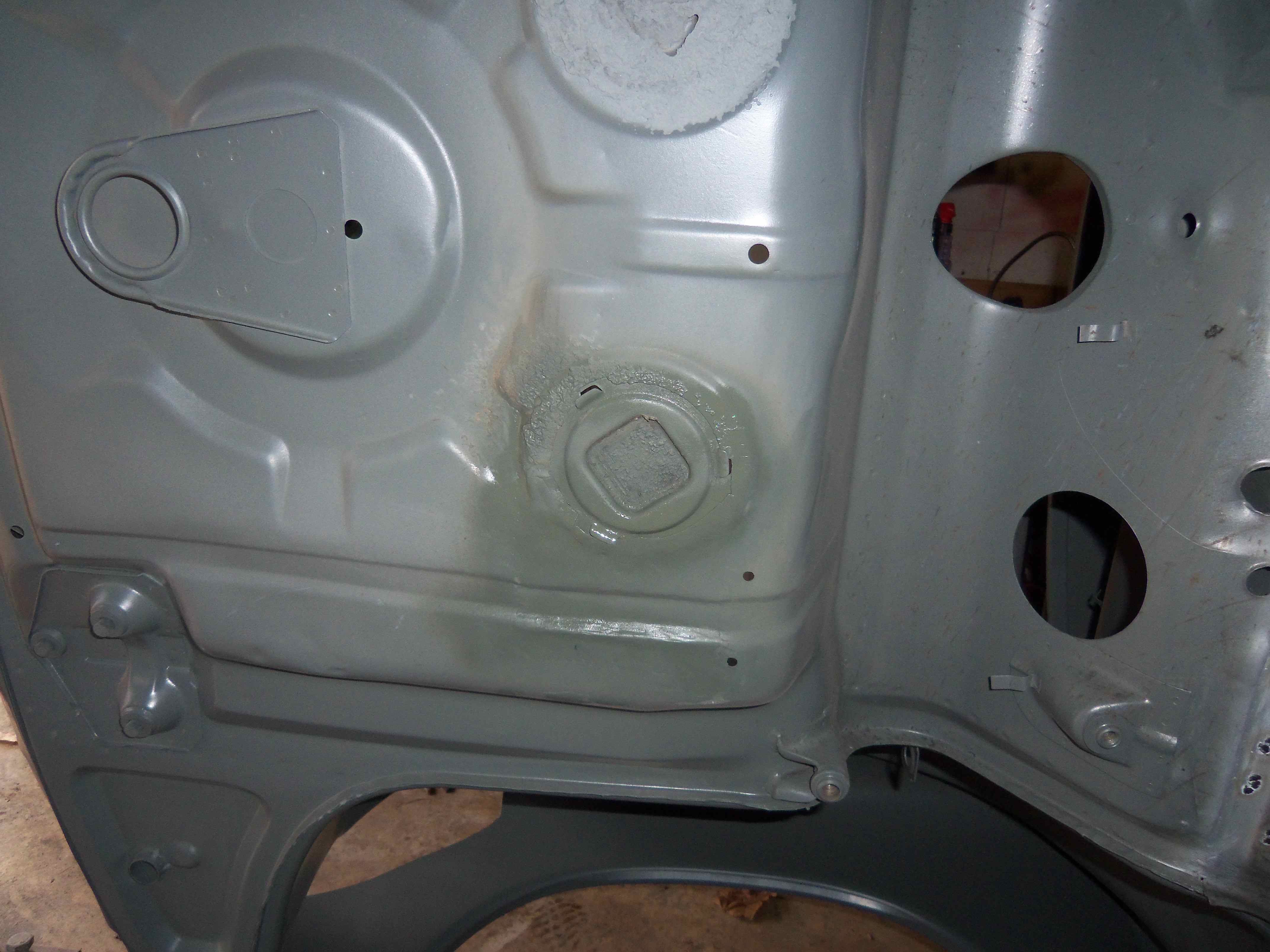

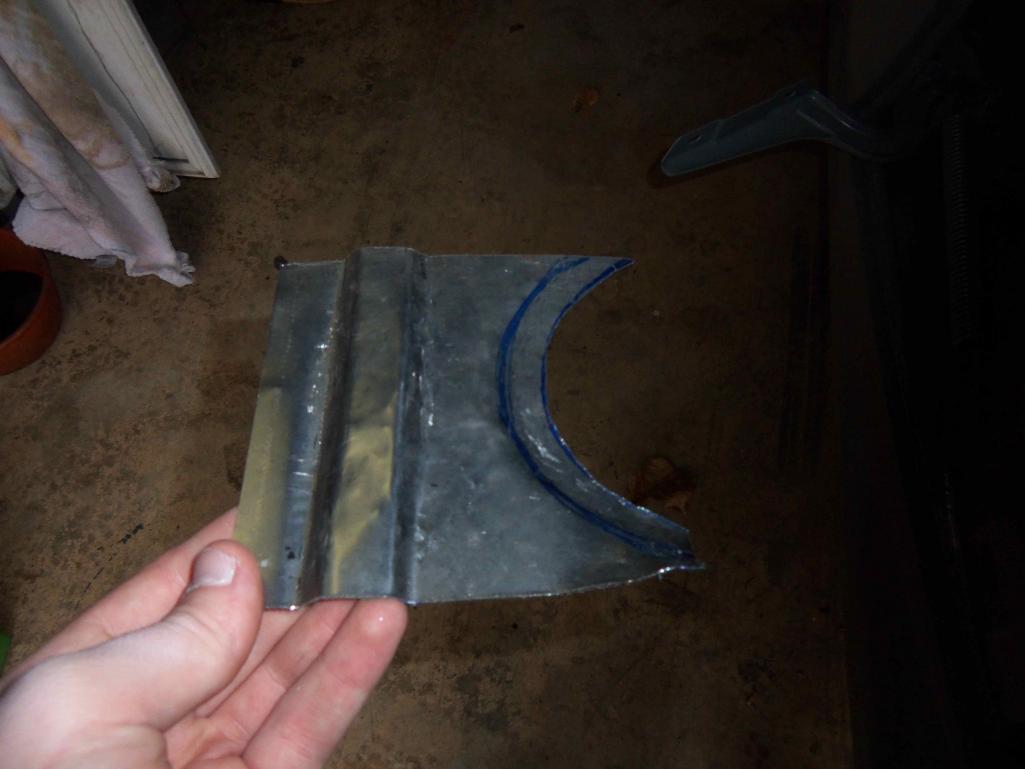

dlee6204   I did some work on the lower firewall too. ...   Feb 23 2012, 09:12 PM
