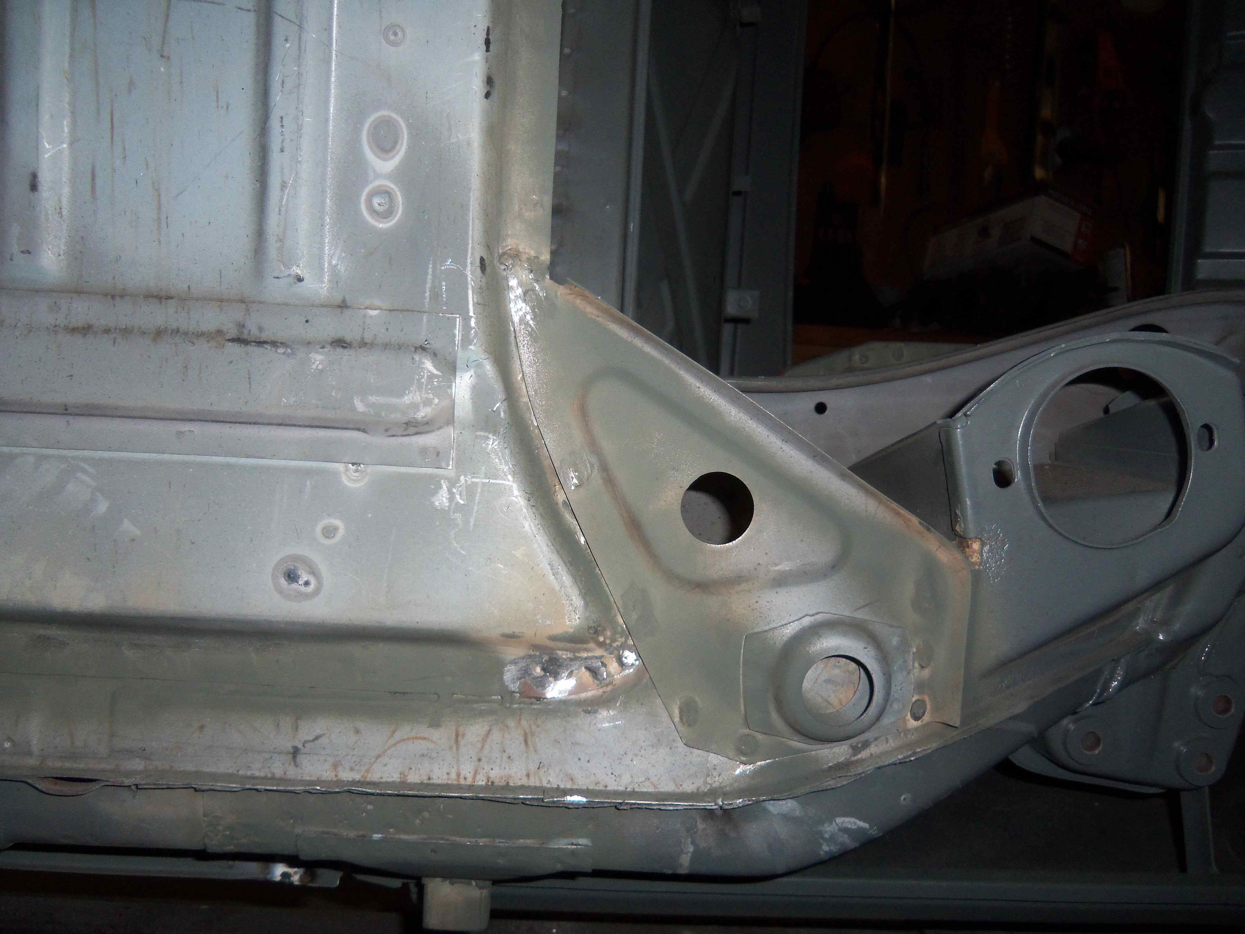

dlee6204   Got some more work done today. I got the jack poi...   Feb 4 2012, 03:49 PM
dlee6204   The story was the same for the other side...   Feb 4 2012, 03:51 PM

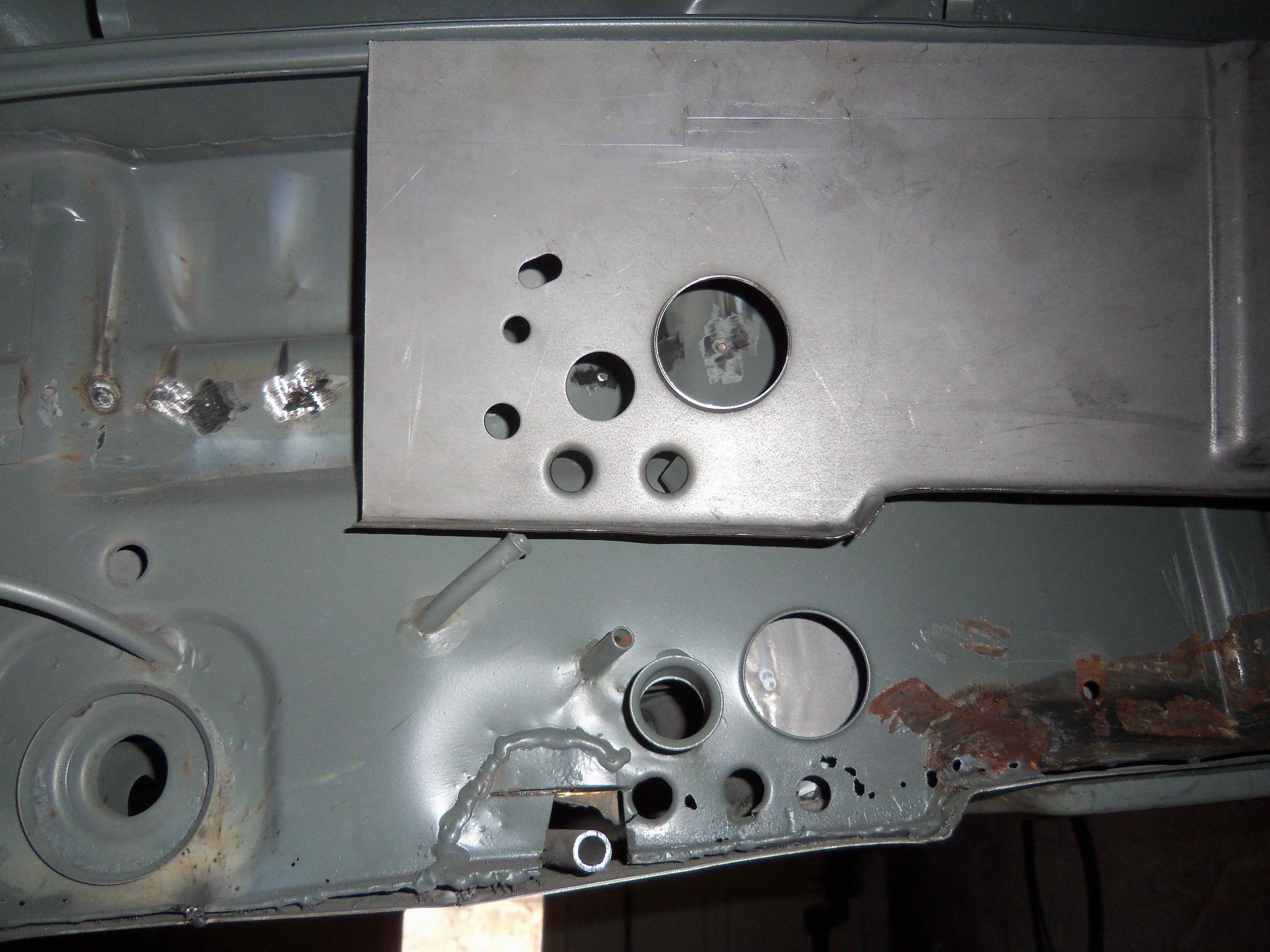

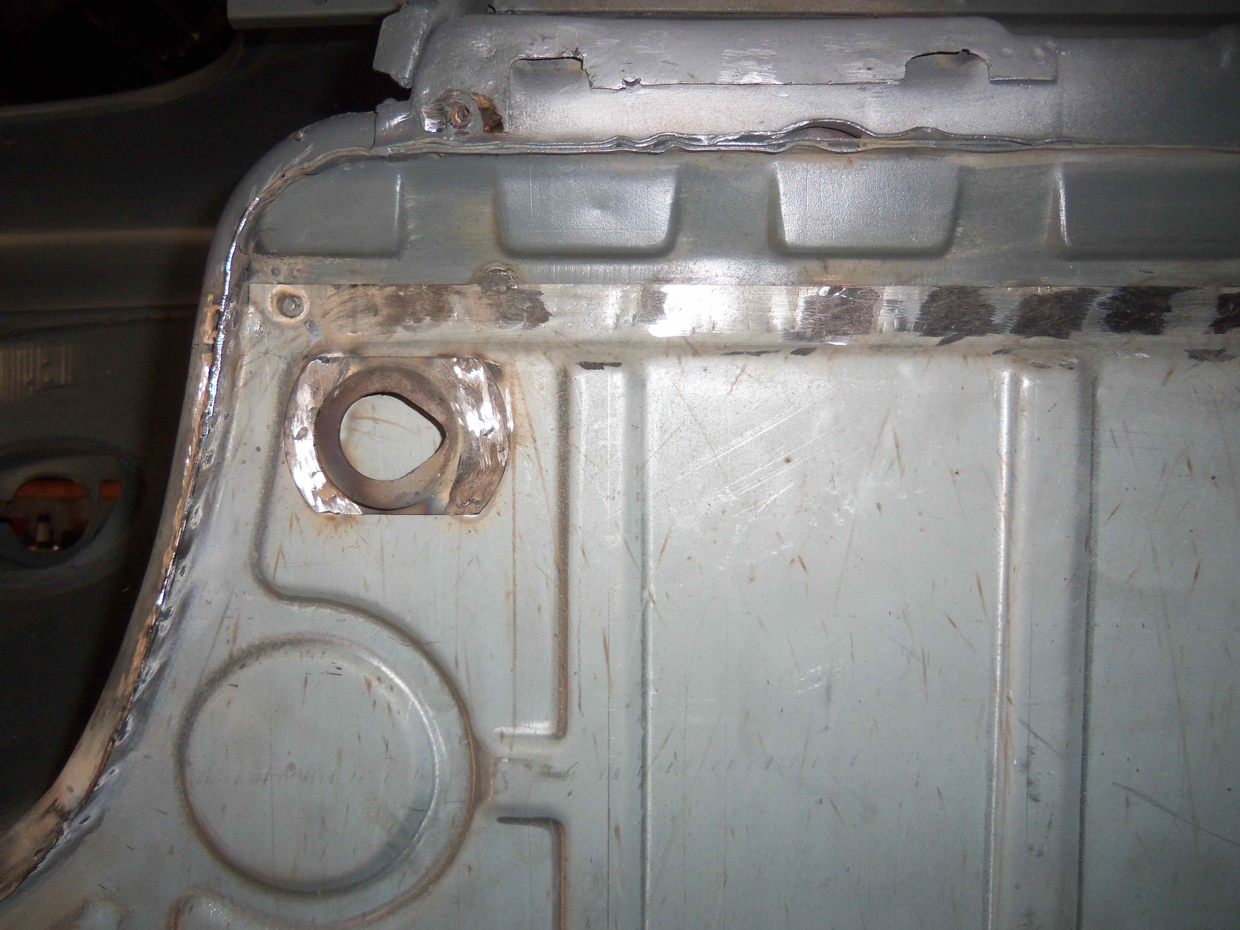

dlee6204   Update: I've been working on a lot of littl...   Feb 23 2012, 08:52 PM
dlee6204   The front trunk floor also has some thin metal wit...   Feb 23 2012, 08:58 PM

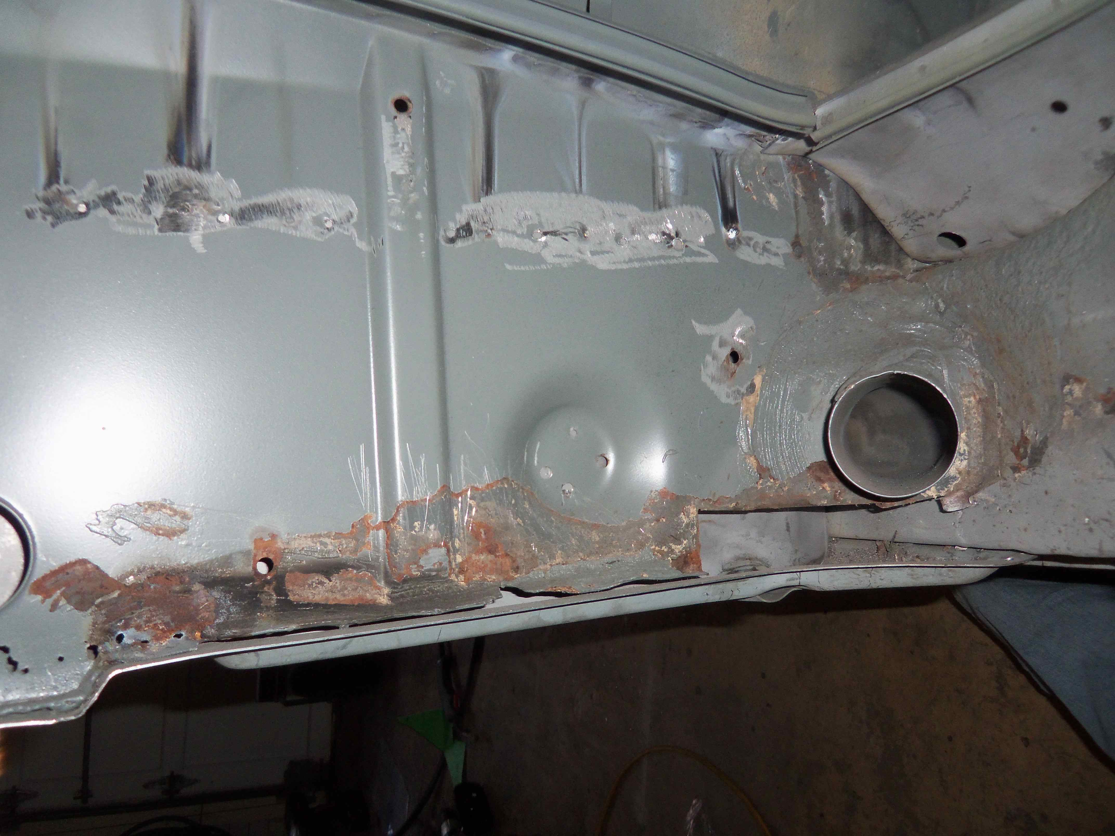

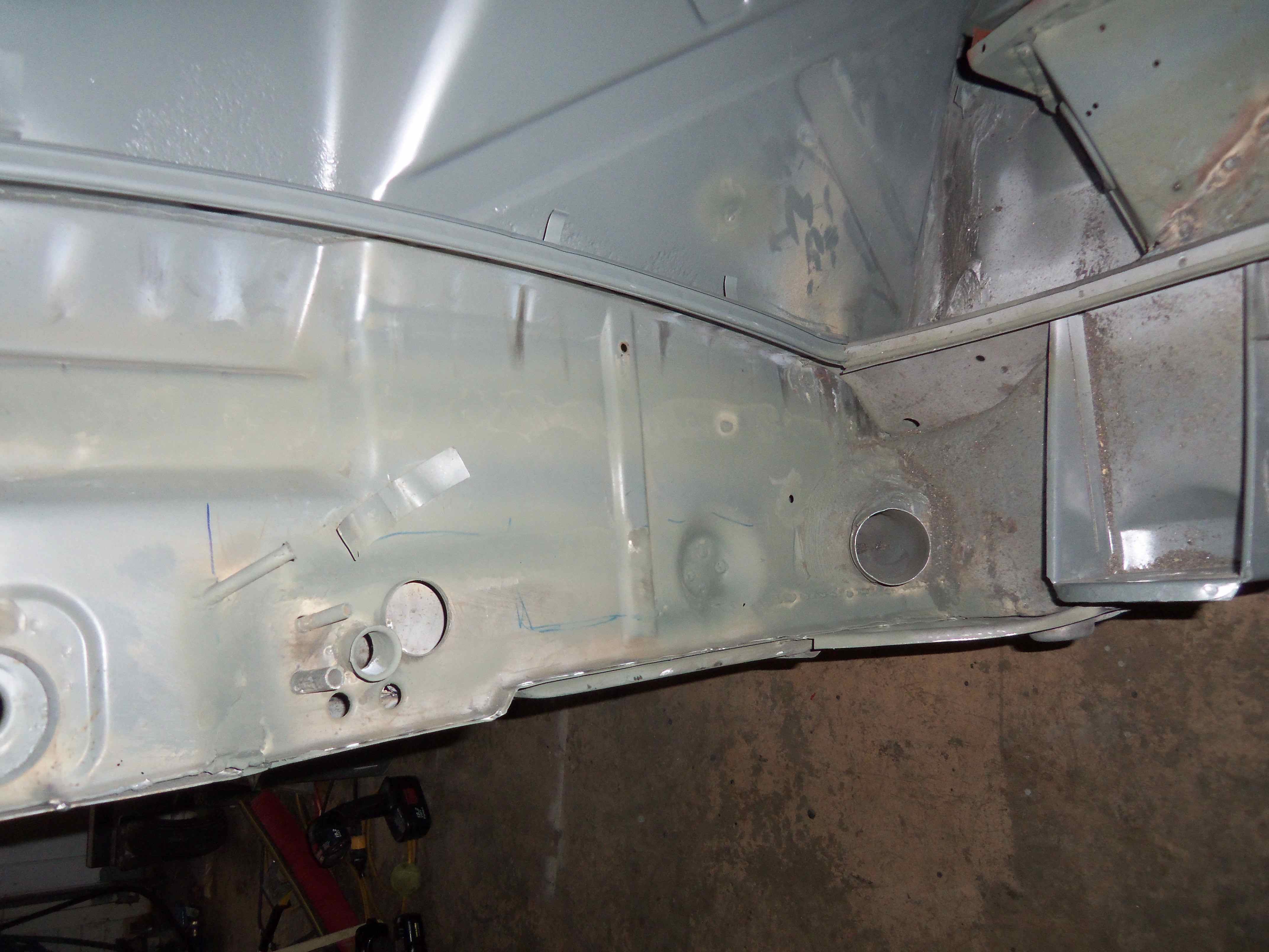

dlee6204   I did some work on the lower firewall too. ...   Feb 23 2012, 09:12 PM
dlee6204   Oh and who says there aren't enough spot welds...   Feb 23 2012, 09:14 PM
993inNC   looks great Doug! Is the rust on the pass lowe...   Feb 24 2012, 04:54 PM
dlee6204   looks great Doug! Is the rust on the pass low...   Feb 24 2012, 09:08 PM
993inNC   Cool, what's the other side look like? Hey BTW...   Feb 24 2012, 10:03 PM
dlee6204   No I keep remembering I need to do that and then...   Feb 24 2012, 10:08 PM
