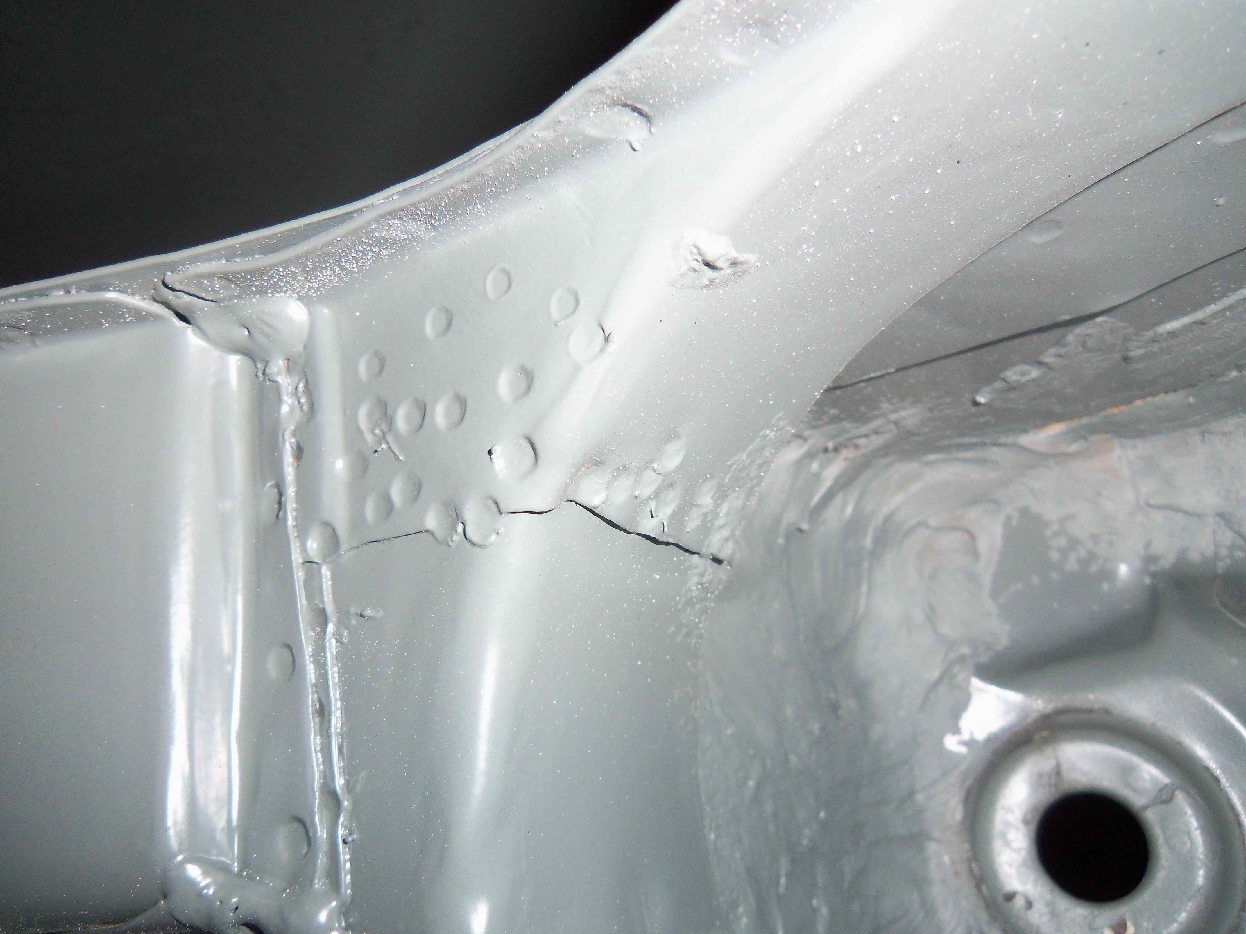

Oh and who says there aren't enough spot welds on a 914... (IMG:style_emoticons/default/blink.gif)

dlee6204   I did some work on the lower firewall too. ...   Feb 23 2012, 09:12 PM
dlee6204   Oh and who says there aren't enough spot welds...   Feb 23 2012, 09:14 PM
