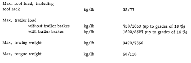

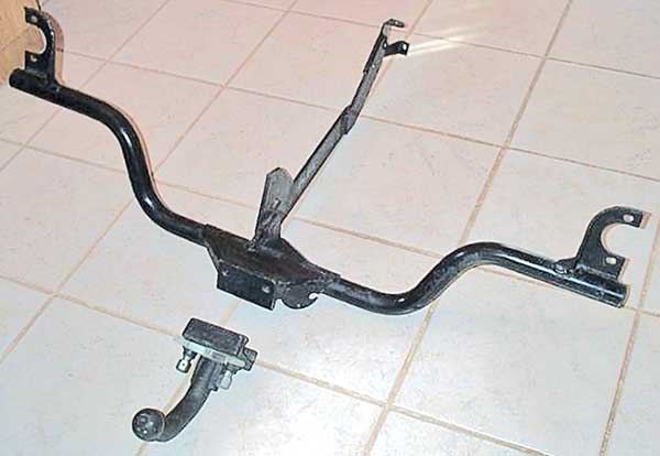

Well for the naysayers, after looking around at some other 928 sites which I googled, I found that PORSCHE themselves provided a FACTORY tow hitch coupler, electrical connections for the trailers, & removable extended side rearview mirrors - among a plethora of roof racks & carrying accessories!
P/N: 928-721-031-02
Owners manual & shop manual lists tow capacities, although the tongue weights are pretty low ....
