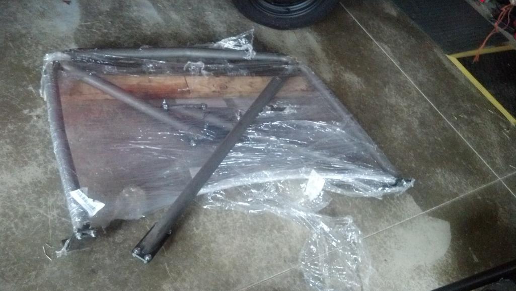

Zimms

UPS stopped by!
(IMG:style_emoticons/default/piratenanner.gif) (IMG:style_emoticons/default/piratenanner.gif) (IMG:style_emoticons/default/piratenanner.gif)

Zimms   UPS stopped by! :Qarl: :Qarl: :Qarl:   Mar 8 2012, 02:21 PM
racerbvd   UPS stopped by! :Qarl: :Qarl: :Qarl: ...   Mar 8 2012, 06:39 PM
Garold Shaffer   UPS stopped by! :Qarl: :Qarl: :Qarl: ...   Mar 9 2012, 09:57 AM
McMark   Looks like they tried to lose one of the down-bars...   Mar 9 2012, 12:06 AM
Zimms   Between the plastic wrap and the ties, it stayed, ...   Mar 9 2012, 08:01 AM
