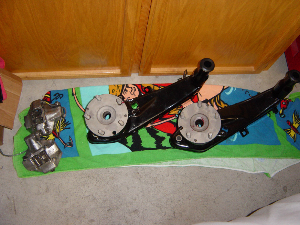

Jeffs9146   Progress has been made.....slow but sure!...   Feb 13 2004, 01:43 PM
echocanyons   So what did it take to pull your hubs, I am quite ...   Feb 13 2004, 01:51 PM
Jeffs9146   I remove the bearing retainer plate, set the arms ...   Feb 13 2004, 02:23 PM
Jeffs9146   Tool #2   Feb 13 2004, 02:24 PM
Jeffs9146   Tool #3   Feb 13 2004, 02:24 PM
Jeffs9146   I realize this is the Mickey Mouse way to do it bu...   Feb 13 2004, 02:27 PM
Jeffs9146   Just in case you are trying to do this while it is...   Feb 13 2004, 02:52 PM

Jeffs9146   OK, I did it all by my self!!!! Fi...   Feb 28 2004, 03:11 PM
