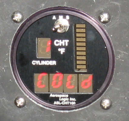

I sell this one
I have the same one in my street car and my race car.
The gauge has several modes of operation. The standard mode automatically cycles through each cylinder so it only takes 4 seconds to see all 4 head temps.
The display shows cylinder, digital temp and a green/yellow/red bar graph for quick reference.
