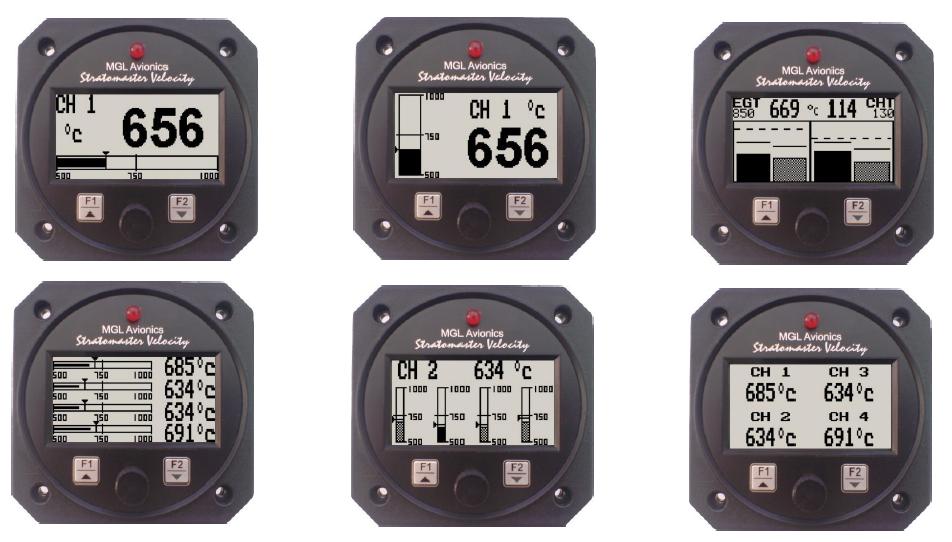

I am learning sooo much from this thread. I have decided one more guage cant hurt (IMG:style_emoticons/default/rolleyes.gif)
While looking at all the 4 channel guages, i found that I really like the idea of seeing all four at the same time and the
MGL AVIONICS TC-2 THERMOCOUPLE TEMPERATURE DISPLAY Guage
seems to be the perfect one, you dont have to view it as a bar graph, if I am understanding the manual, you can read all four as a digital display at the exact same time in real time. look at the last pic of the guage. That is just cool (IMG:style_emoticons/default/beerchug.gif)

(IMG:style_emoticons/default/agree.gif) Very Nice. Besides being able to monitor CHT on all for cylinders, does MS have the ability to tune to four CHT inputs?
Maybe MS 3?
