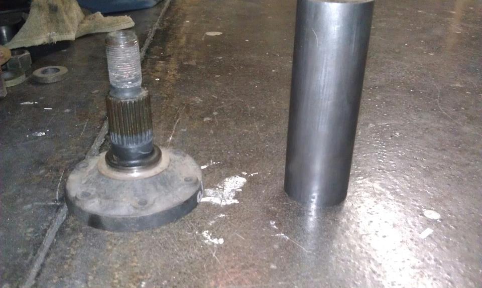

what the heck, a few bucks each I'll run them.
Now, anyone else need 944 stub axle bearing spacers? Got the material, cranking out at least a pair for me....
(IMG:http://www.914world.com/bbs2/uploads_offsite/a6.sphotos.ak.fbcdn.net-219-1331663717.1.jpg)

QUOTE(Aaron Cox @ Mar 13 2012, 01:35 PM) *
Hey Aaron, will these fit the late 911 stub axles also, if so I'll take a pair.
