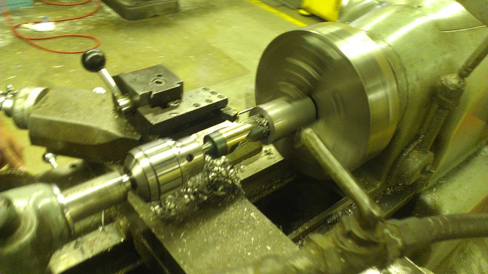

Looks like 6 or so people interested in spacers for 944 stubs (or late 911 hubs).
My machinist pal started on them yesterday, and should be able to get them done next week.
Looking at 25/pair shipped. Pays for beer and materials (IMG:style_emoticons/default/smile.gif)
Steel Stub Spacers.
(IMG:http://www.914world.com/bbs2/uploads_offsite/sphotos.xx.fbcdn.net-219-1331847367.1.jpg)
