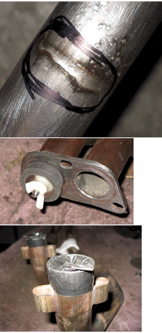

I posted this previously, heating season is here again. These are big cracks, a tiny one you would not be able to hear would still be dangerous. These are not accident damaged. If you have a set on your car, grab the carbon monoxide detector from home and take a ride with the heat on and windows rolled up. There is a detector used in small aircraft also available. The last photo is how we now test for leaks using air pressure. Brad
This post is still relevant today some 15 years since I first posted it. A large number of these early SSI's are still around in parts stashes and yet to be restored 914's. The currently available heats are most likely safe. I have not found anything similar in a stock, even rusty heat exchanger.
STAY SAFE!

my first encounter with a sshe that had a crack in the pipe within the tin area. during my test, one pipe out of four clearly had some air bypass. i cut the tin off and basically the air was escaping thru basically a pin hole along a fissure. as you can see this crack is minor compared to brad's examples. thanks to brad for pointing out the potential for this occurance and his testing proceedure.
here is a link to some info on COHb levels as read by the kiddie night hawk detector shown in a post below.
as you can see, I plug on end and tape around the head end as to have a clean surface to put my mouth on, so I can blow orally to check for leaks, works fine.

mepstein   So just the shell is stainless?   Oct 6 2011, 06:43 AM
914ltd   So just the shell is stainless? Jim The whole h...   Oct 6 2011, 09:04 AM
SLITS   So just the shell is stainless? Jim The whole ...   Oct 6 2011, 09:14 AM
rick 918-S   Thanks Brad! I have seen a set like that. Just...   Oct 6 2011, 06:50 AM
jimkelly   i believe the pipes are stainless too - a magnet s...   Oct 6 2011, 06:51 AM
914ltd   i believe the pipes are stainless too - a magnet ...   Oct 6 2011, 09:22 AM
wingnut86   Just assuming here, but is the washer/rubber dongl...   Oct 6 2011, 07:27 AM
rick 918-S   Just assuming here, but is the washer/rubber dong...   Oct 6 2011, 07:40 AM
VRROOMM1   Just assuming here, but is the washer/rubber dong...   Oct 6 2011, 07:42 AM
76-914   Just assuming here, but is the washer/rubber dong...   Oct 6 2011, 07:47 AM
