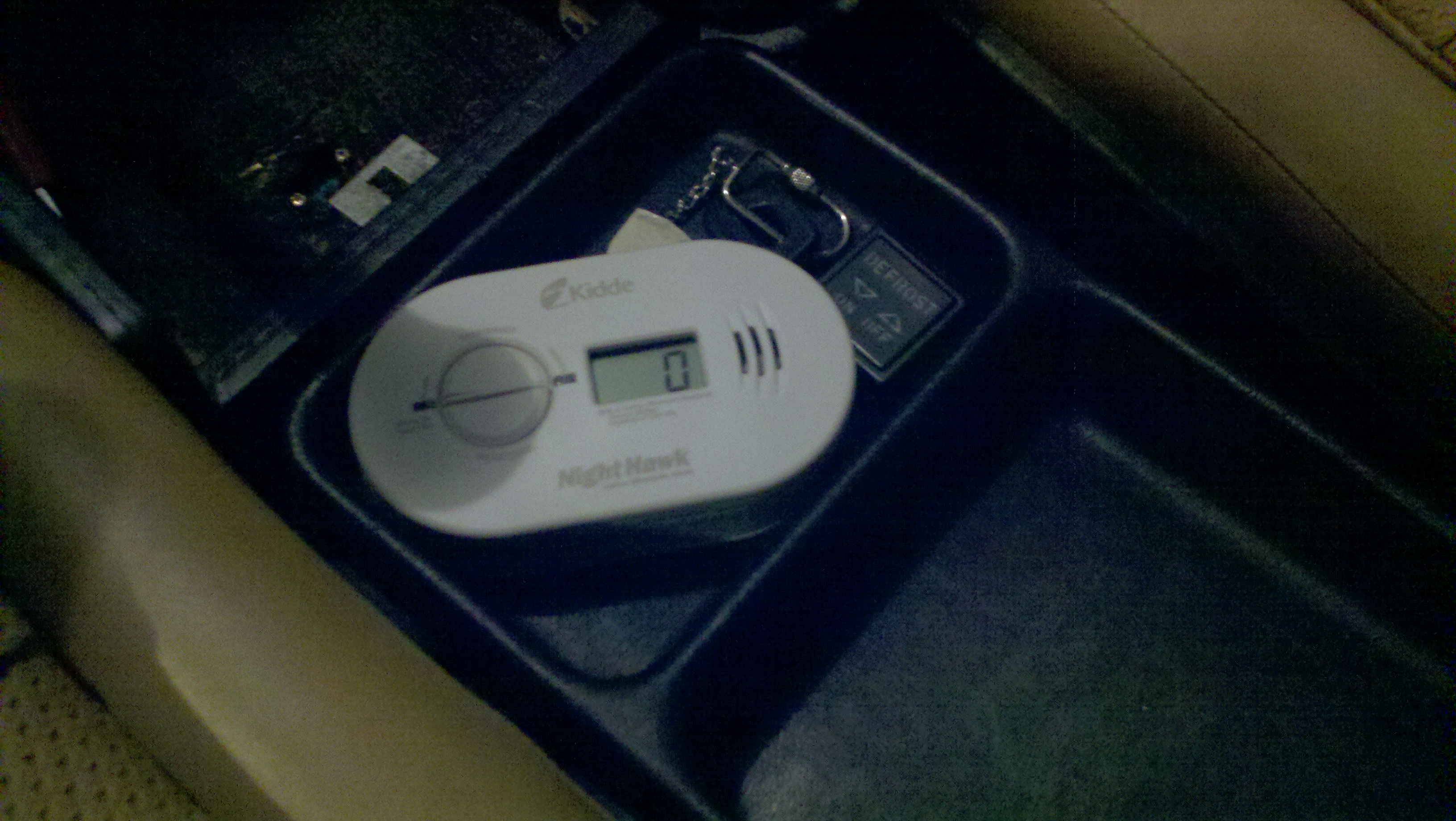

Thanks to Brad and this thread, I don't drive with the roof on without this. It has registered as high as 33 PPM while I have been out on drives. Not much, but not zero either.
$28 at Home Depot = cheap insurance.

bigkensteele   I picked this up at HD Racing today. $28 is ...   Nov 18 2011, 07:00 PM
