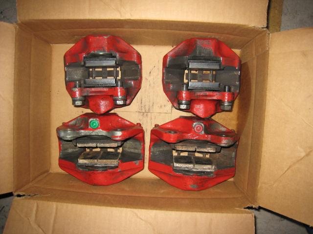

The idea was simple, get rid of the Carrera Calipers and mount Boxster Calipers all around using the mounting adapters from Rich Johnson.

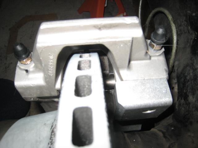

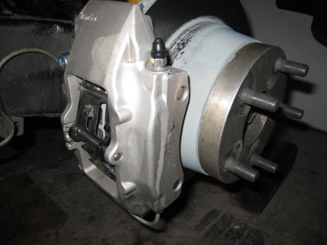

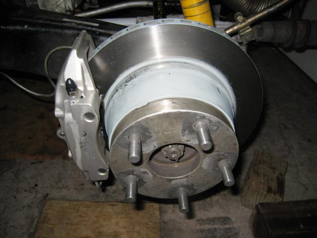

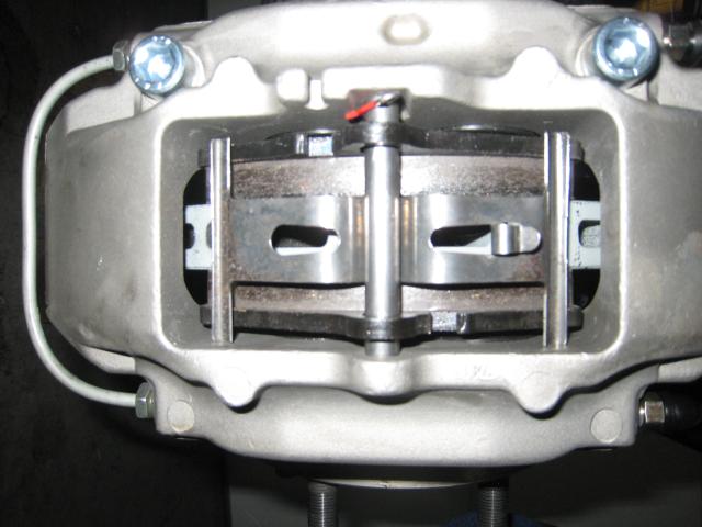

Well, i have 24mm Carrera rear rotors. The Boxster Calipers had to be machined (2mm off each of the brake pad pins) and the adapters had to be milled to center the Boxster Calipers over the wider rotors.

In the rear, i used banjo fittings on the Calipers (Thanks to Eric Shea for those!) and the rear brakelines were no problem.
