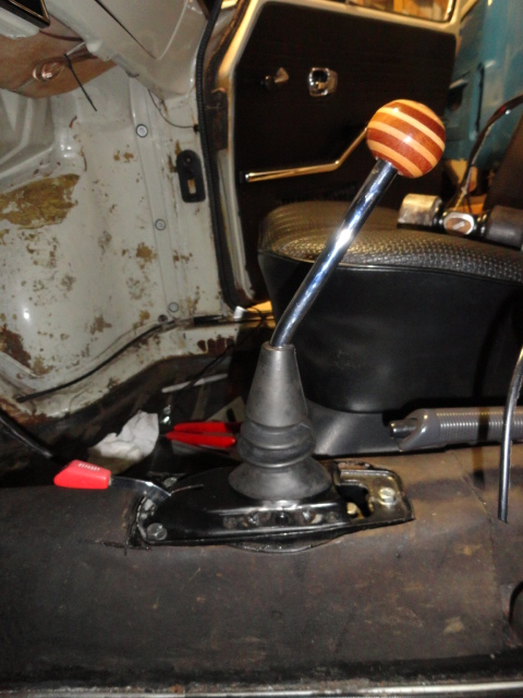

Phase-3 - Convert the rear suspension to the later style IRS and install a Porsche 923 trans out of a Porsche 912E. The rear suspension is DONE!! While at it, I upgraded it with 914 rear brakes, urethane bushings, adjustable spring plates and a rear sway bar. (IMG:style_emoticons/default/driving.gif)
(IMG:http://www.914world.com/bbs2/uploads_offsite/images.thesamba.com-9730-1324689632.4.jpg)
Since the trans is taller than a stock 4-speed and cutting into the car can't happen due to rear seat issues. I gained the 1.5" I needed by spacing the body off the rear suspension with spacers. So here I sit, on the final leg of phase-3. I now need to couple the motor/trans and lift it into it's final place and fab rear engine hanger mounts for the rear bar. It's late and I'm tired. . .

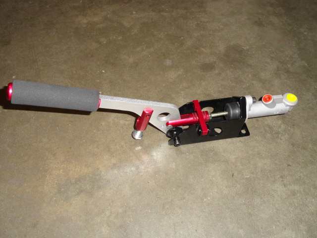

I made one change to the brakes. I had planned on running stock 914 calipers in the back so as to retain my stock e-brake. The issue I had was the cable routing since my brake calipers had to be on the rear of the trailing arm, the cables would end up being very close to the axles/CVs. So I traded them out for 912E calipers that I had. Fit like a glove!! But now i don't have en e-brake. Perusing eBay I came across a really simple hydraulic e-brake set-up used by drift cars guys. . . I pulled the trigger on it and now I'm going to have an fully functional hydraulic e-brake!! (IMG:style_emoticons/default/biggrin.gif)
(IMG:http://www.914world.com/bbs2/uploads_offsite/images.thesamba.com-9730-1332260241.1.jpg)

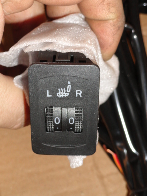

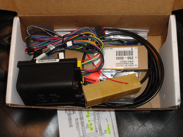

I've also made a few purchases that will add to the creature comforts. Updating this older car with modern car amenities is also a goal of the project. I've never owned an air-cooled car with cruise control, so I picked-up a Dakota Digital fully digital cruise system. It uses no vacuum off the motor, and I'll be able to stuff the module under my rear seat (like every other bit of electronics). Every day, I pass through several highly patrolled speed traps so I'm looking forward to the added piece of mind cruise control provides (especially with a car that really moves).
(IMG:http://www.914world.com/bbs2/uploads_offsite/images.thesamba.com-9730-1332260242.2.jpg)

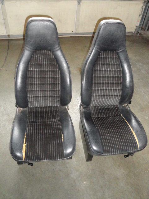

I also picked-up a pair of mid-70s/early 80s Porsche 911 seats off Craigslist super cheap. While I'm not a fan of high-backs, they are a lot safer. They also have bolstering top and bottom so I won't be sliding off the seat while cornering like I do in the stock, flat, low-backs. I'm having these recovered in black vinyl w/ stock black VW basket weave in the centers. Before the covers go on though, I also opted for seat heaters for both seats. I've never had a car with that option, so I figured, what the hell!! 8)
(IMG:http://www.914world.com/bbs2/uploads_offsite/images.thesamba.com-9730-1332260243.4.jpg)
(IMG:http://www.914world.com/bbs2/uploads_offsite/images.thesamba.com-9730-1332260244.5.jpg)
