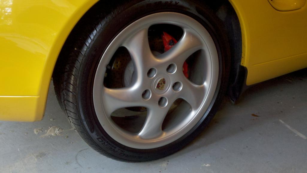

The idea was simple, get rid of the Carrera Calipers and mount Boxster Calipers all around using the mounting adapters from Rich Johnson.
Of course, nothing ever goes as planned: (IMG:style_emoticons/default/headbang.gif)
First, i failed to read Rich's instructions that clearly state that you have to use a 20mm 911 SC rear rotor.
Well, i have 24mm Carrera rear rotors. The Boxster Calipers had to be machined (2mm off each of the brake pad pins) and the adapters had to be milled to center the Boxster Calipers over the wider rotors.
(IMG:style_emoticons/default/smash.gif)
Then, after everything was bolted together, i recalled reading that the hard brake lines may not be long enough.
And sure enough (of course) the front brake lines were about 1" too short. Arrghhh.
(IMG:style_emoticons/default/rolleyes.gif)
McMark came to the rescue and we made two new lines. (IMG:style_emoticons/default/thumb3d.gif)
In the rear, i used banjo fittings on the Calipers (Thanks to Eric Shea for those!) and the rear brakelines were no problem.
Mark and i then bled the brakes. I was still getting some air in the front, but it was already 9pm so we decided to call it a night and i drove it home (40+ miles). The brakes actually felt fine, they seem to work great.
I'll go back to the OC shop next weekend and we'll bleed them again.

i have boxster S calipers too. (IMG:style_emoticons/default/poke.gif)
i would love to do this to my 914 too, the boxster is 50% heavier than the teener and stops on a dime- this is going to be great on the track with your teener! (IMG:style_emoticons/default/beerchug.gif)
i dont have a track car, so would be overkill i think for my 2.0, but maybe the
BMW upgrade might be worth it? what do you advise- i am on a 4 lug ...
