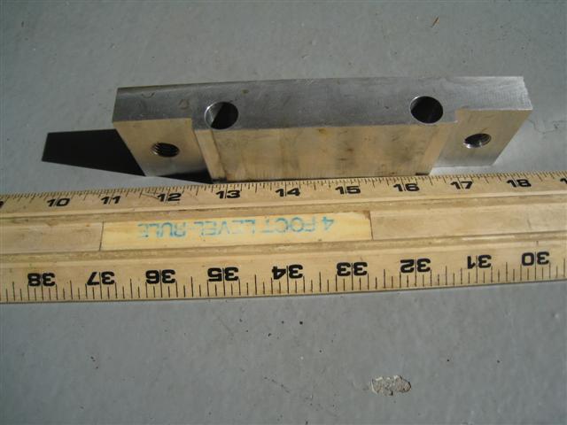

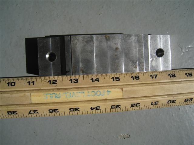

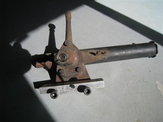

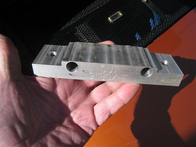

Her ya' go... (IMG:style_emoticons/default/smile.gif) I'm not sure the pic where the adapter is mounted is oriented correctly...

jim_hoyland   Her ya' go... :) I'm not sure the pic wher...   Mar 20 2012, 04:35 PM
Aaron Cox   Wow, Jim. Those look scary thin at the corners o...   Mar 20 2012, 06:12 PM
SirAndy   Wow, Jim. Those look scary thin at the corners of...   Mar 21 2012, 11:08 AM
